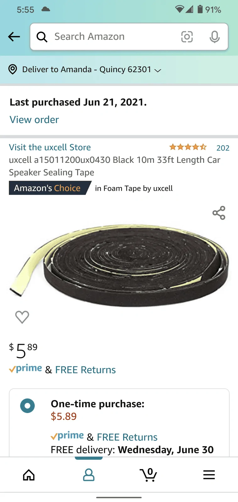

For what it's worth, I ran into a complication with the Metra pods for the knee speakers. After installing, the passenger side sounded pretty good (with the 6.5" Kickers) - rich, good base response, no rattling, but the driver's side was crap. A noticeable lack in base response, and rattling/airy noises. As best as I can tell, the pod itself had a manufacturing defect and the unit was not sealed well (it's actually two pieces, not a solid piece). Awaiting for a replacement to arrive tomorrow or Tuesday, and hoping that solves the issue.
I put a seal with electrical tape around the edge of the hole where the speaker lays. Helps to seat the speaker.
