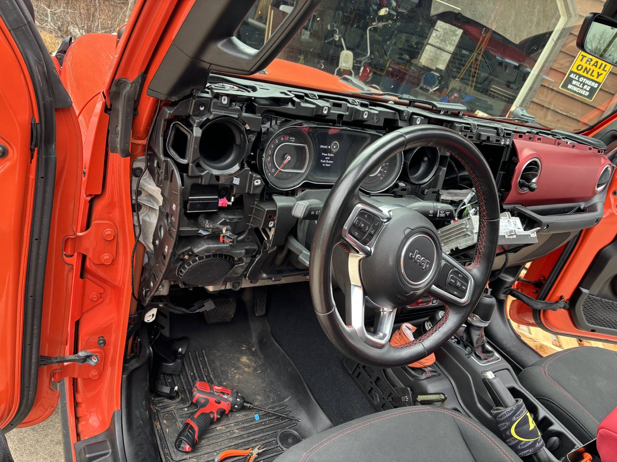

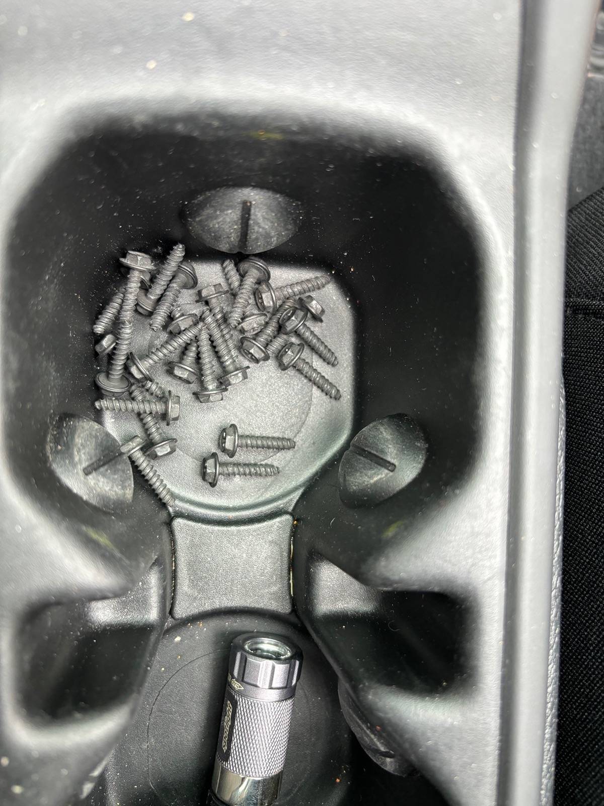

Did this last weekend. Ex installer (20 yrs ago) Surprised by how much had to be taken apart to get to the speakers.
the Trail Seven YT video was a huge help and I referenced it often. Took about 3 beers. Take your time and don’t rush.
I used it as an opportunity to clean hard to reach places.
i remember thinking GM used way too many fasteners.…
I ”think” I hear a difference with a little more mid but who knows. I did it because I received the whole kit as a gift and the knees were the last pieces. I simply got tired of moving them around in the garage.

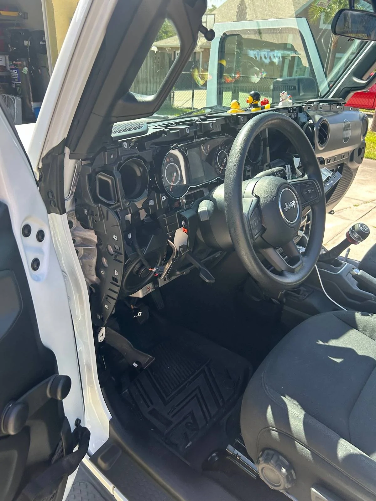

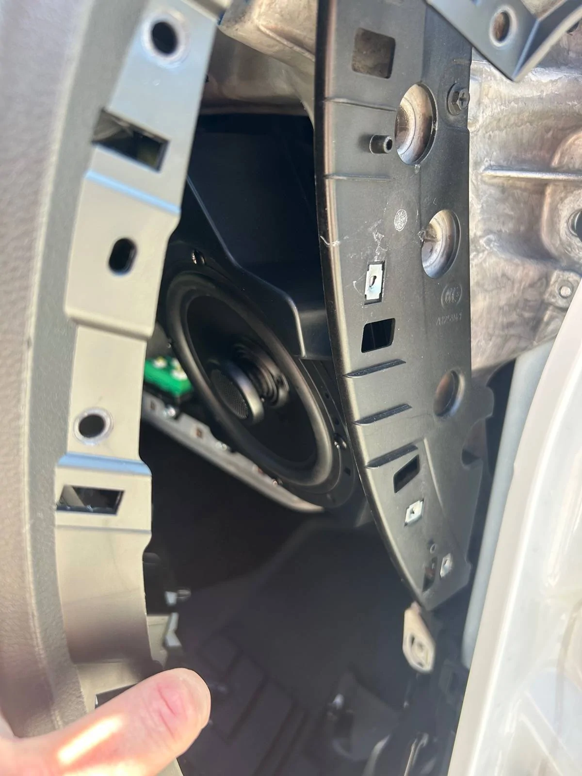

I finally got around to installing knee panel speakers. Over all it sounds a bit snappier in the mid range bass and took less than 2 hours. Took my time with it and over all smooth just tedious work.

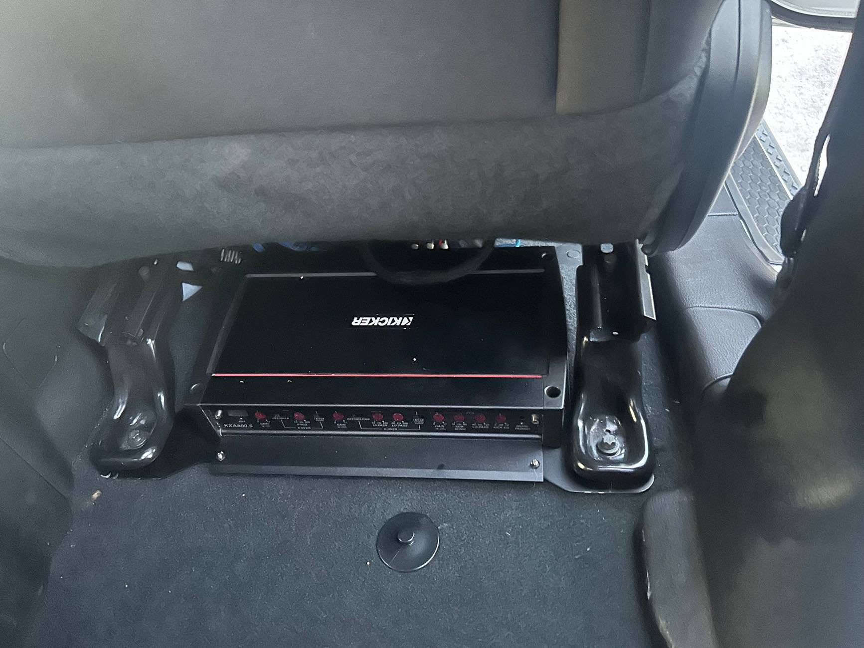

i agree there was little to no difference until I added a amp to them. Definitely hear an improvement. The problem is the oem radio only puts out like 5 watts per speaker. These upgraded speakers require more power inorder to hear a difference.
