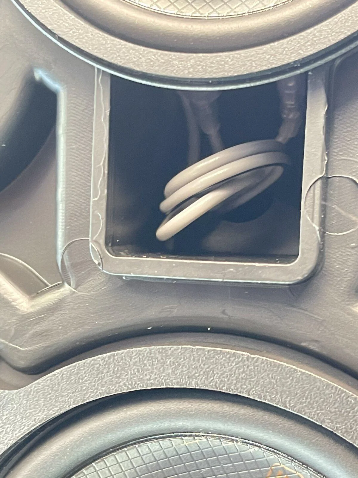

Did you run into any figment issues with the 3.5” in the toll bar? I can’t get mines to fit. With or without the crossover. Did you have to cut?
I put the 3.5" crossover in the 4" speaker section, as there is a little nook where it can sit out of the way of the 4" speaker. Then I just ran the wire through the existing hole. No cutting, but it's definitely not a great fit. The speaker terminal panel gets a little bent once you tighten everything down unfortunately, but still works.
I’m sorry to keep pestering you. But where’s the while you ran the wire through?
found it. Lol. Thanks again brother if you’re ever in Miami drinks are on me.

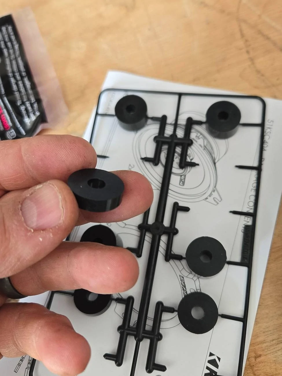

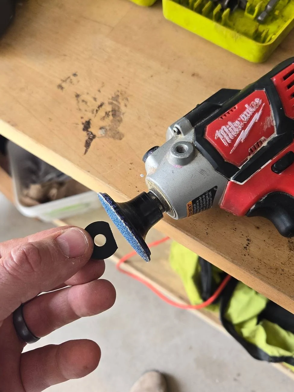

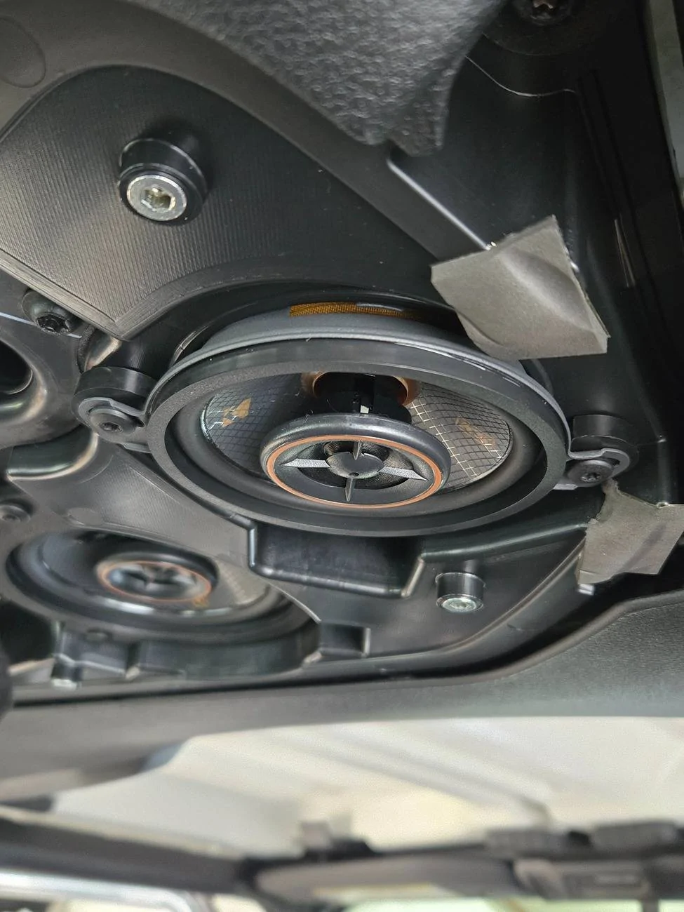

Ok. I can kind of jam the 3.5” in the sound bar if I use the harness with no crossover. Are you guys running the 3.5” with or without the supplied crossover?
thanks!!
This is what I did with the ksc350s in the roll bar. This is the about the cleanest way you can do it. Its going to be covered anyway. The speaker sticks out about 1/4 inch , so get 1/4 inch plastic washers . I had to file off just a little bit, and sits in there now just fine .
