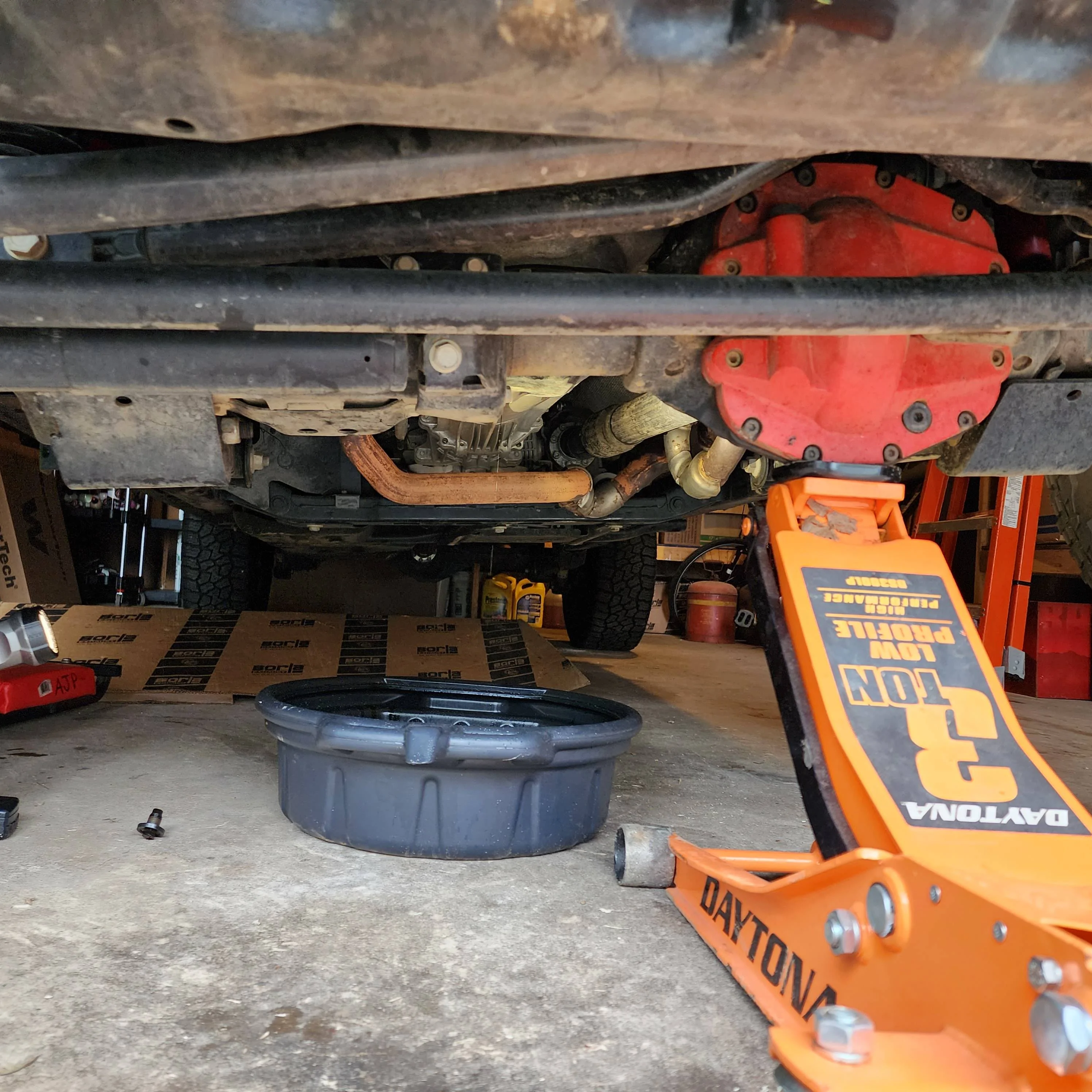

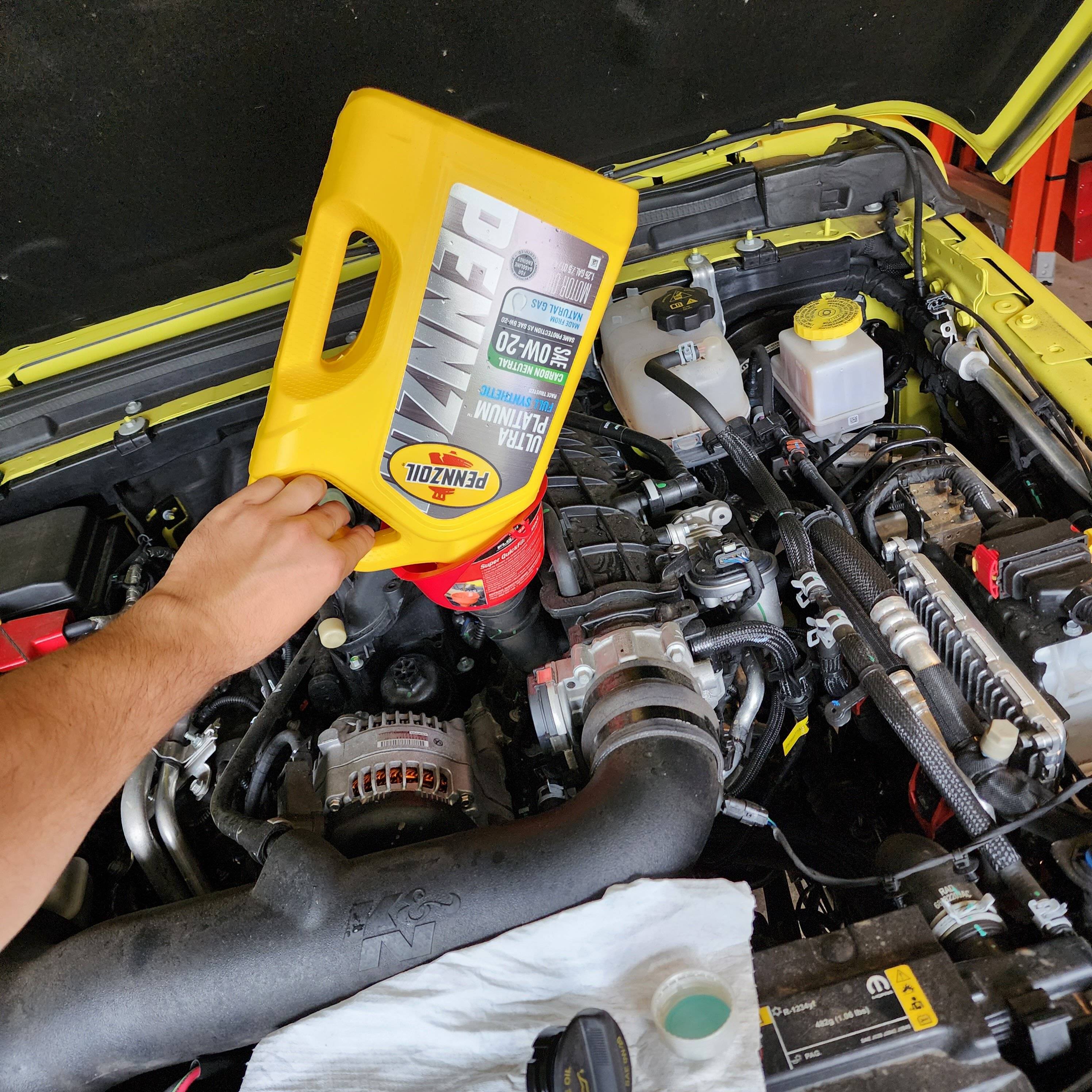

Oil change in the new garage. Old oil was dark but no debris in it thst was noticeable. I shine a high power led into the drain pan as I transfer to the disposal jug. No glitter that I could notice. Filter had a flake on it, tiny. Could have just been a casting piece, was not concerned.

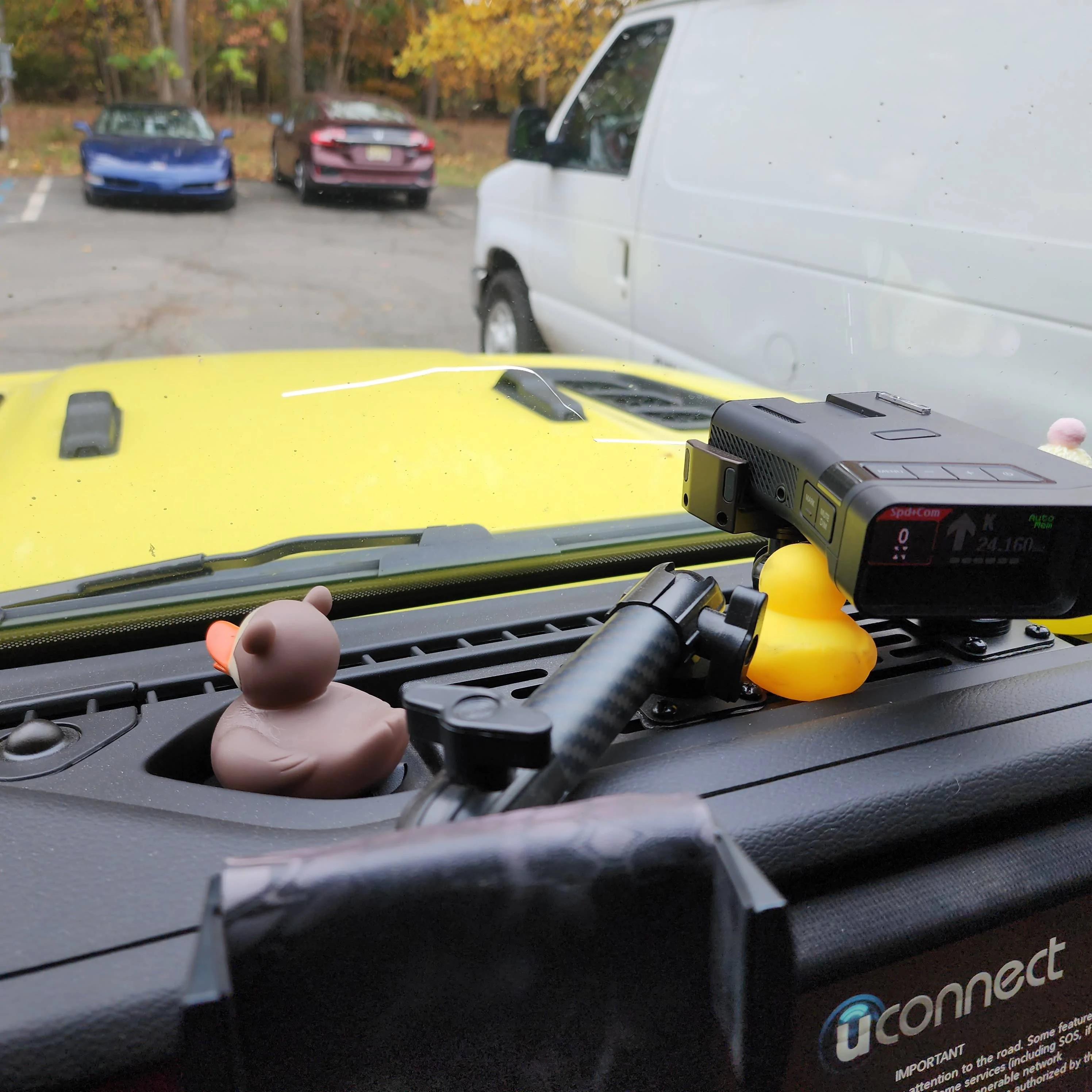

Well, I'm officially a Jeeper. Crack is a few inches past the brown duck at this point. Will get it replaced at some point.

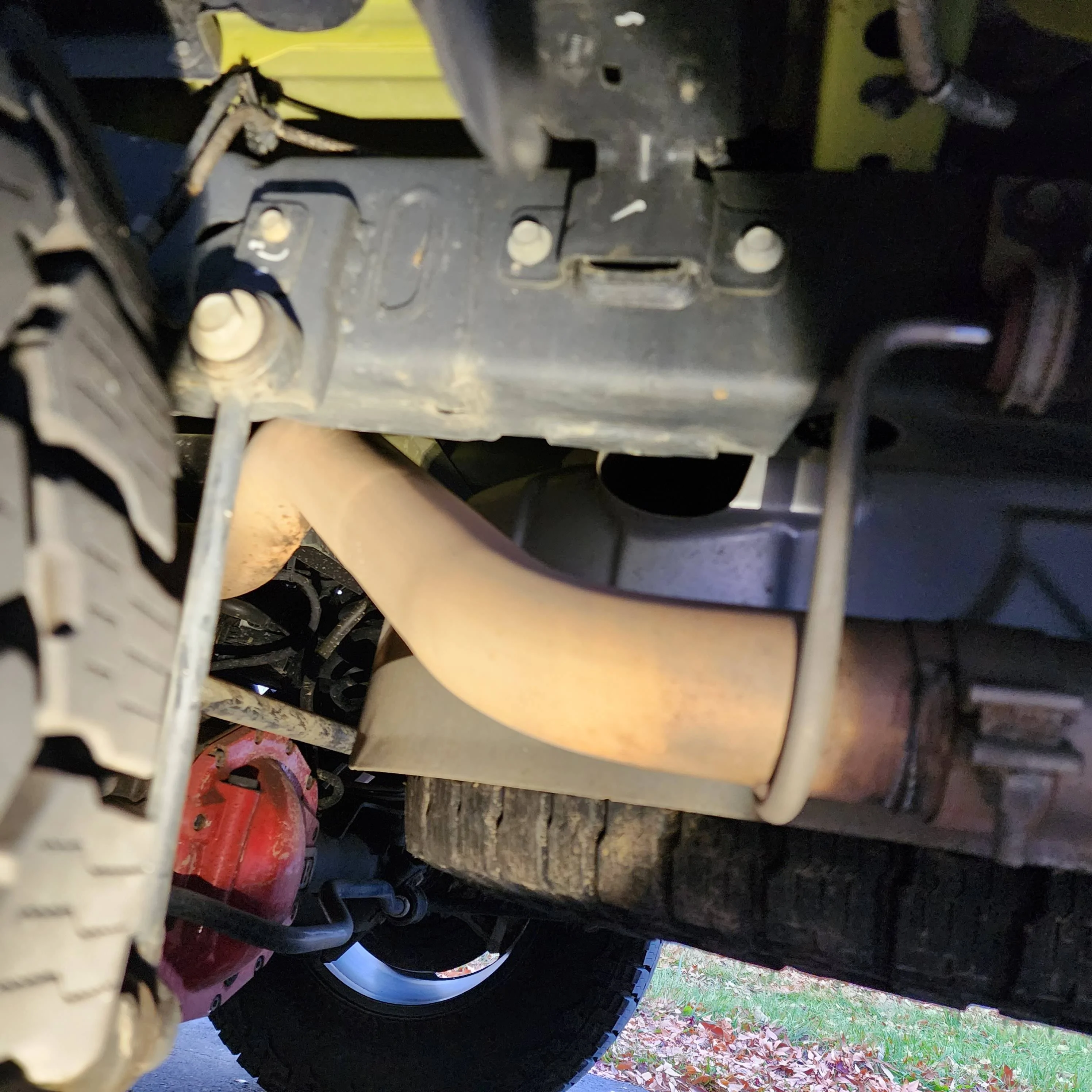

Also, I bought these.
https://metalcloak.com/jt-gladiator-rear-sway-bar-reinforcement-bracket.html
It's a pretty common issue, so I figured it's be an easy install and some preventative means.

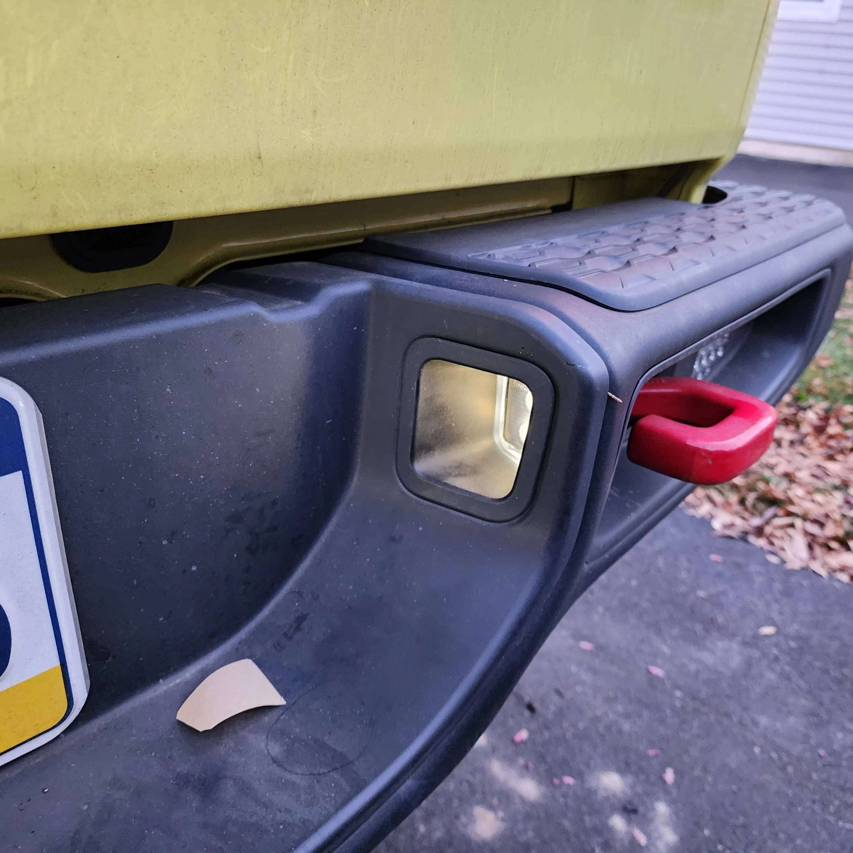

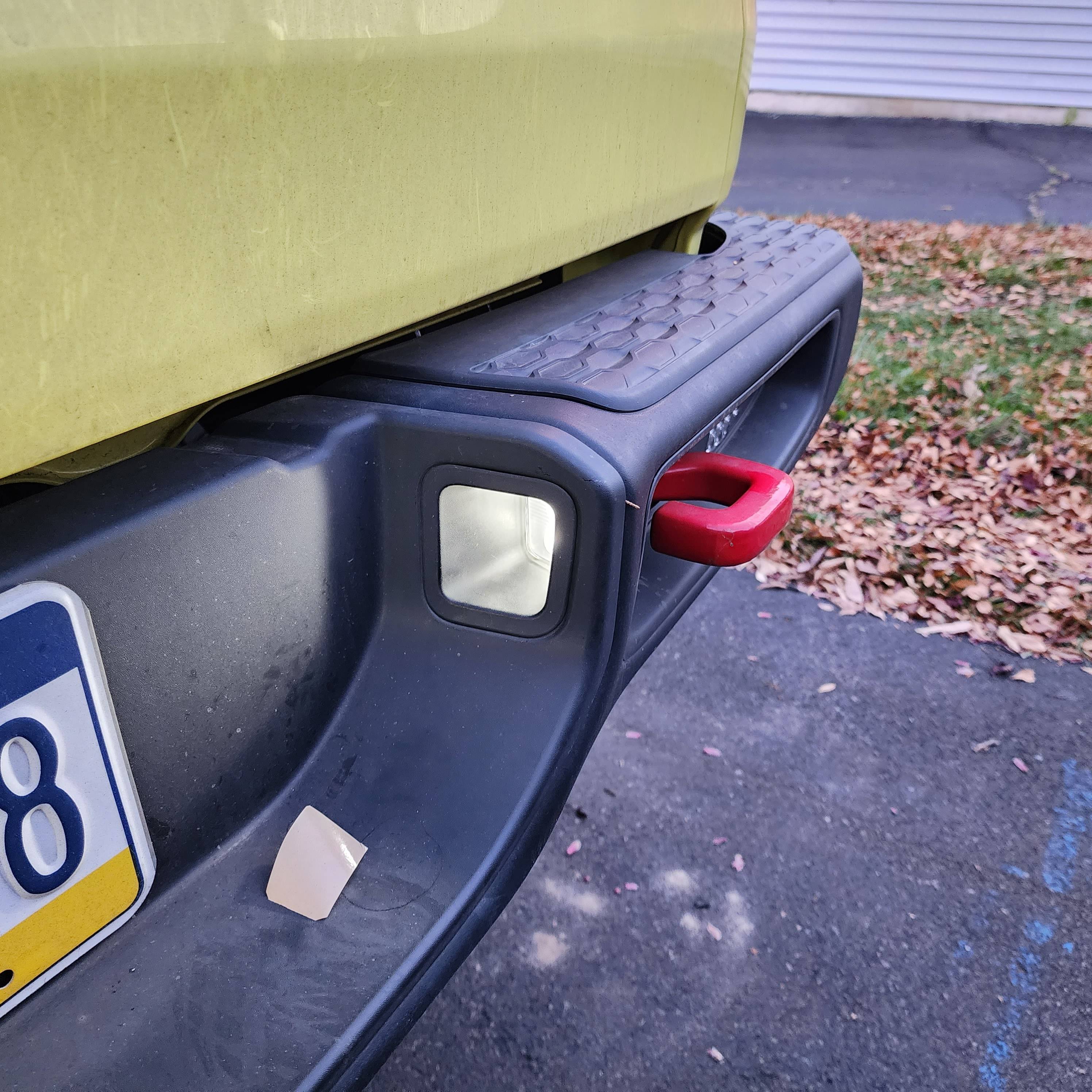

Finally tinted the license plate lamps.
Bought a tiny sheet of Lamin-x, cut to fit, cleaned lens and installed.
I'll see in the morn if its that sweet spot.
Initial impressions, it took the edge off for sure. Reverse camera view is much better.

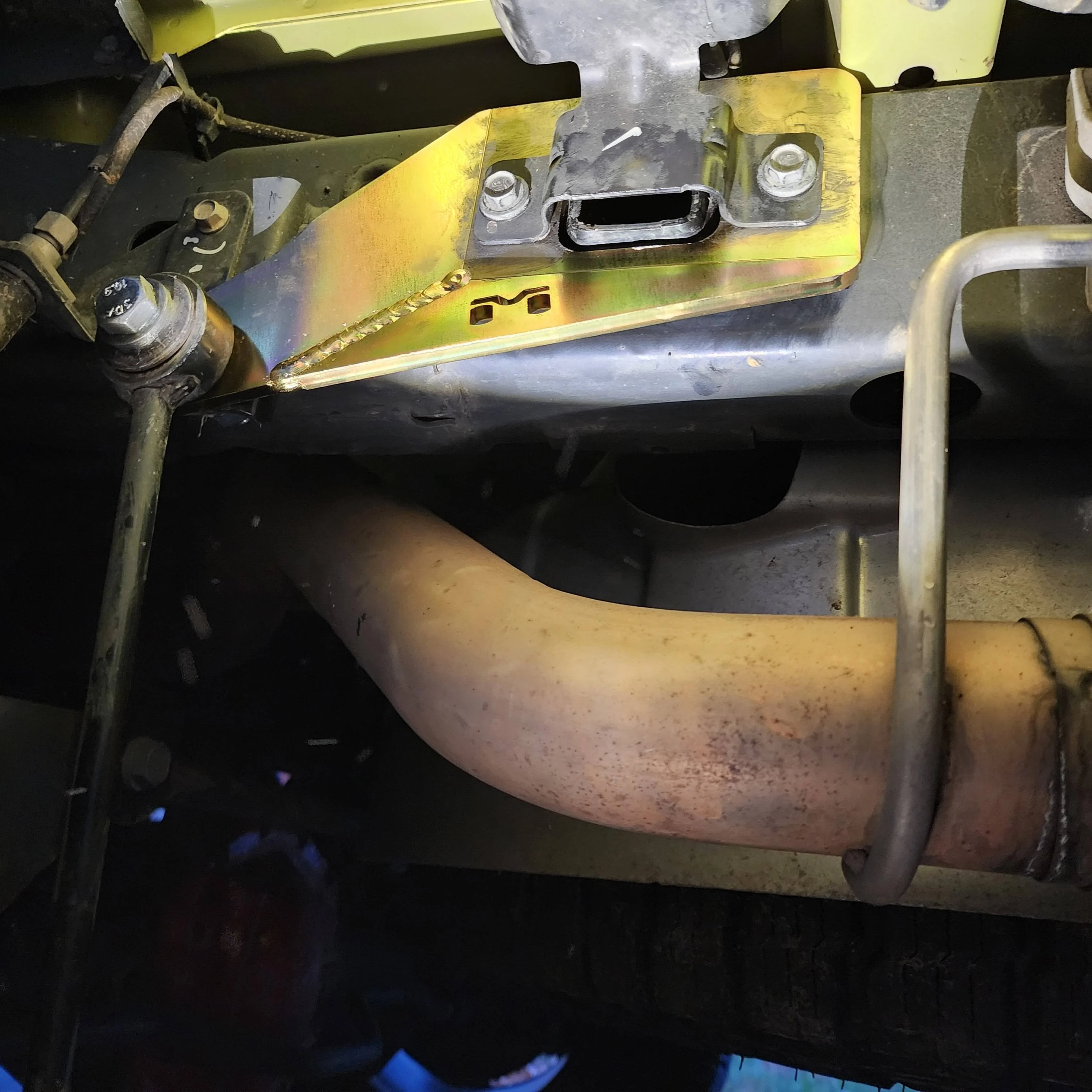

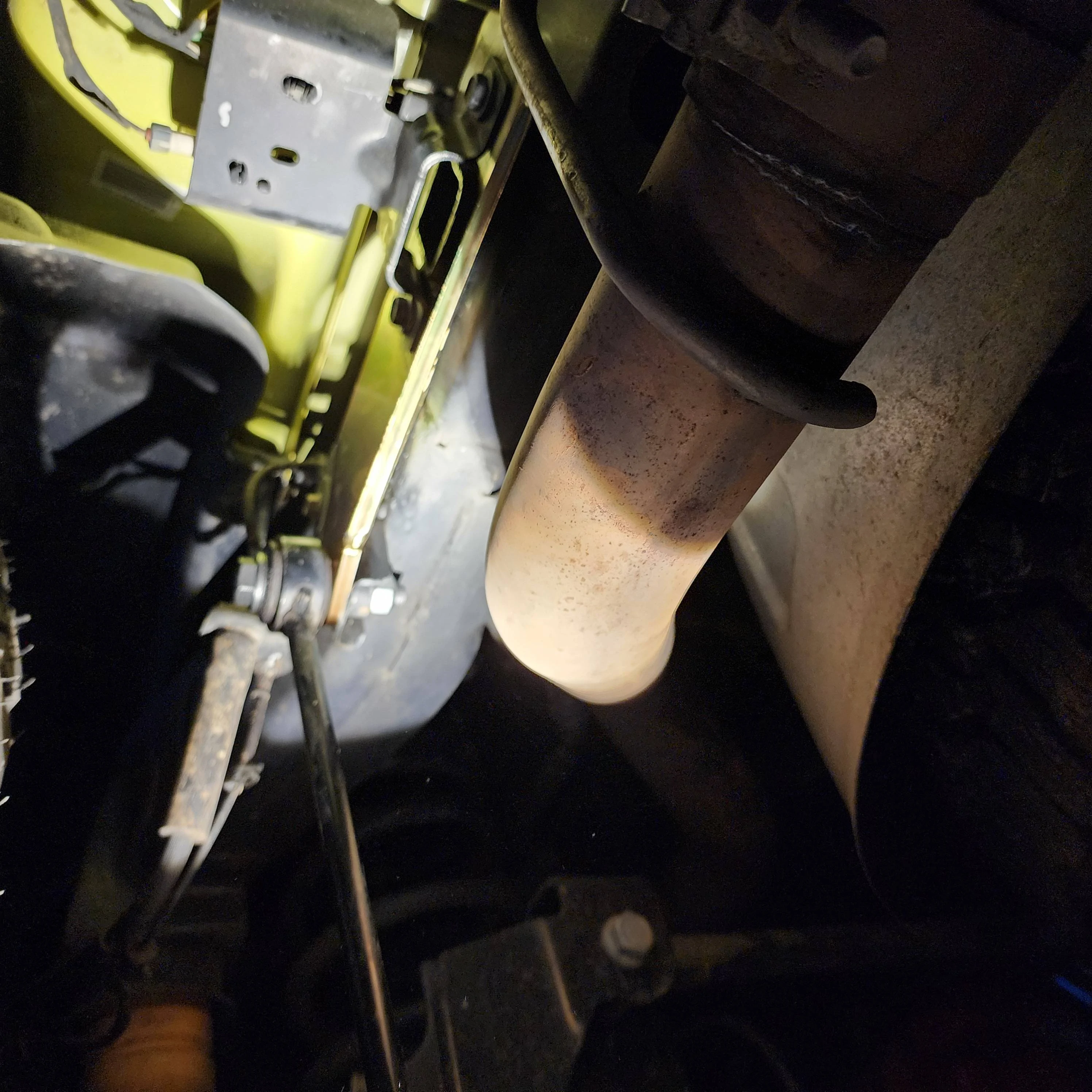

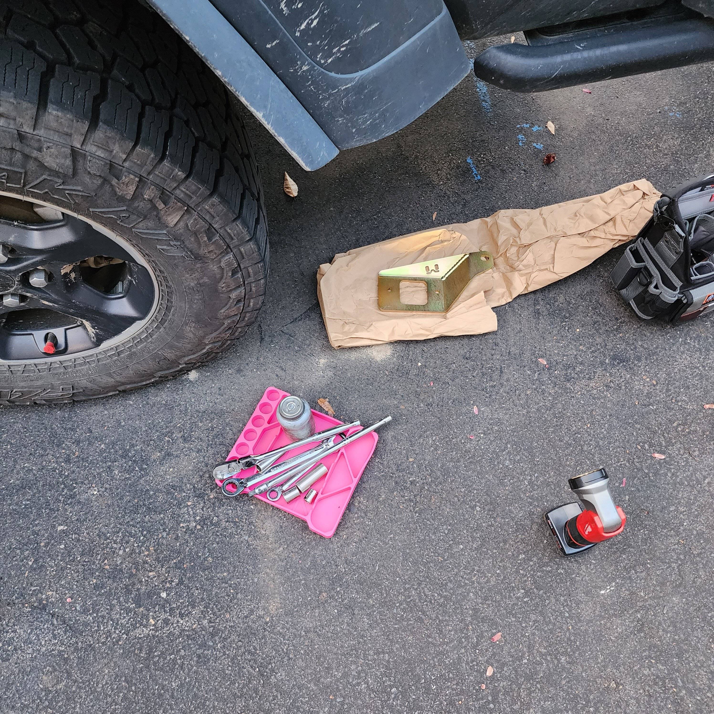

Installed the Metalcloak rear swaybar mount brackets.
81 ft/lbs for the upper swaybar endlink bolt if my research was correct, lol
