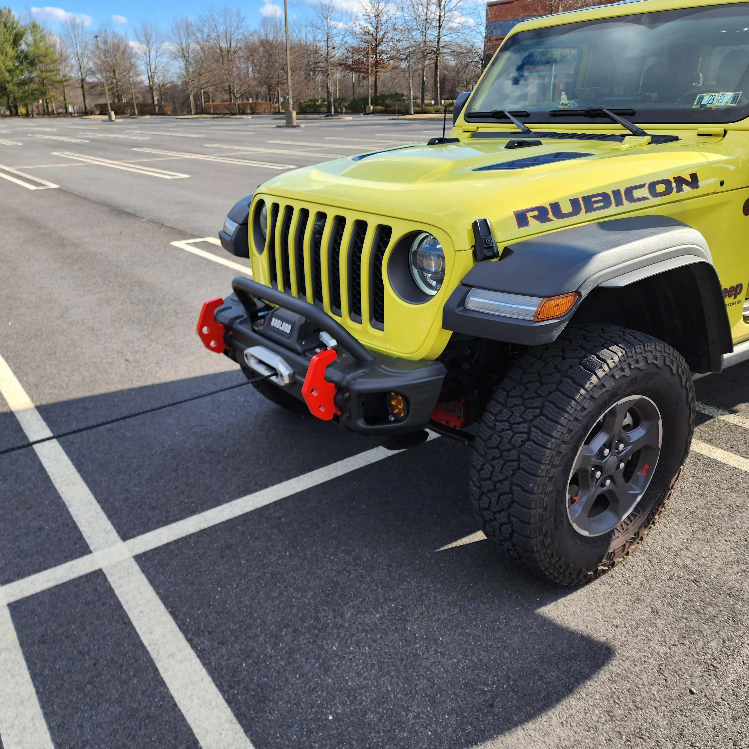

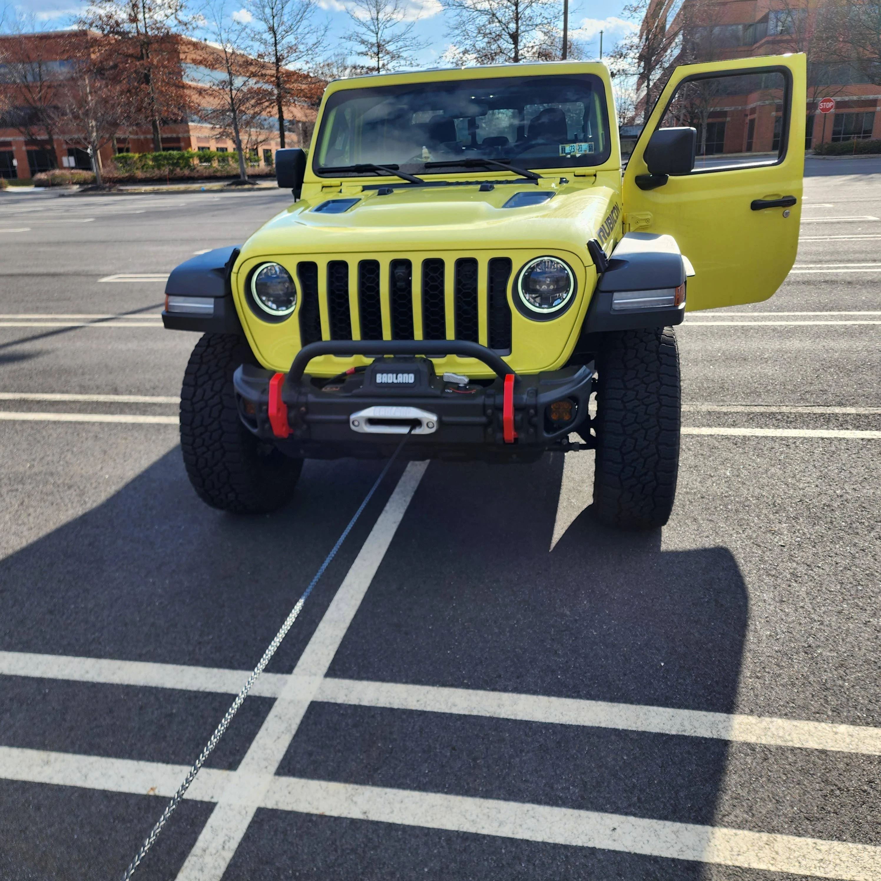

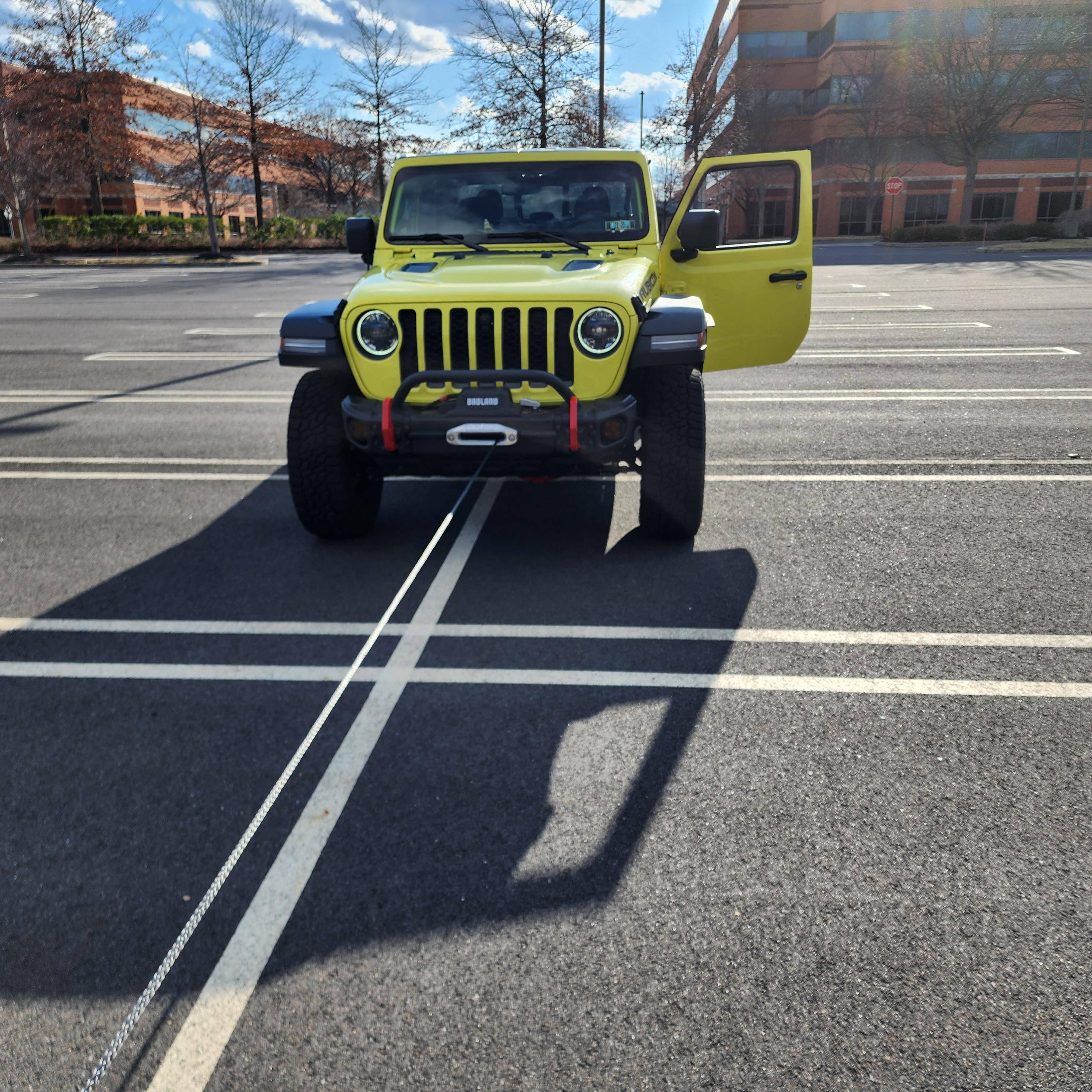

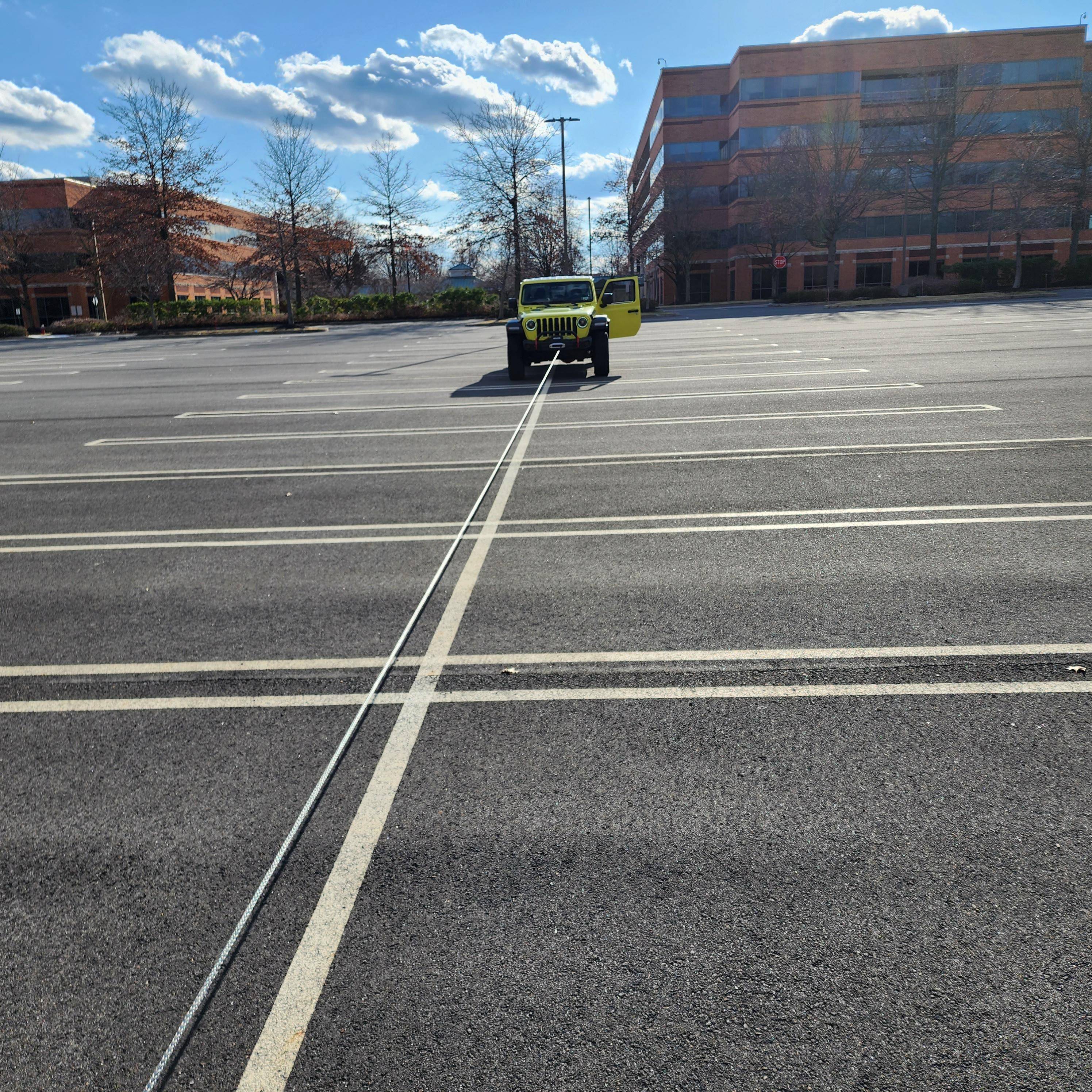

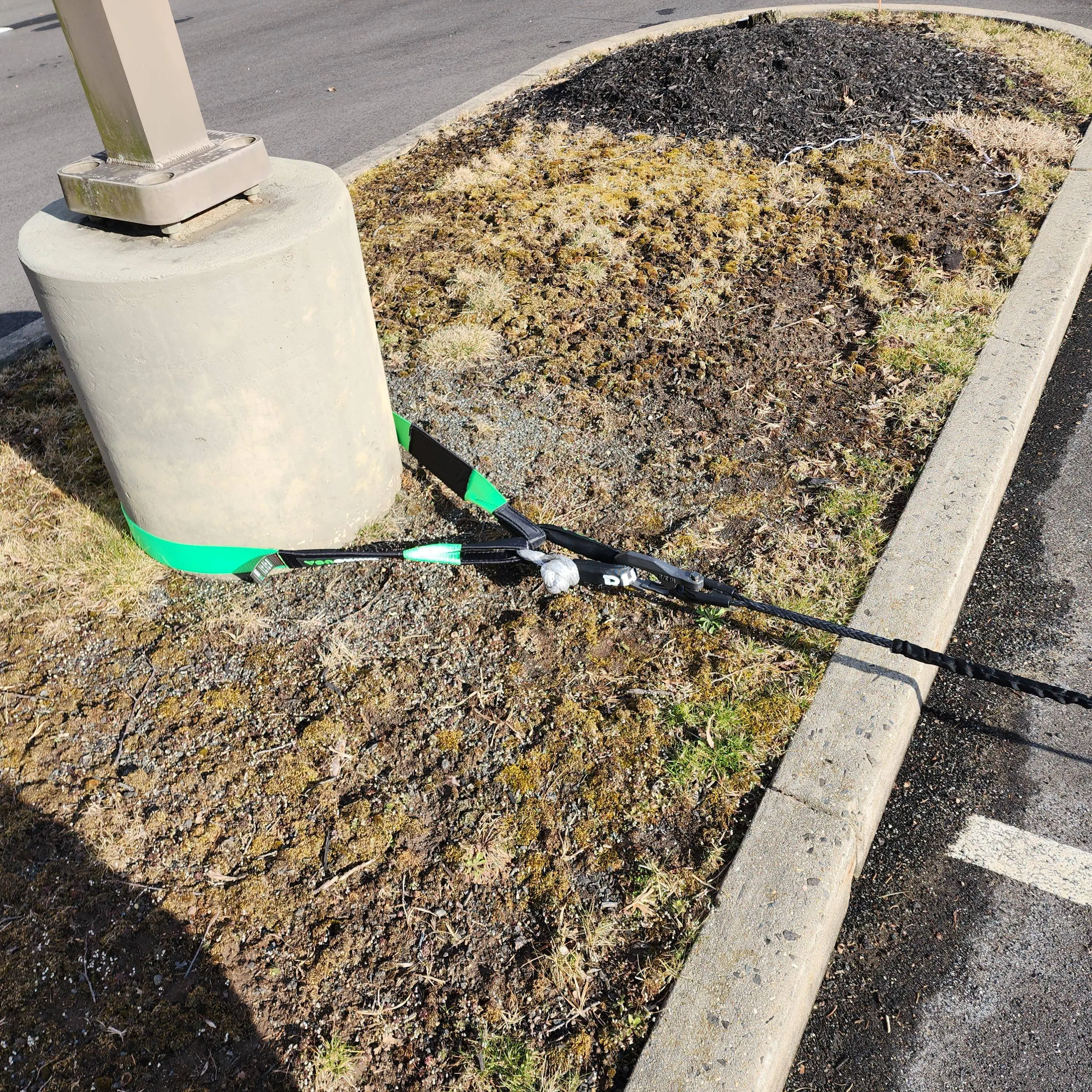

Hooked up some recovery gear, did the first tension on the winch.
About 5 clicks on the Ebrake, and started running it about 4 wraps into the first layer. I'm used to running tuggers and managing rope on a capstan. So I just guided the rope as I wound it up. Heck, I even whipped my winch blanket on the line, lmfao!!!
It was fun. I can't wait actually test it out on a big pull.
Oh, and I bought 60mm long Stainless steel 12pt ARP hardware. Its on backorder though, so it'll be a bit until it comes in.
Additionally, for the Arcus install. 4 of M12x1.75 studs about 100 mm plus long would really make it easier to install. Use them on the inside top/bottom nuts and feed through the frame horn, and just slide on your stuff. Then run a nut on the top one to hold things snug, uremove lower stud, insert actual bolt. Then do the same for the top inside bolt. Would make things super easy versus tywraps and crap with getting spacers, the tow hooks, and the bumper skin on.

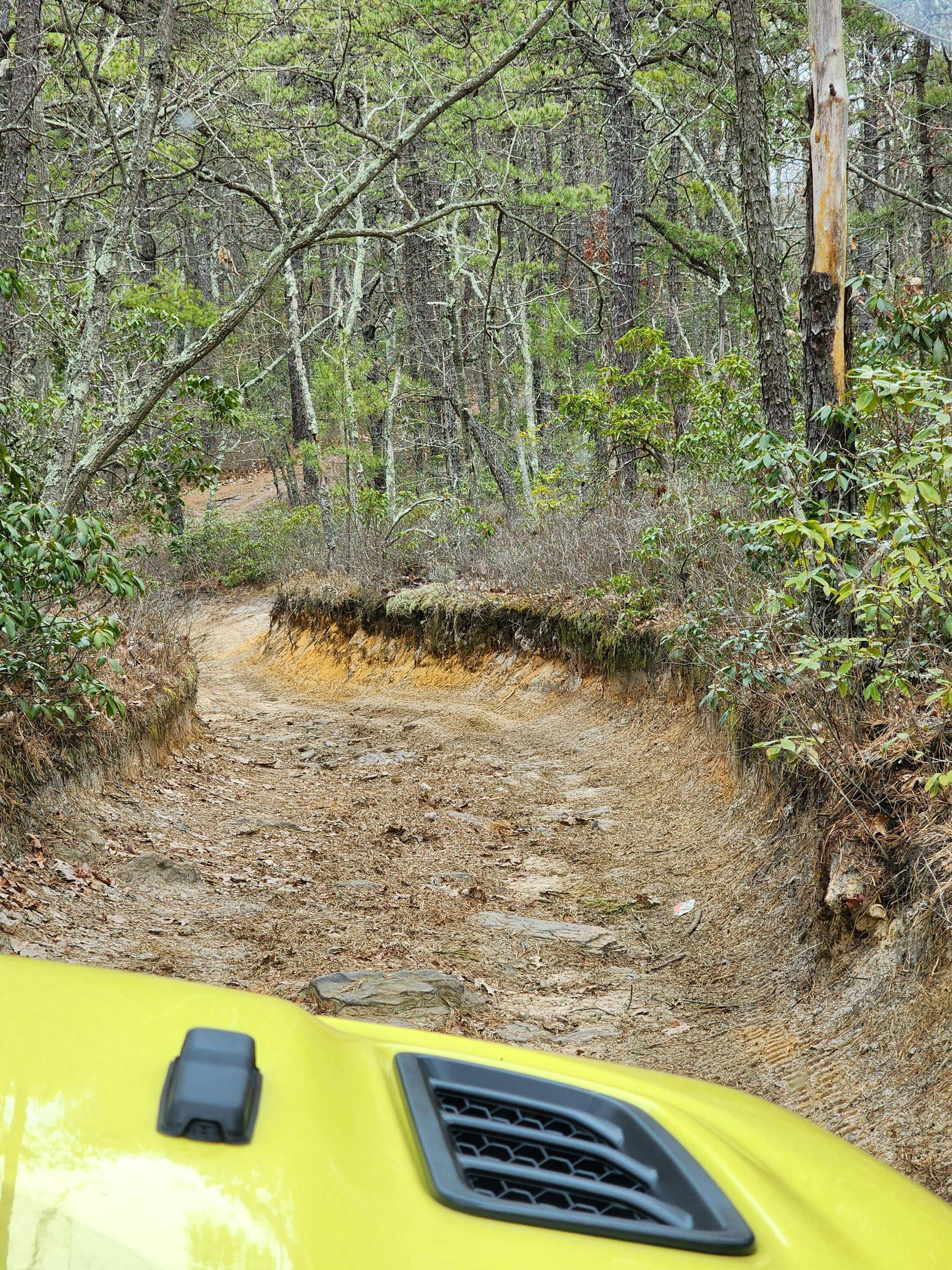

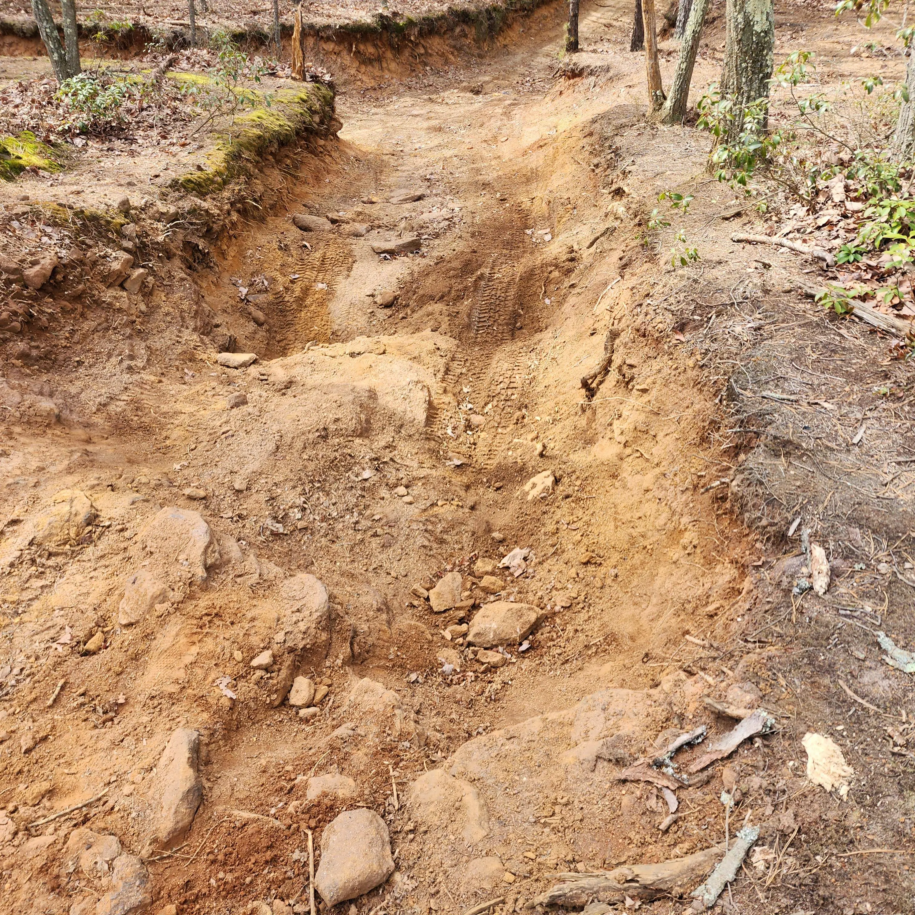

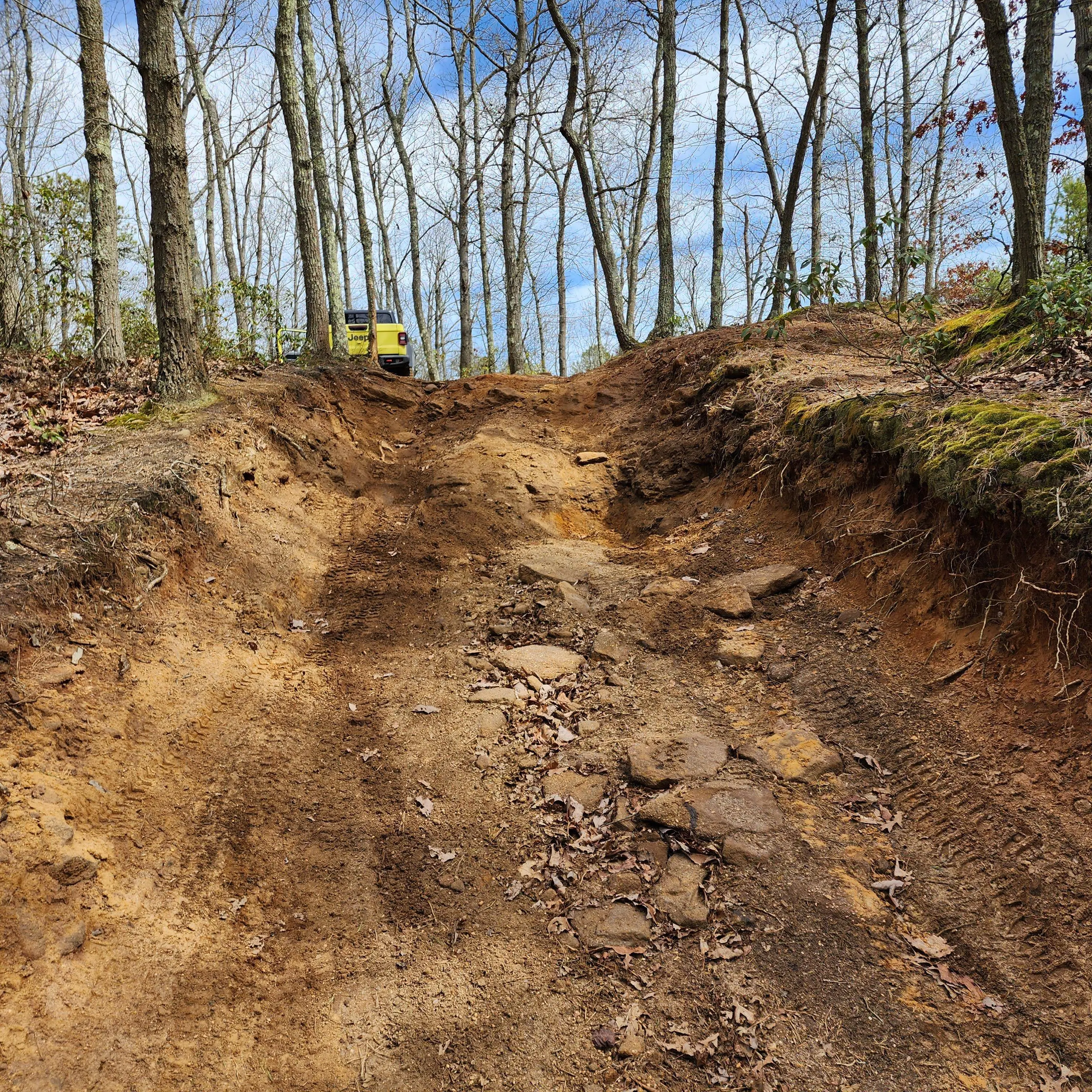

Took the Wife offroading for the first time. Had a surprise day off, so got her in the Jeep and headed on over to The Two Towers Loop in Jackson NJ. It only has 1 real obstacle, and we did the loop twice, so I could run different lines. Jeep did very well. Bashed off the skid plates some, even got some scratches on the hitch skid finally, lol! The big discovery here, was whether or not my Wife would get carsick offroad. She did not, which opens up more offroading, and getting a buddy or two involved offroad as well. Should get some good wheeling in this year.
Some of the trails were kinda tight, hard to avoid pinstriping. We had to wait for a convoy of 15 New Broncos. TWICE. Saw a Bronco Raptor in the lot. Which was cool.

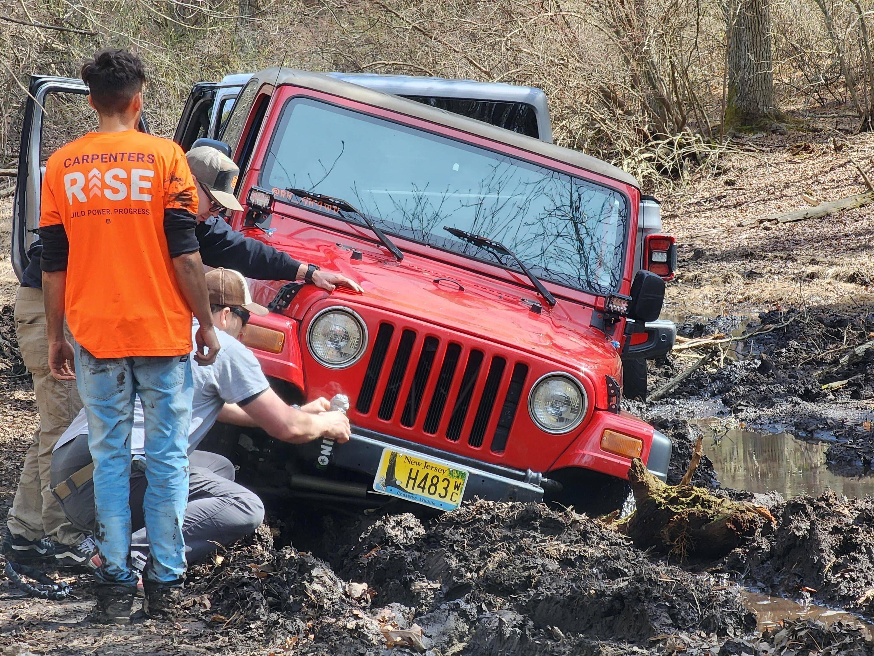

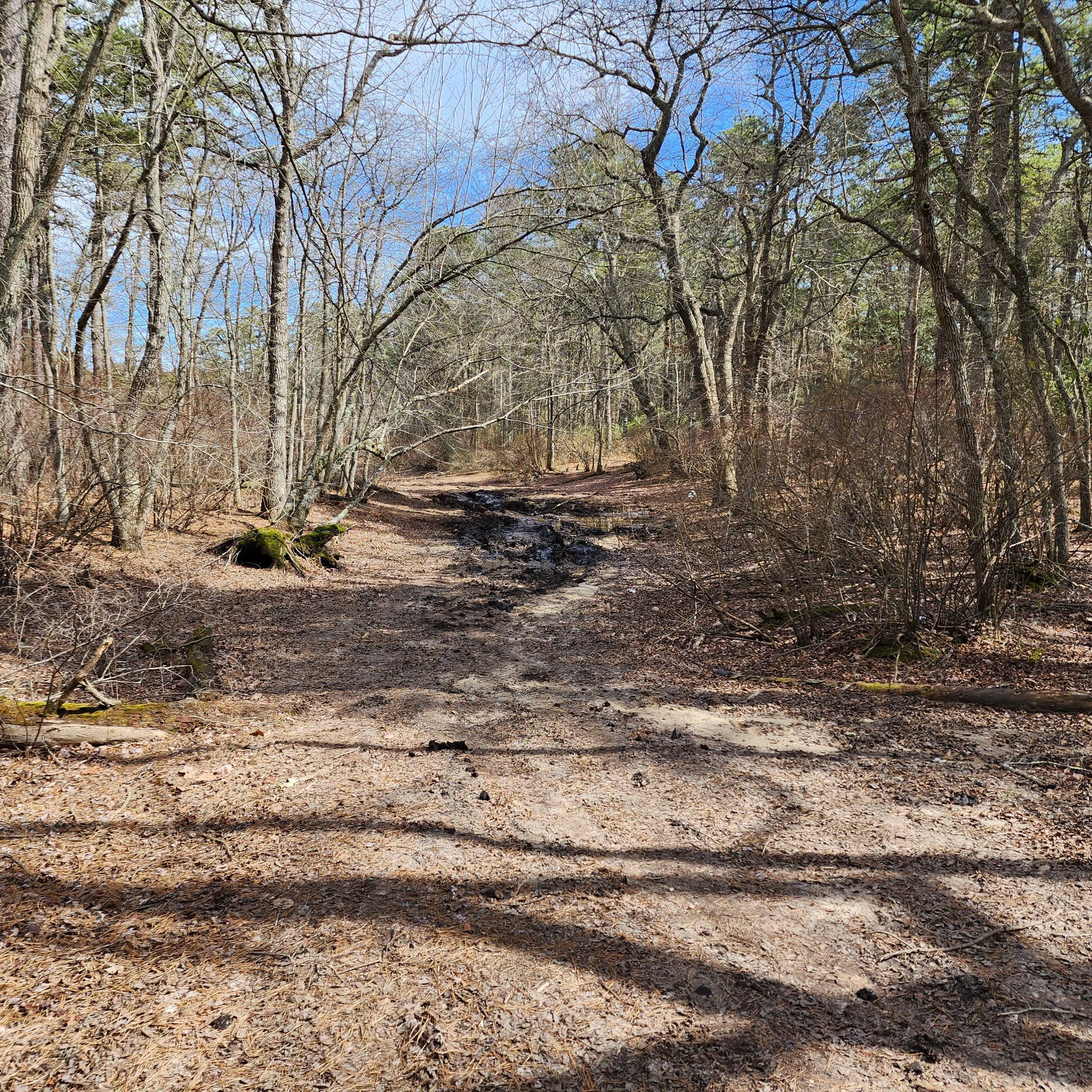

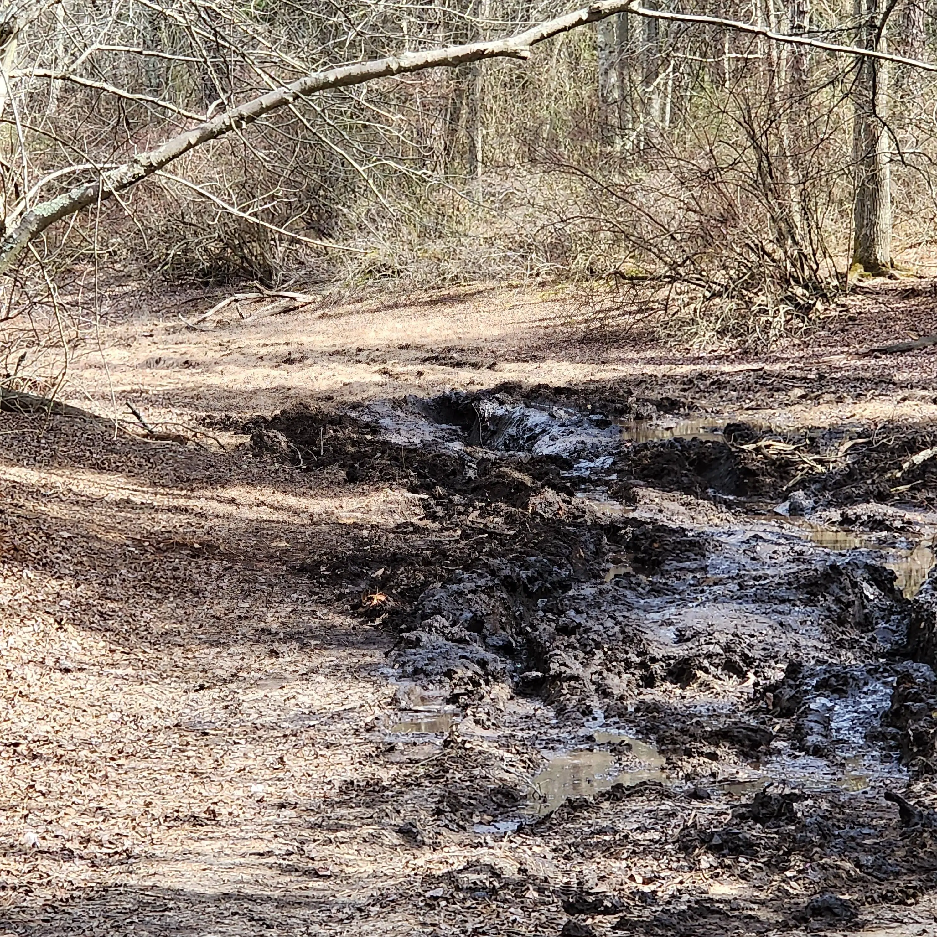

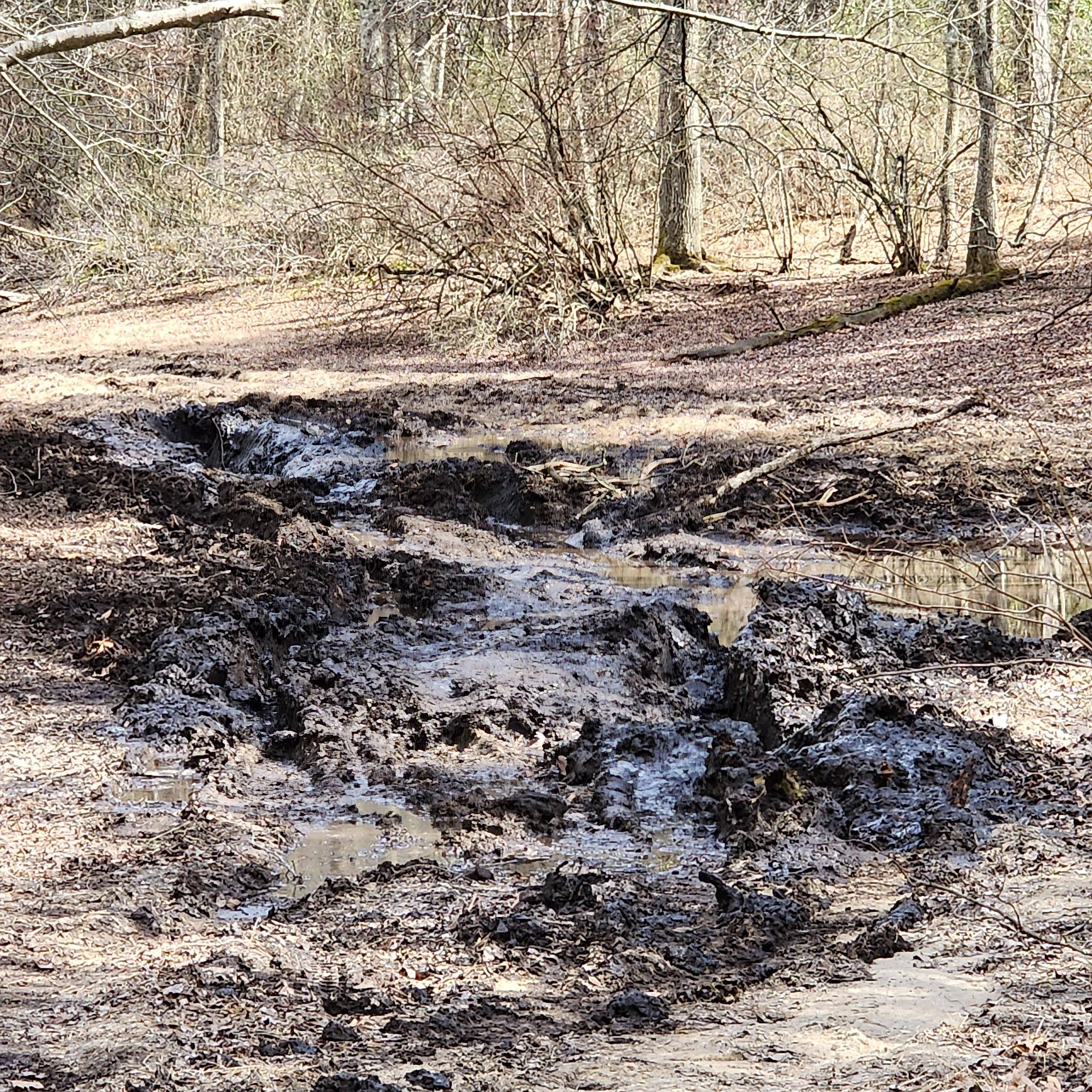

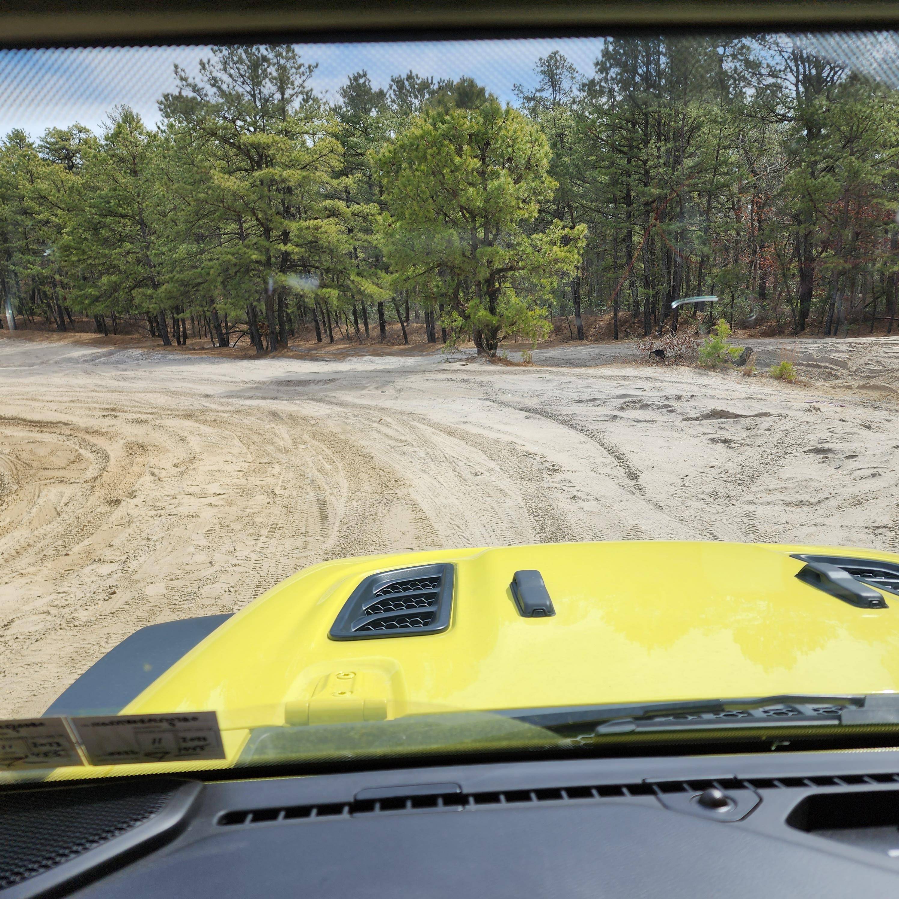

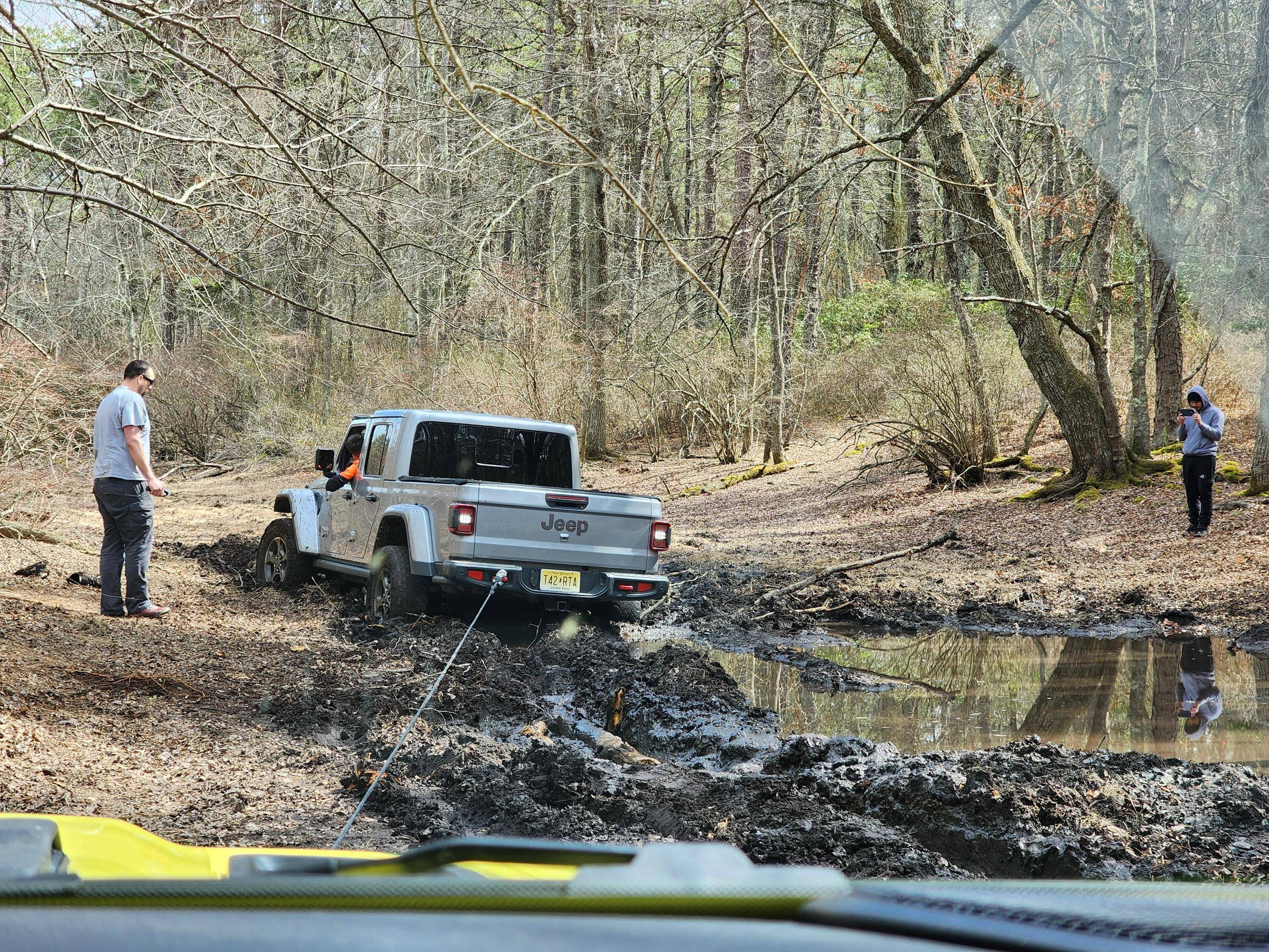

Recovered these two Jeeps. Winched them right out. No problems, thankfully! Guy got stuck pretty good, then the wrangler got stuck trying to help, of course, lol. It was pretty wet, and deep mud. I'll attempt this mud pit next time im there, ;)

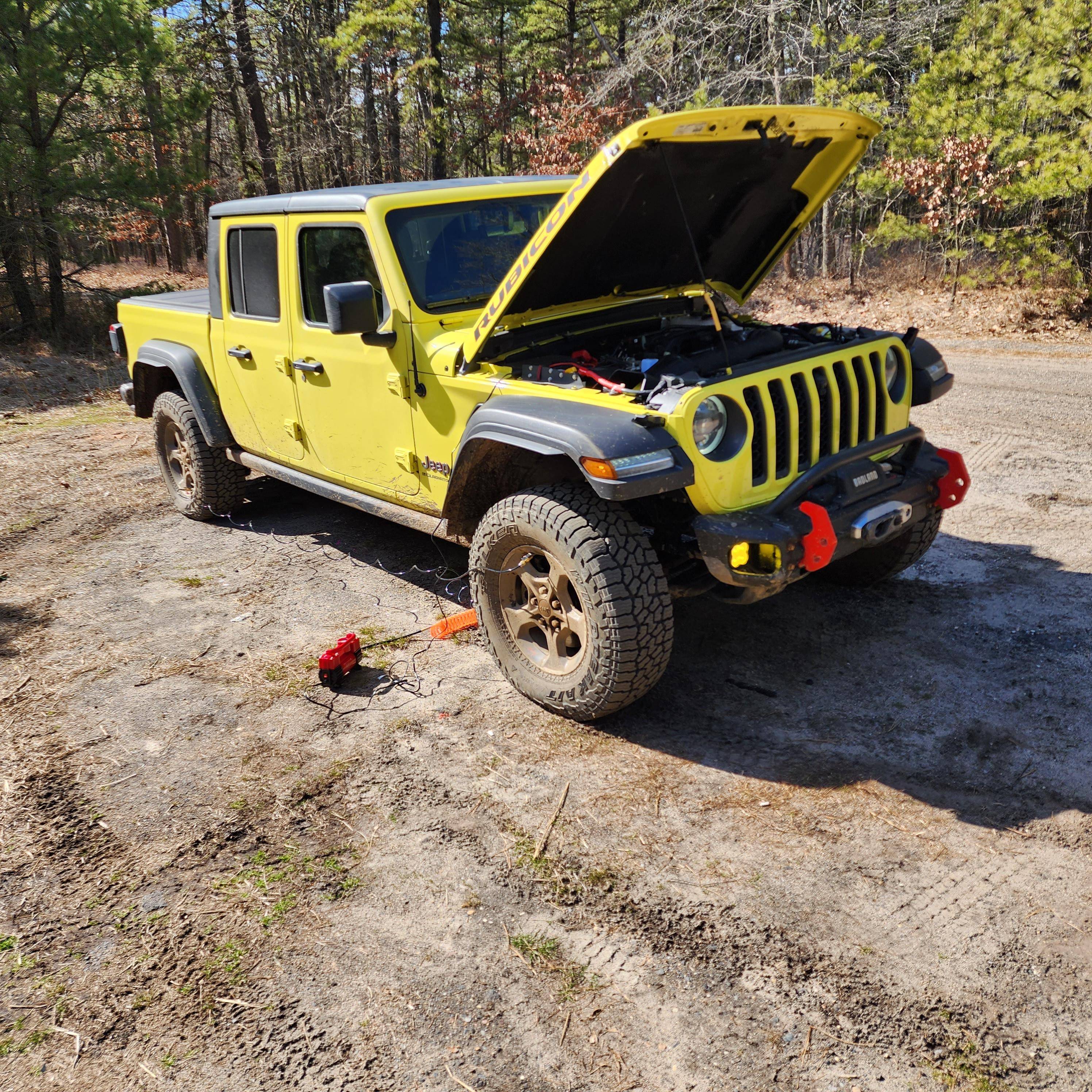

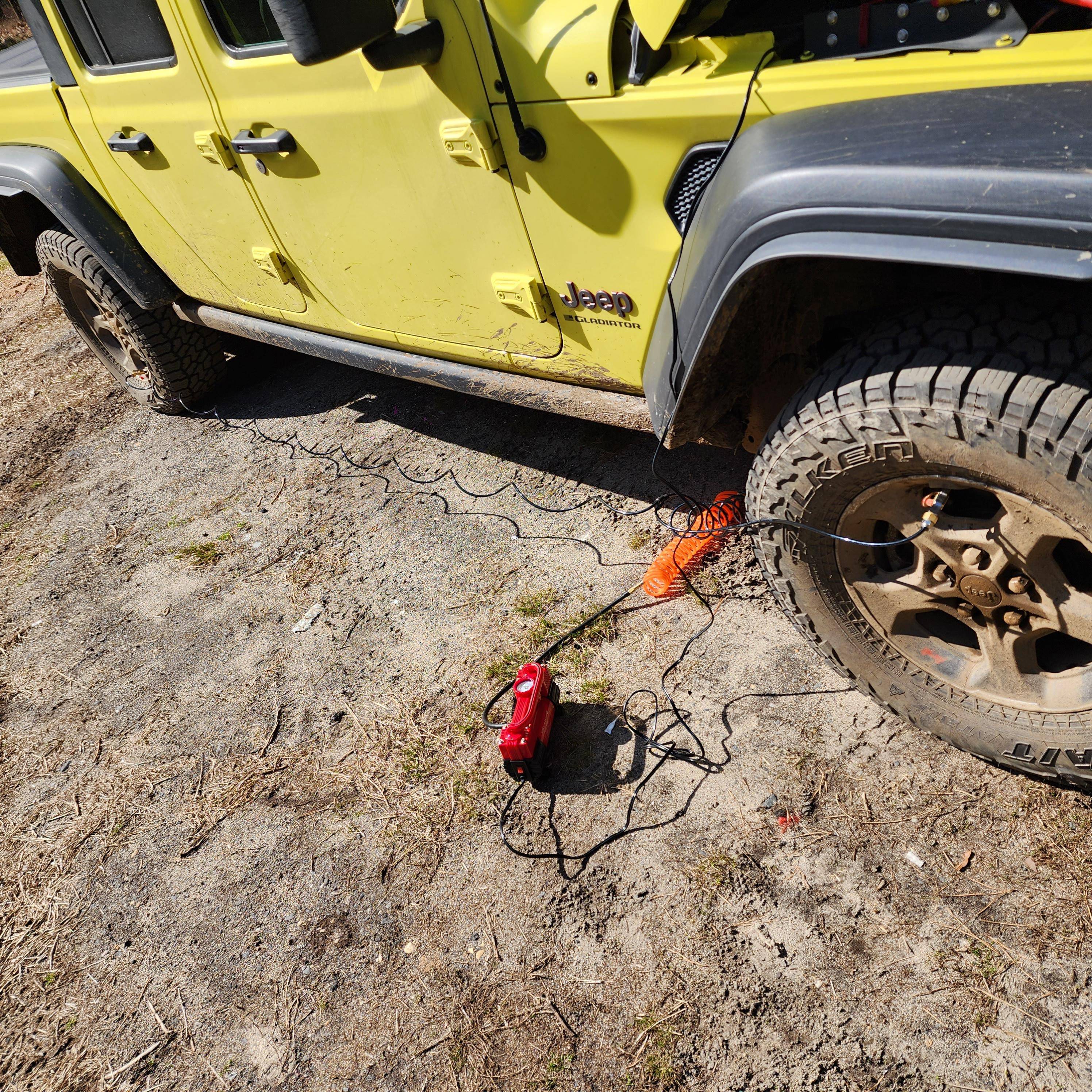

I really need a better air compressor. Took forever to fill my tires back up. I ran 17 psi on all 4, and it did quite well.

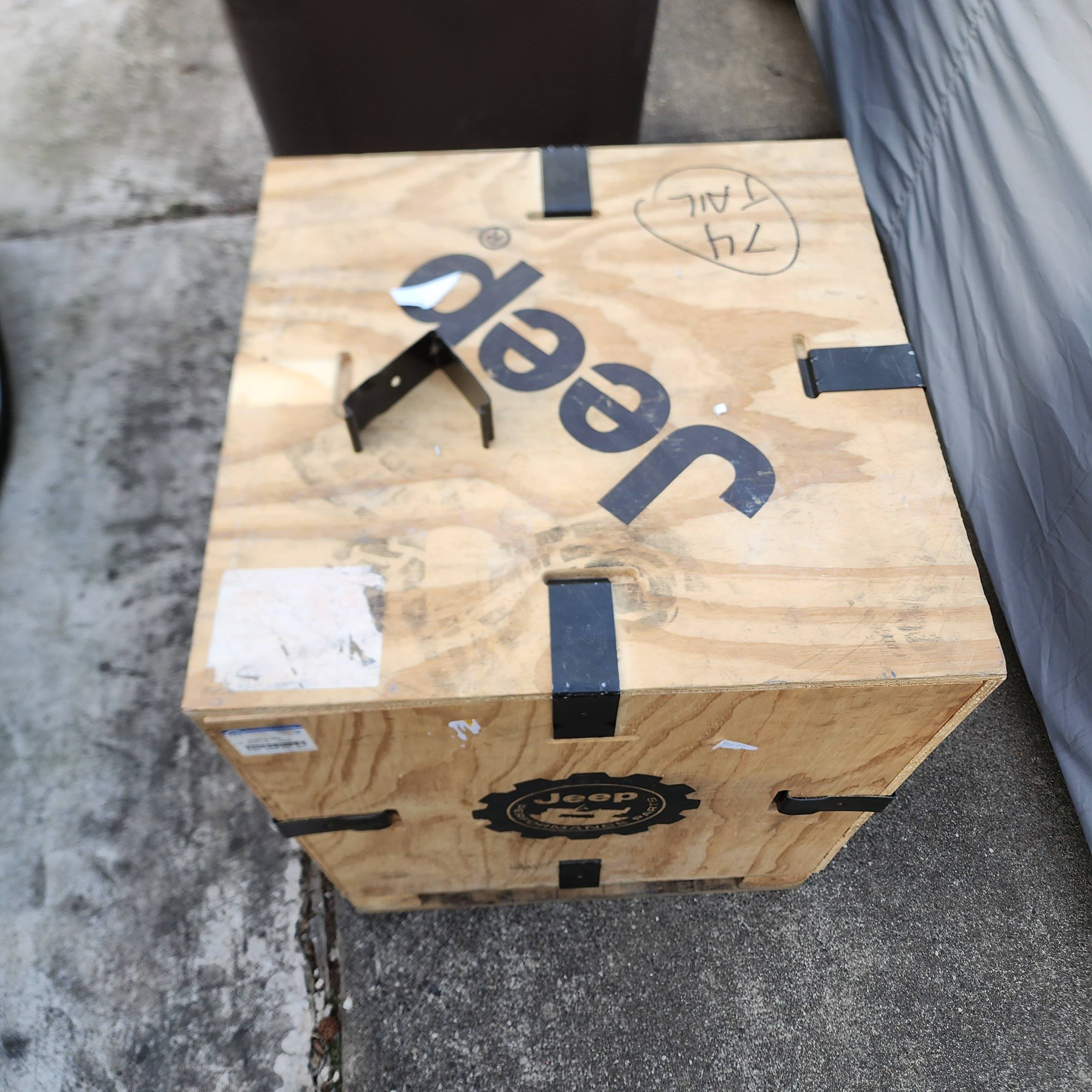

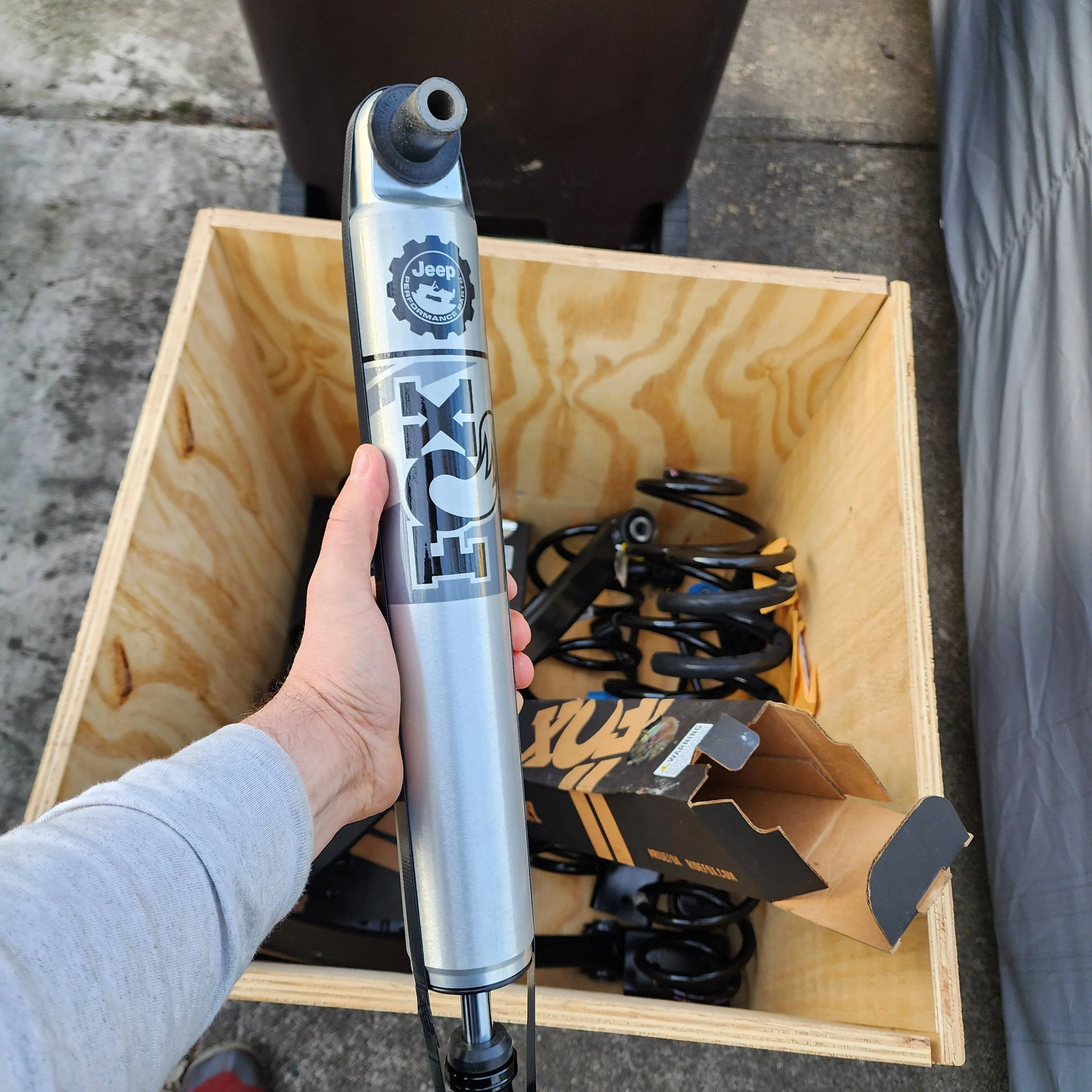

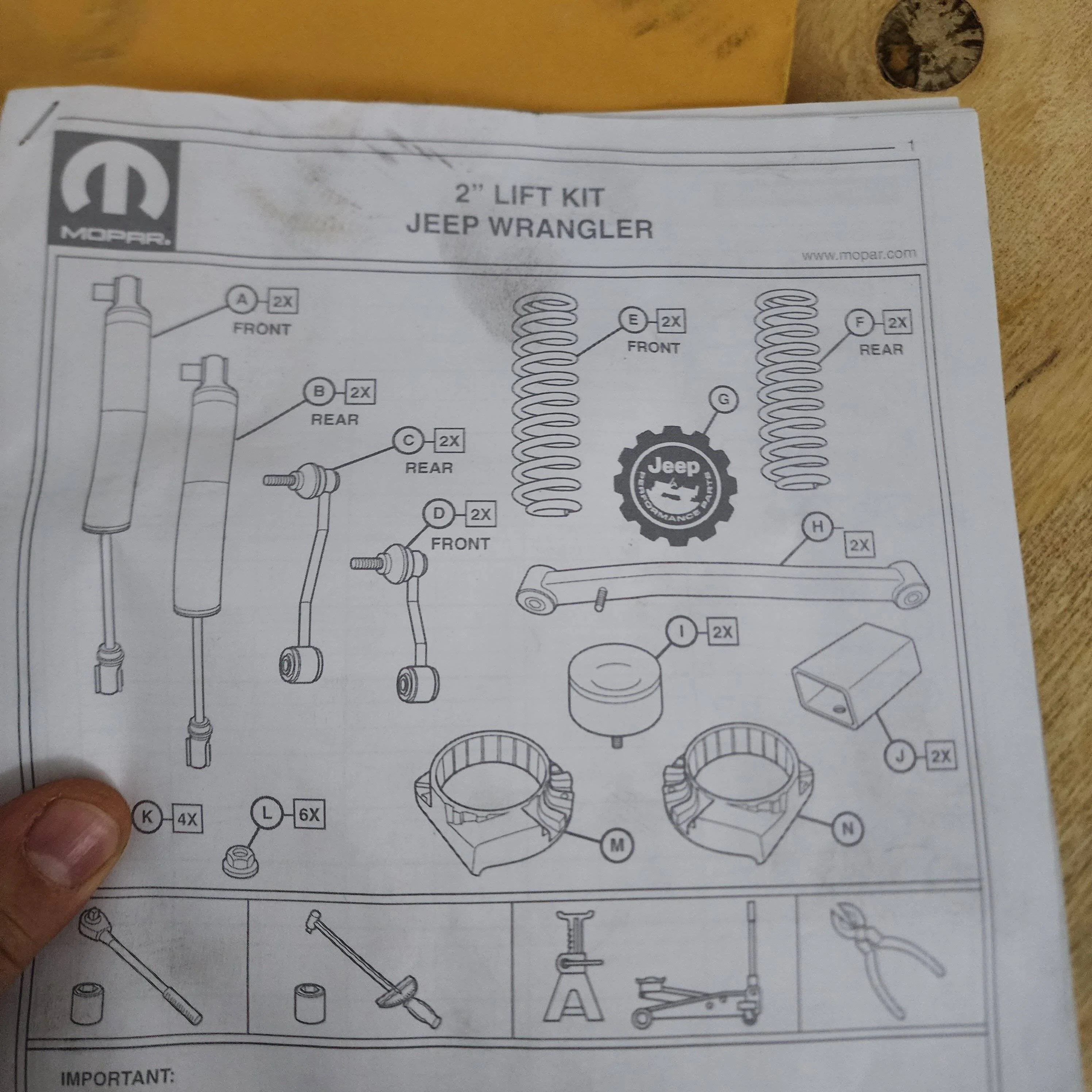

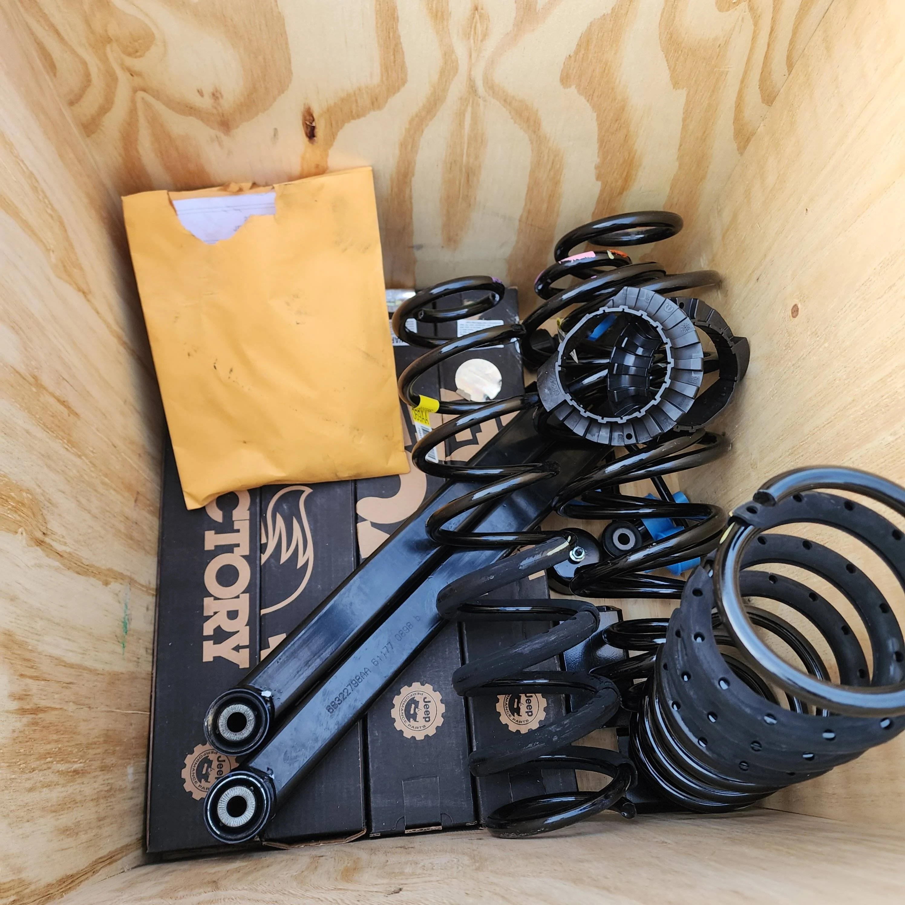

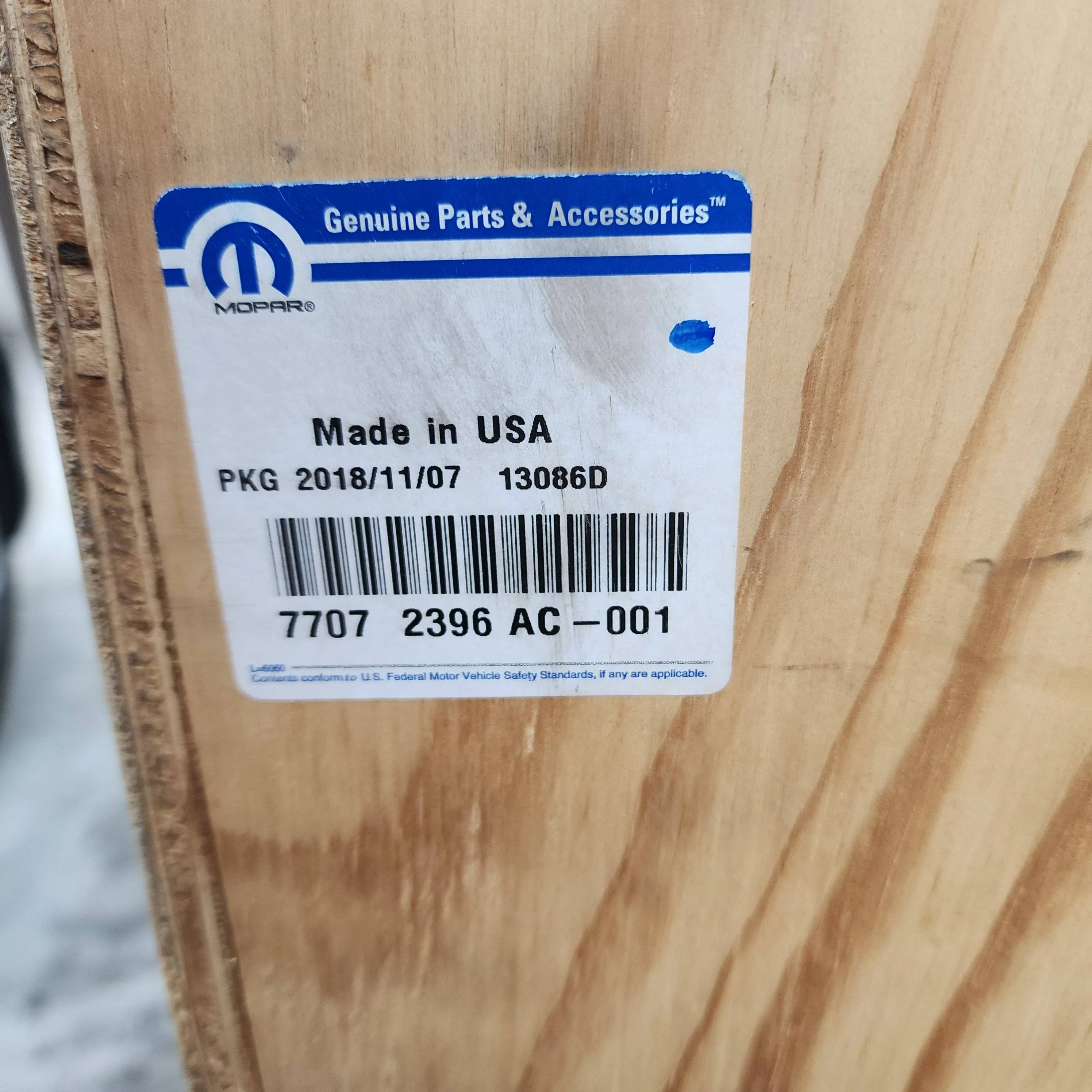

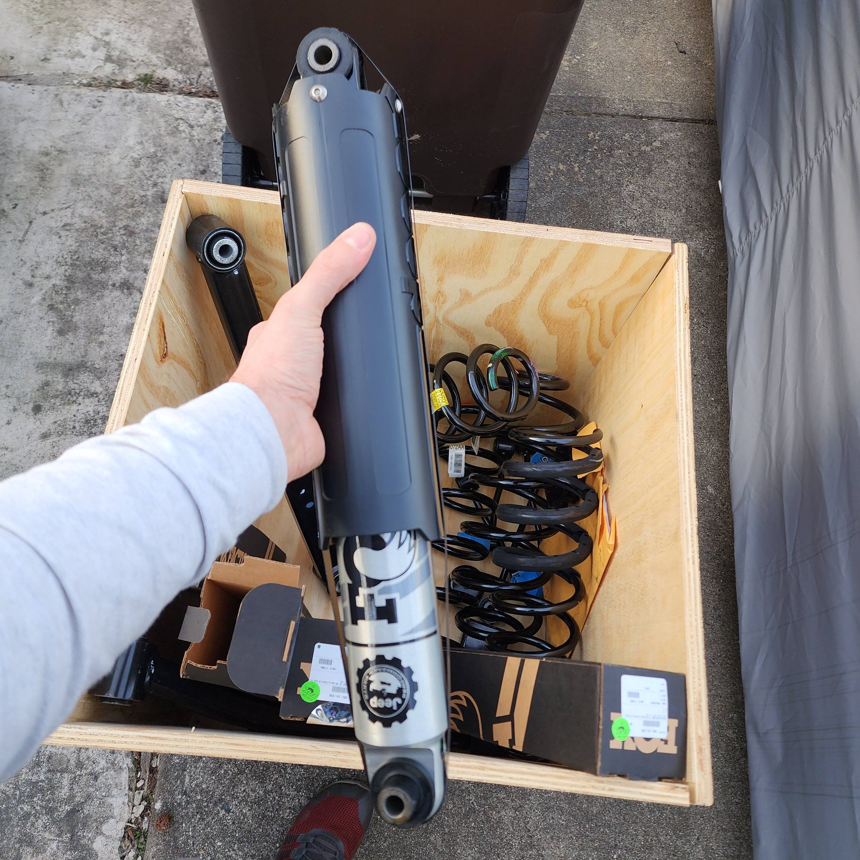

Well, I was sent the wrong lift kit.
This is an "almost installed" 2018 vintage, 2 door Wrangler Mopar lift kit.
Appears a dealership shipped the wrong Jeep crate. Working this out with the seller.
So this is a rollercoaster of a transaction, lmfao!
