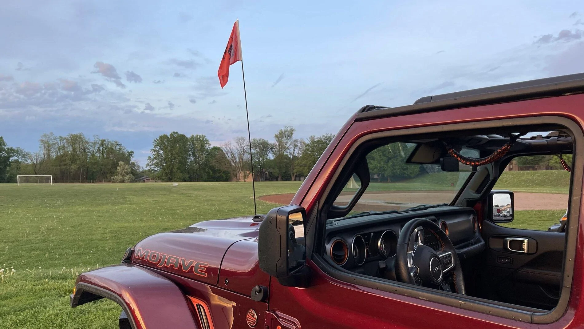

Well it’s not pretty but it’s functional
Jeep Gladiator Dunes Safety Flag/Whip mount points? image

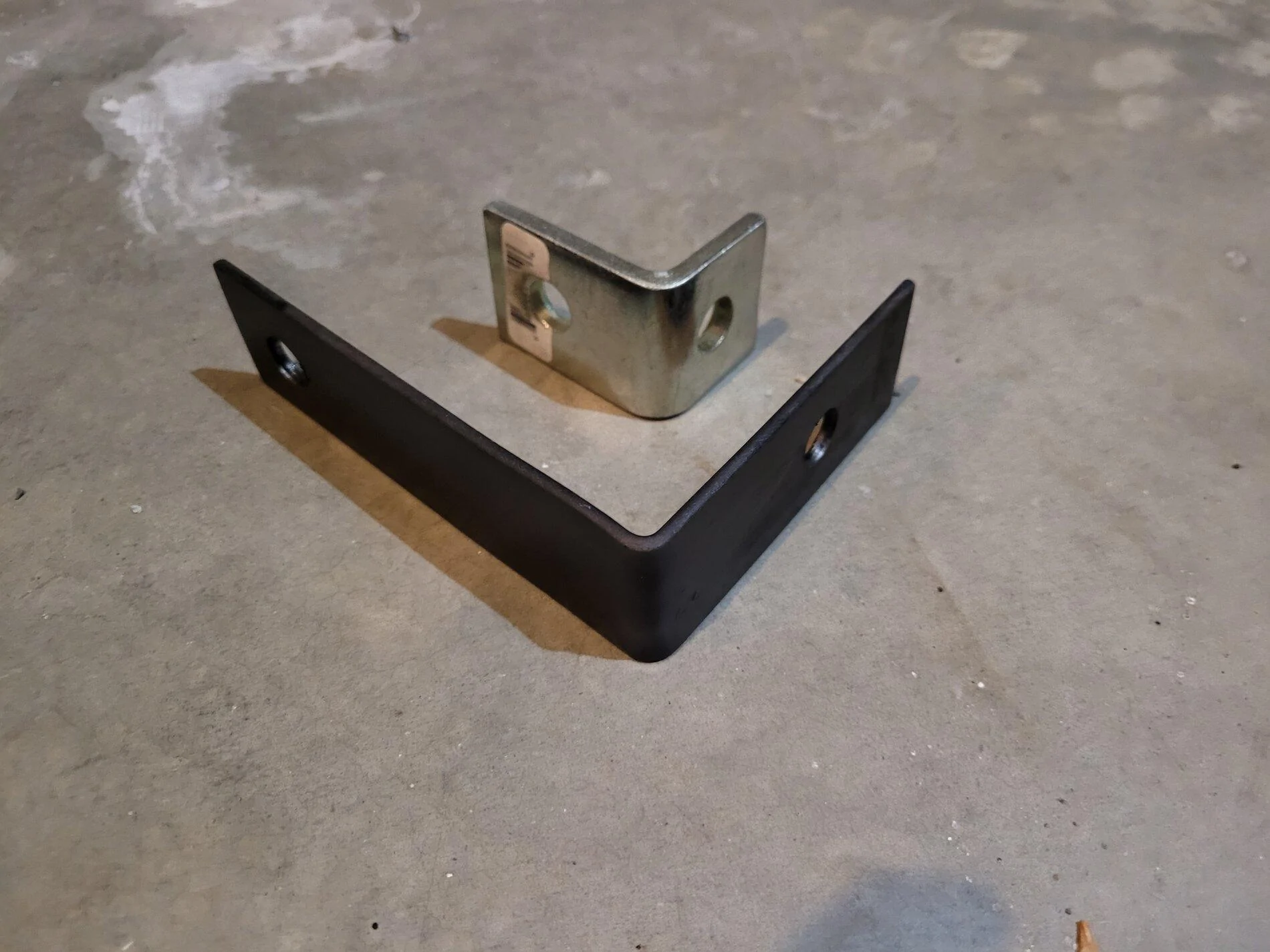

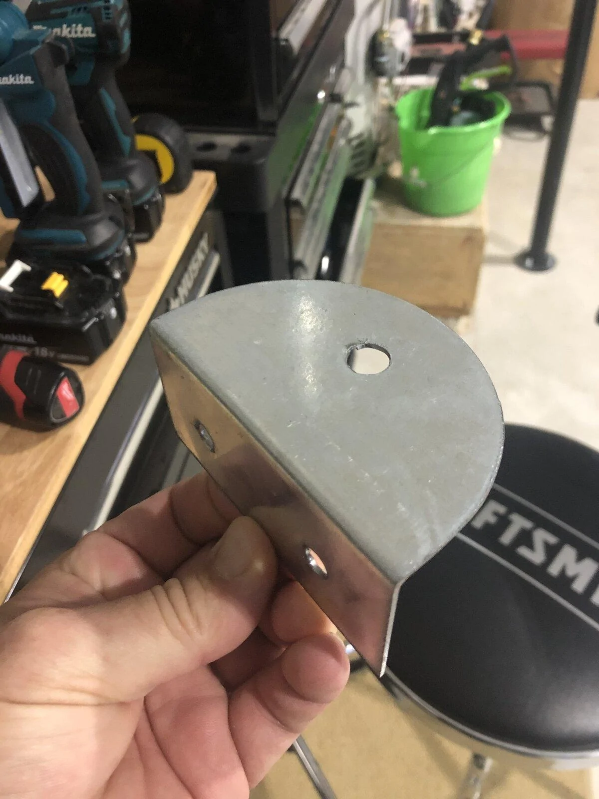

I ended up making my own with parts I found at the big orange store. Works quite well.
I stole this idea and it works great! But, I had to run with my tonneau cover open. Today I fabbed up a little alteration to fix that. Thinner, longer steel bent to run across the bed side. We like to run our local dunes when it snows. No more snow in the bed.
Jeep Gladiator Dunes Safety Flag/Whip mount points? 20210117_061525
Jeep Gladiator Dunes Safety Flag/Whip mount points? 20210117_062227

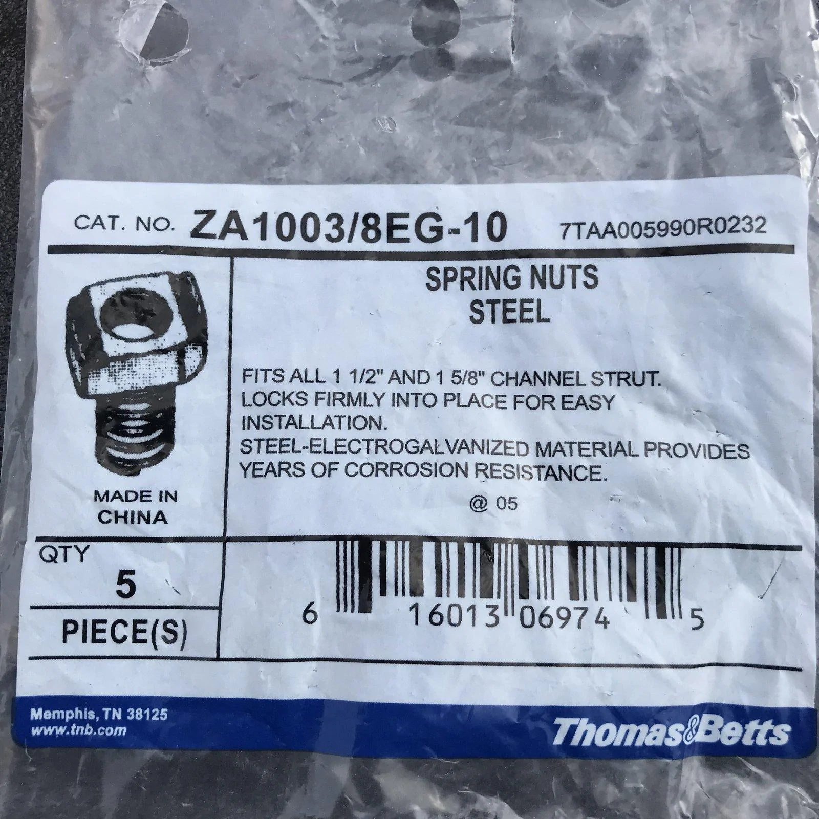

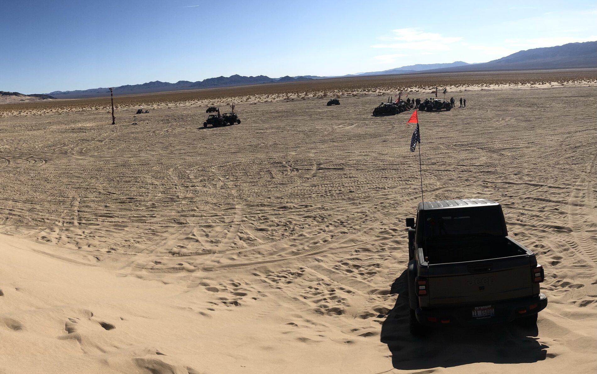

I run this with (2) strut nuts into bed rail system. I build it on my burn table and worked perfect at Dumont a few weeks ago
Jeep Gladiator Dunes Safety Flag/Whip mount points? 9F8E1D54-34DF-40D9-A4A4-0B68F0E19DBF
Jeep Gladiator Dunes Safety Flag/Whip mount points? 0C872917-920F-429B-9EEE-10824010FAF2
