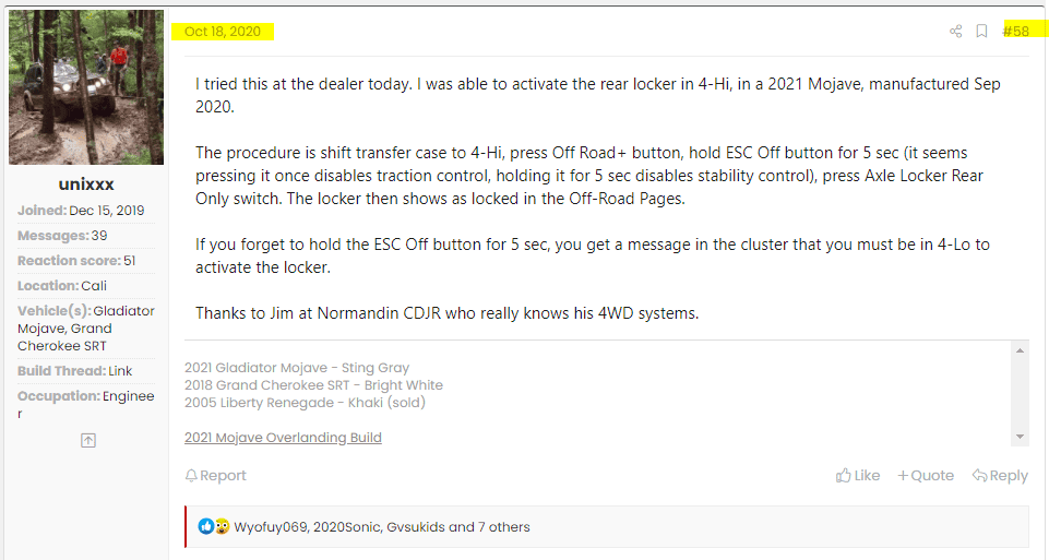

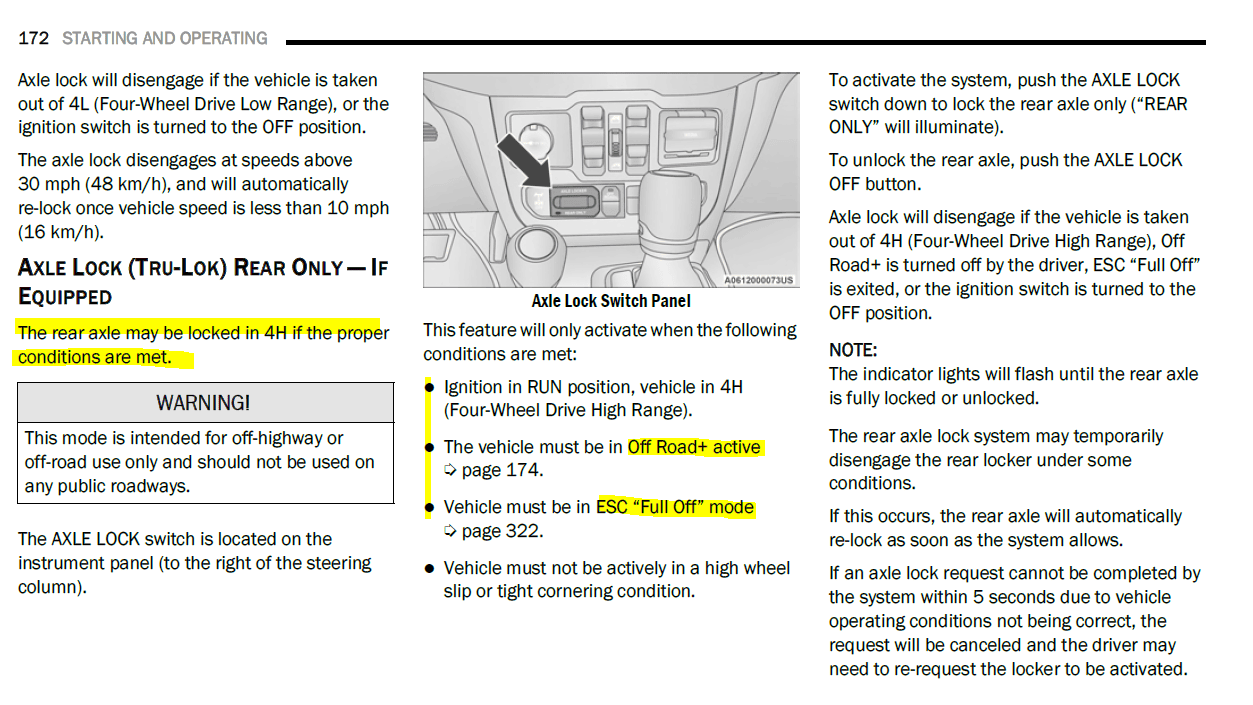

I don't believe there's any restriction or programmer needed. Not trying to be rude but have you looked at the owners manual? A quick google search for "2021 Jeep Gladiator Mojave owners manual" yielded this...
Jeep Gladiator E-Lockers & 4WD HIGH ? 1635889063413

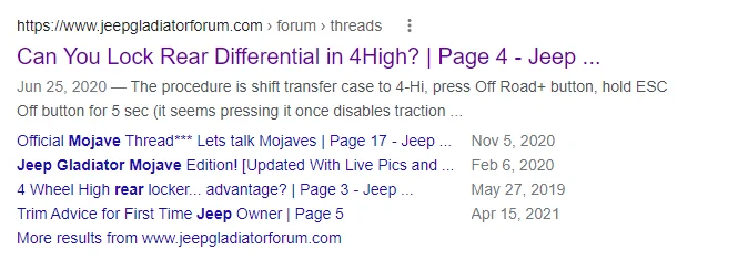

Another google search for "2021 jeep gladiator mojave 4h locking differential" shows this...
Jeep Gladiator E-Lockers & 4WD HIGH ? 1635889208437
https://www.jeepgladiatorforum.com/...-lock-rear-differential-in-4high.16964/page-4
Jeep Gladiator E-Lockers & 4WD HIGH ? 1635889126506
