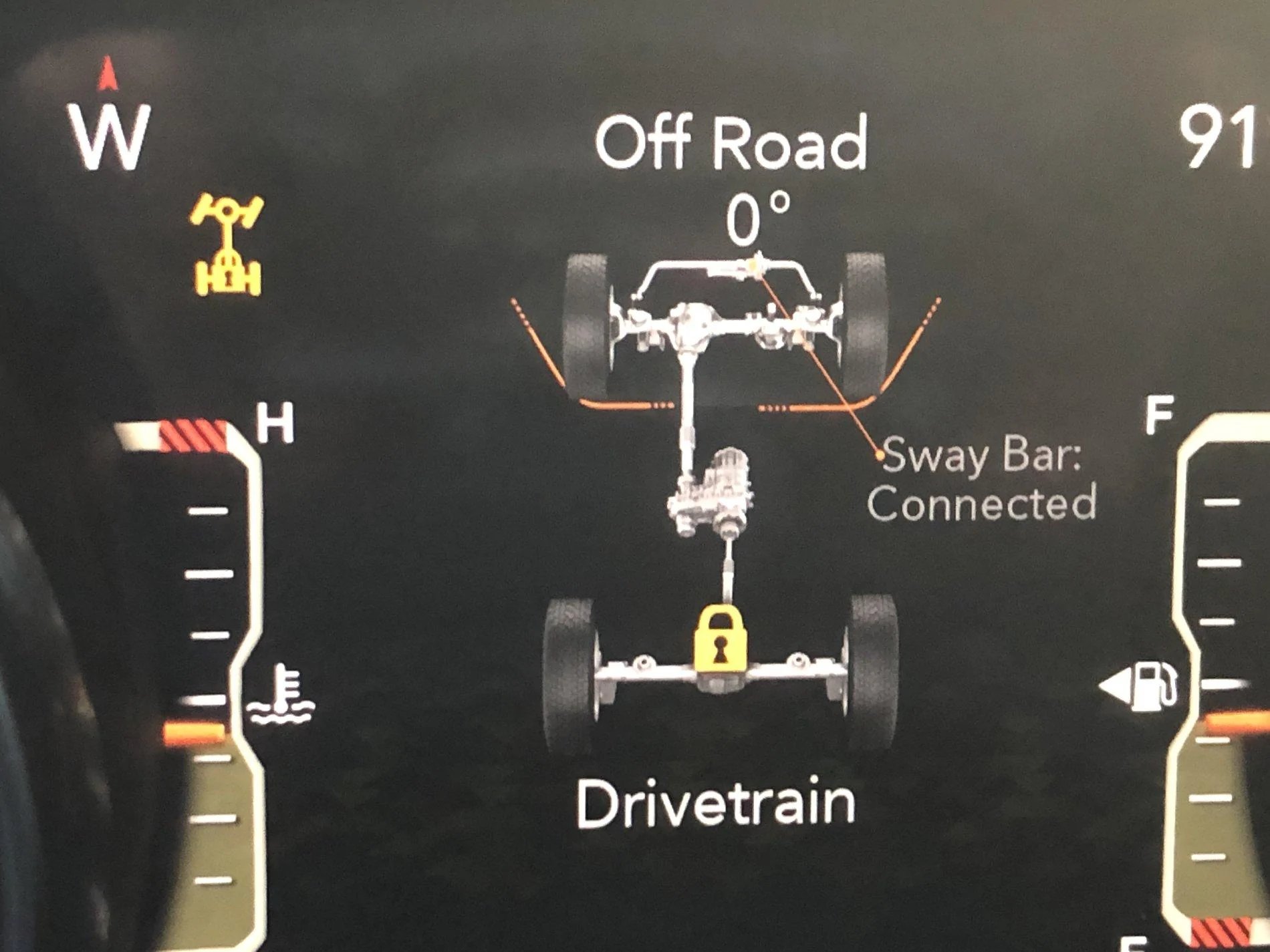

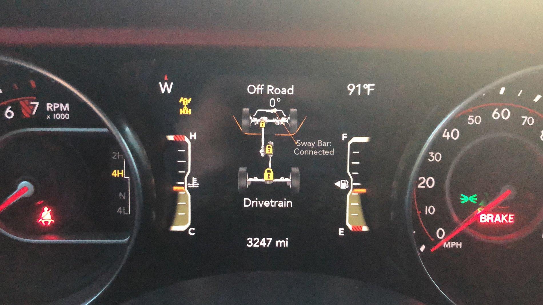

As someone said. Tazer works. Rear locked on 2wd. Rear only 4wd high locked or front and rear locked In 4wd high. Took a few cycles to get this to override the Jeep nannies for the front. Works now.

Any update on 2021s having rear lock? I’ve used it in 2wd with my Tazer enabled Rubi a couple of times while backing a trailer on wet grass and on a tight trail to turn around on loose soil /gravel. It was good to be able to use 2wd and a rear locker for maneuverability in both cases ( I don’t think the 2021 update will let u use in 2wd). I locked all 4 in high for some deep mud at speed too.
