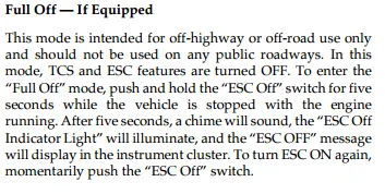

I dont have mine yet but perhaps try 4H, off-road +, then hold ESC for 5 seconds (FULL OFF), then try the rear locker. It might not be working because the ESC system wants all wheels to spin on their own.

I believe the off road plus mode in 4 High is for sand/mud which should lock the rear end. Check the off road pages when you are wheeling...it should show you what’s locked and not
When you press the off road + button, the off road pages appear. They showed that the rear was not locked.
I will try this and report back.
