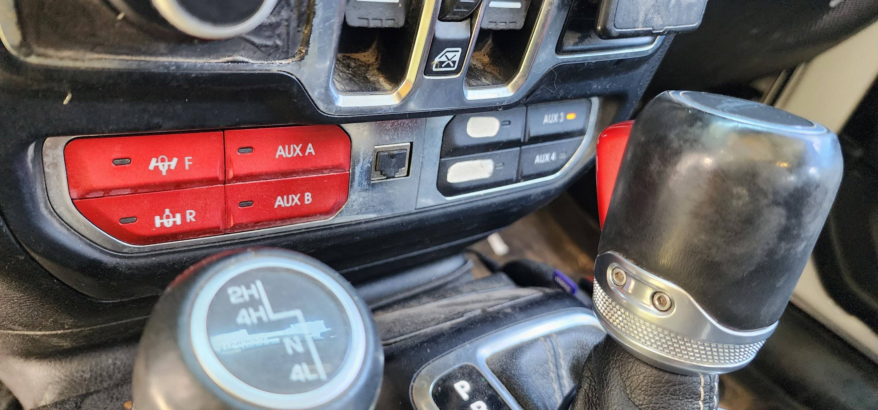

This may not exactly answer your question and I apologize for that, but you have the option of using whichever switch you like. One option is to use a lasfit switch to operate both your rear and front locker.
Jeep Gladiator Eaton E-Locker switch location 20230715_114651

Thanks - yea, before I posted the thread I searched some and saw several folks running the lasfit system & it looks excellent. :rock:

Yes, and it also gives you two extra aux switches, requires no programming, and its easy to install.
Side note: I just realized from the pic that my dash is dirty as hell!!! Good grief I need to clean this thing!!!???

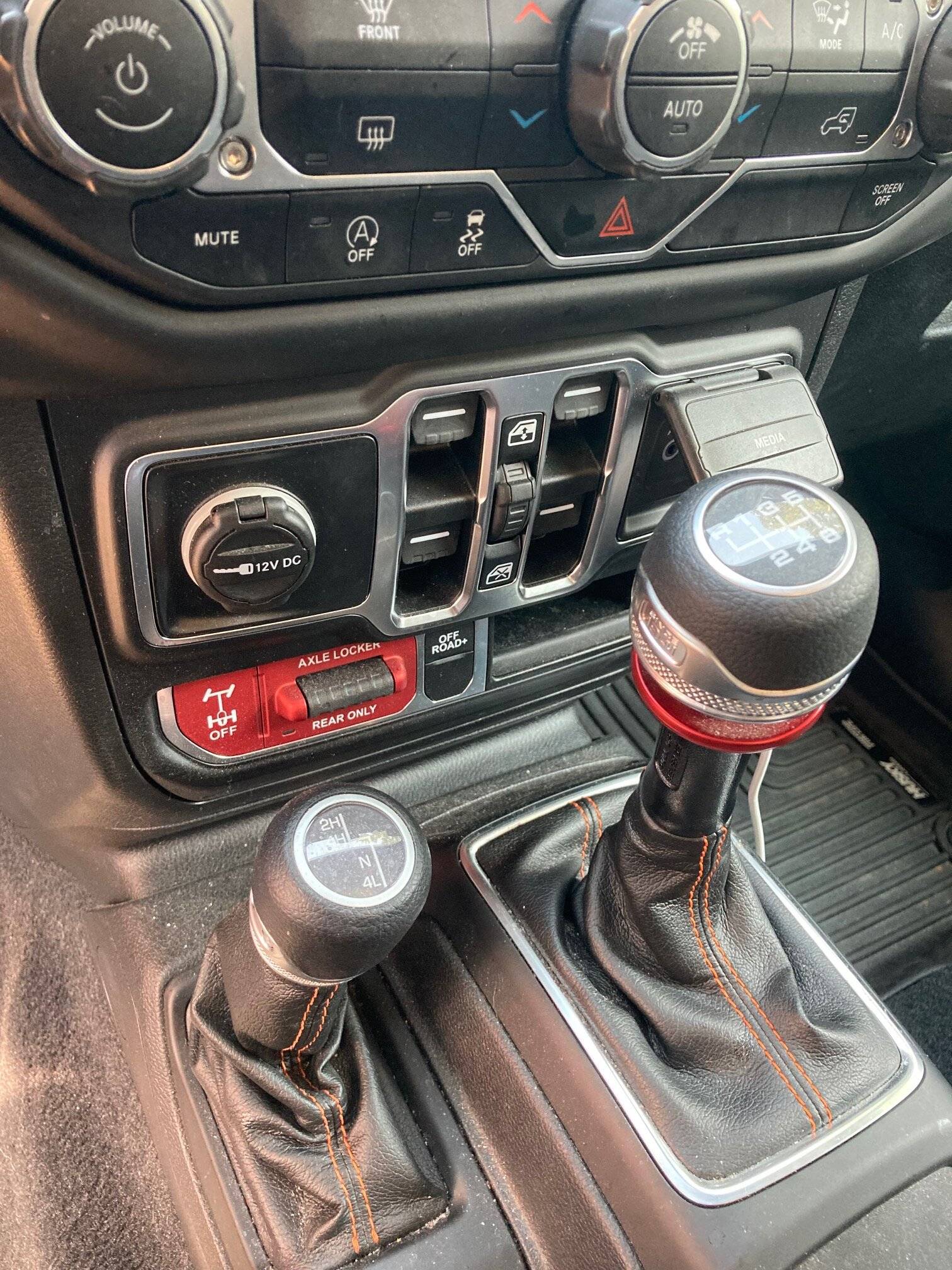

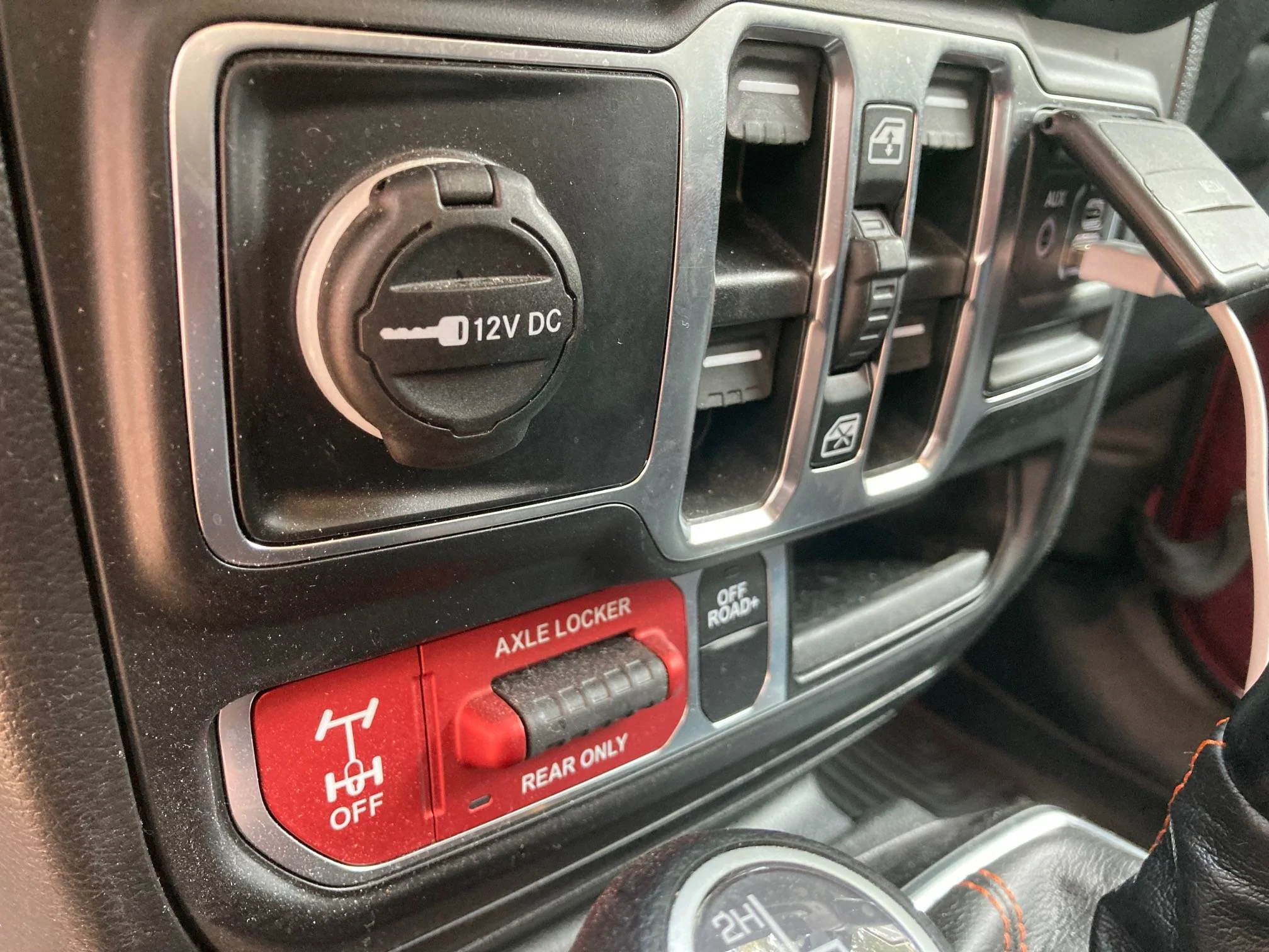

Here's what the current area looks like on my '21 Mojave.
Jeep Gladiator Eaton E-Locker switch location IMG_4612
Jeep Gladiator Eaton E-Locker switch location IMG_4613
