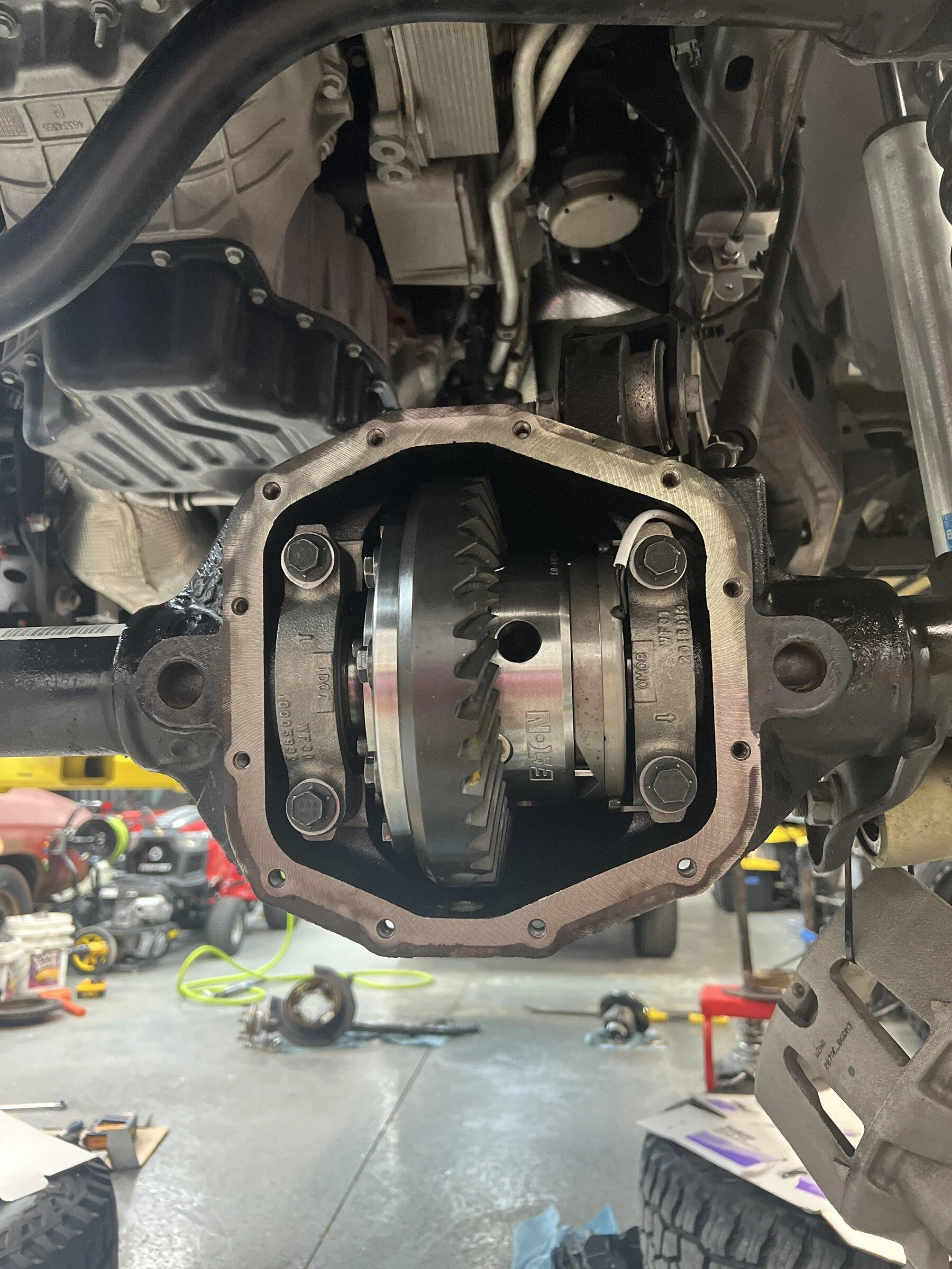

Thinking about an elocker for the front of my max tow. Would I need to swap shafts? I have the CV’s and selectrac. If i need new shafts then i would probably do an arb and the 35 spline RCV’s instead.

I have a sport s (open diff) and added the eaton e locker. It works
I had the e locker installed on the front of my max tow. I didn’t need to swap shafts.

Did you need different side spacers for the bearings? I am looking at this and just wondering what I should order for install. I got a big experience install kit for my limited slip ended up using the bearings and paint, and that was it.
I usually do all my own work on my Jeep, but in this case I didn’t want to tackle this one. I wish I could give you more details. Unfortunately, I asked the shop to install the front e locker and truss. They didn’t say i needed spacers, but I don’t if they would have felt the need to mention it?

Not spacers they are shims. These are used to get your backlash. You can order a dana kit with them from rockauto or some from Yukon. You need to check everthing with the install, pattern and backlash. If you have to move the pinion you’ll need a new crush sleeve and seals.
