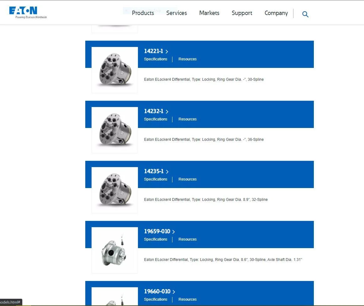

This is the list of them in order on the Eaton site. It isn't even listed in the elockers section.
Jeep Gladiator Eaton E-Locker, Another option finally here for non JTR E-Lockers. Screenshot_20211015-215057_Samsung Internet

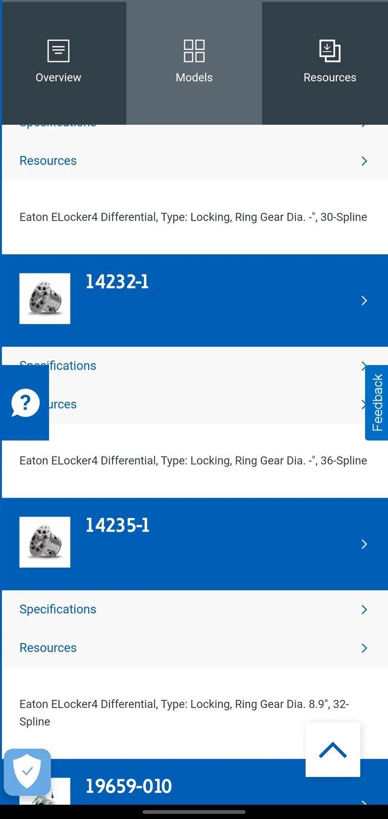

That looks like the mobile site so maybe that isn't up yet. The full site definitely comes up.
