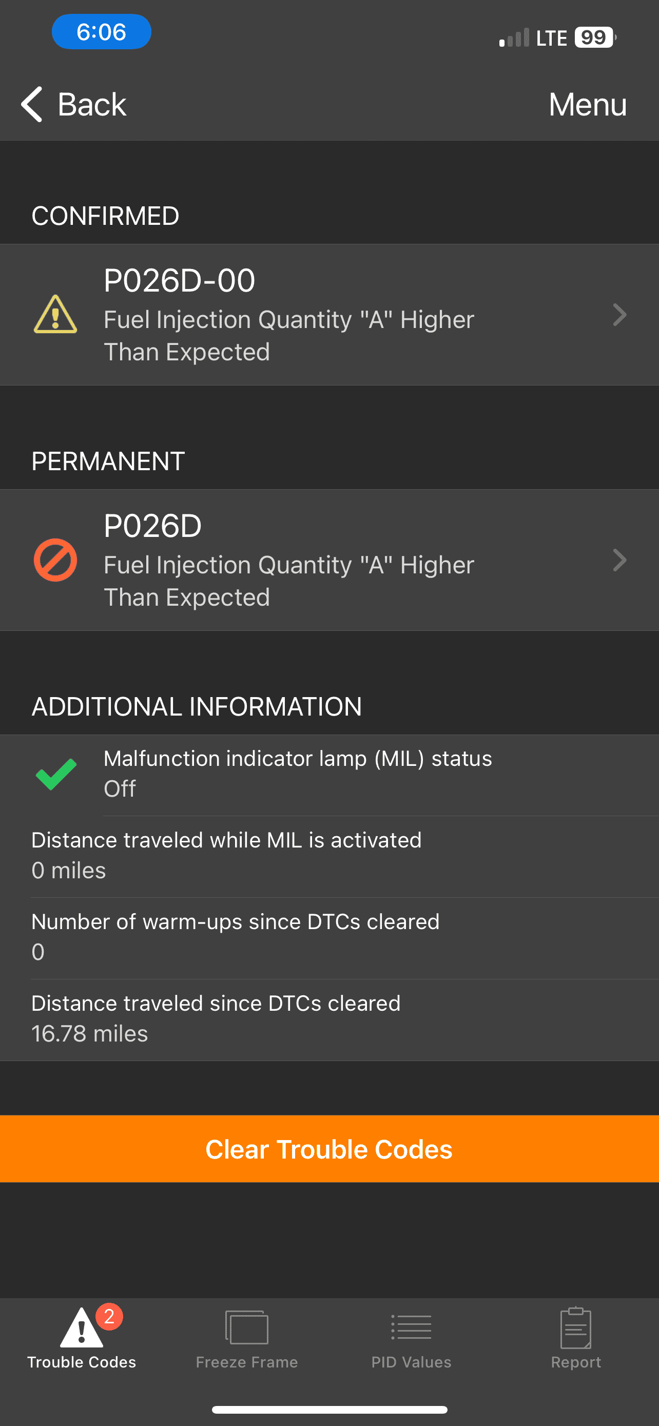

This is interesting because I just started getting a light. I grabbed a couple of screenshots. I even have a permanent one.

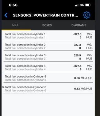

I am currently getting P026D CEL. Using jscan, i looked at the Total fuel correction values at each injector. I'm not a rocket scientist or diesel professional mechanic but I would assess that injectors 1-4 are bad???
