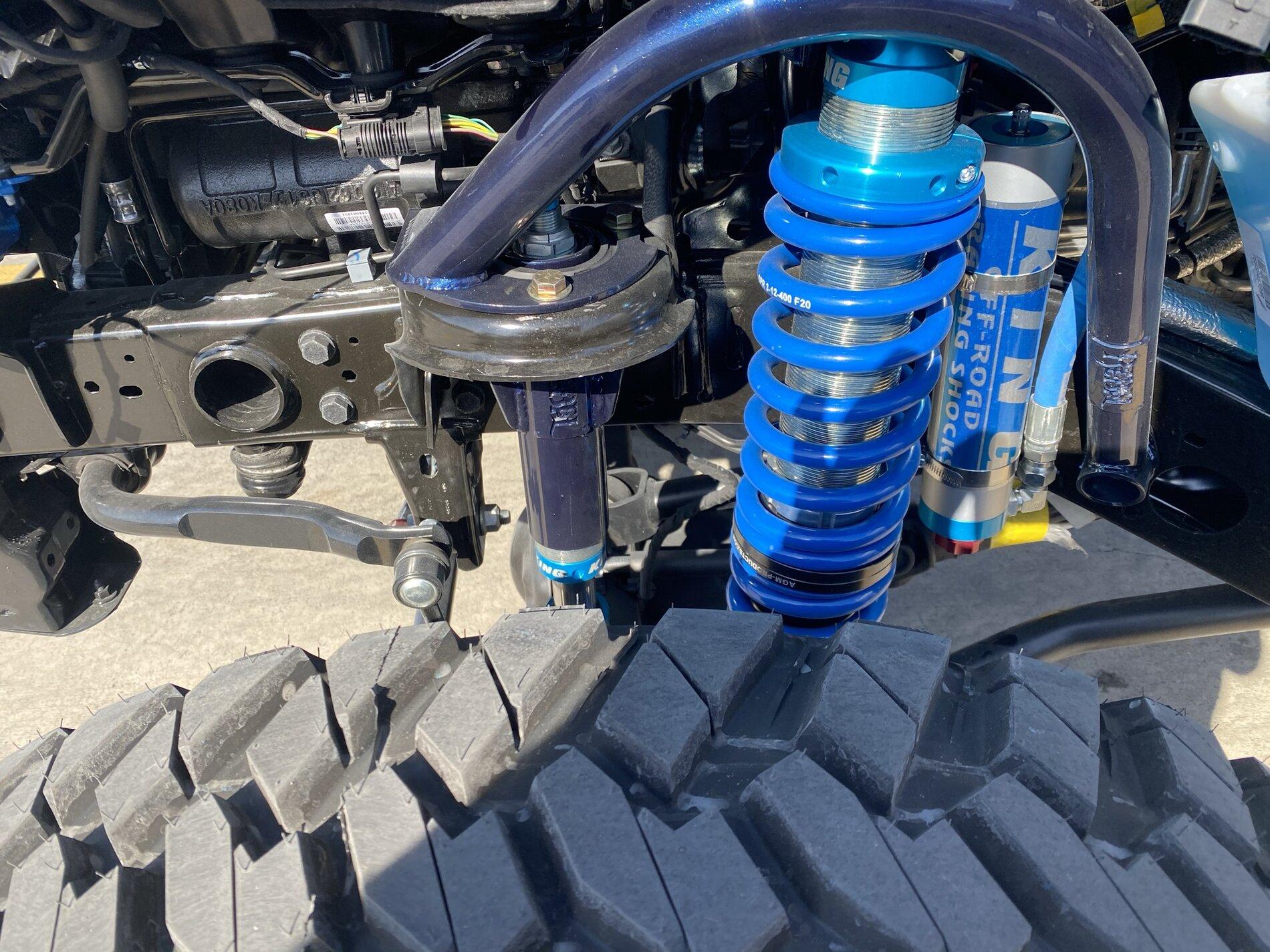

This is why I went with coilovers. All 4 corners were dialed in and I didn’t have to worry about the Diesel engine weight or things being in different places on gas vs diesel. Plus there were no diesel specific lift kits available at the time.
Brian
Which coilovers did you go with? Size?

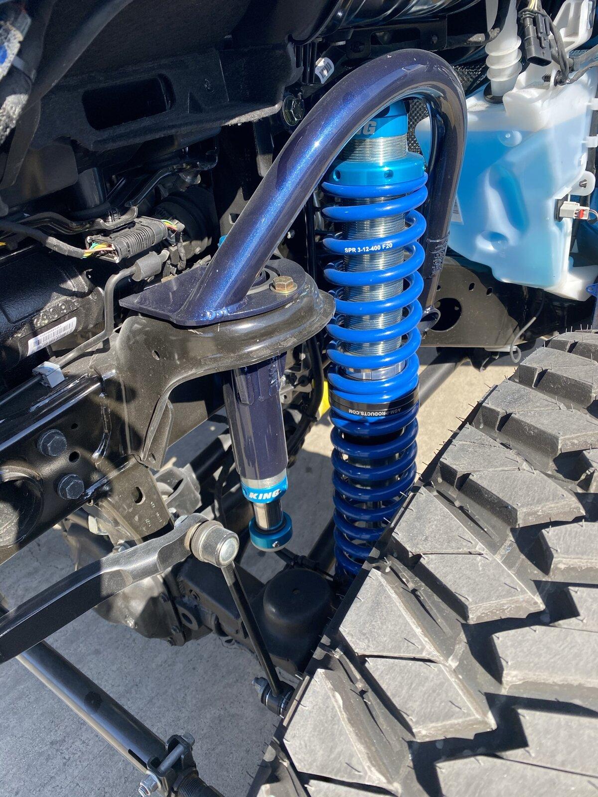

Adding here as I did coils on front . 400 -12” tops and 400 16” lowers on kings. King did mine at their shop so they’re dialed in front and rears. Rides way better then the non tuned to my 2020jt I had last year. Rides night and day over my gas jt. Sits about 5.5” inch lift.
I'm far from a spring rate expert, but yours is about what I would have guessed....200lbin.
Looks like your fronts are sitting on the crossover rings though? Springs may have sagged a bit and need a little preload added?
Yeah this was during install and it final. I will take an updated pic. Ended up about an inch of preload. Like I said the king coils on my gas jt were not dialed in like these ones on my diesel and it drives so much better.

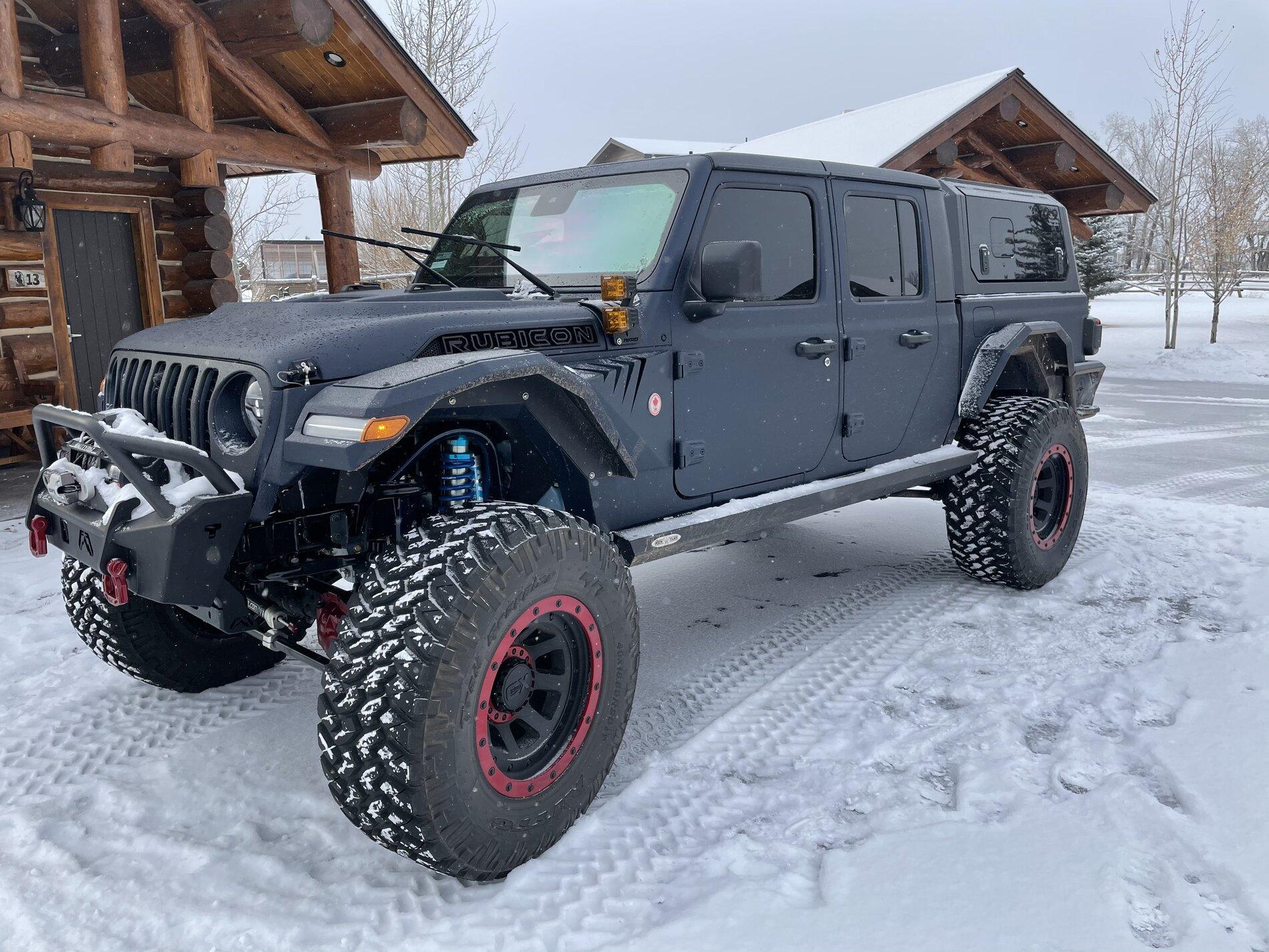

I'll report back once my franken lift is installed (not going coil overs). I'm running 2.5" King adjustable reservoir shocks, King 2.0 air bumps, Rock Krawler diesel JL springs up front, Rock Krawler JT springs out back. The rest is the Currie JT kit minus the front sway bar since I didn't want to lose the front e-disco.
I'm expecting to sit at 3 1/2" of lift. Running 37's. Prefer to keep low COG. I am halfway expecting to have to tune the shocks though.

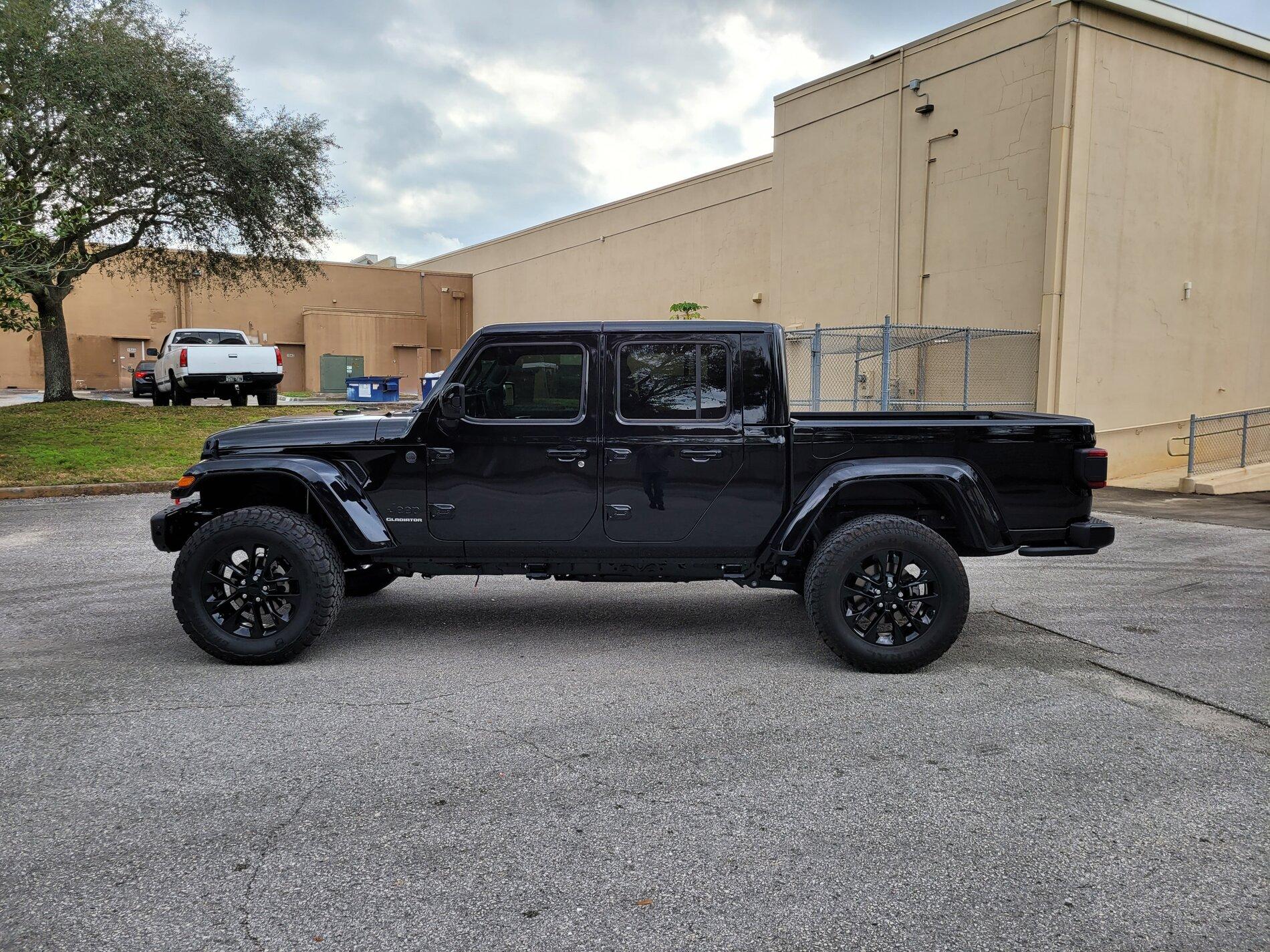

this is my real world experience, 21 JTD(my truck came stock with 20" wheels) I was not happy with the 1.5" leveling kit. I installed teraflex 3.5" JT spring 1873000 in the front and 1873100 in the rear. I have a steal knock off 10th anniv. bumper and smittybuilt 9500lb winch.. the driver side is level at 14.5" over the top wheel. passenger side however is 3/4" lower in the front and 1/4" lower in the rear.. I am going to drive it a month and see if it settles down some. I believe that it I raise the passenger front a 1/2" that the drivers rear will counter balance the front passeneger and maybe level out that 1/4" difference the rear has now
