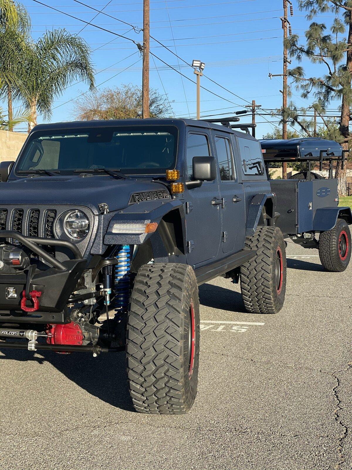

8000 miles in and I have not one single complaint about the rebel recon front coil over. This performs so well on all fronts.

Out of curiosity......do you have the rates of springs you are running on your front shocks? JKU guys seem to run 250s and I was thinking JLU would be about the same. JT Eco diesel maybe 15-20% more....400 over 250?

That’s a great question. So I had the 20 jt gas and had king coils and it was 400/350 as I was pretty heavy up front with grumper and such. This round I had king weigh each corner with everything on it and it ended up being 400 top over 500 bottom. Its just perfect.

Awesome! I wasn't too far off for a gas rig and JTs are heavier front that JLs yes?
222lb combined rate on your setup crossing to 500lb. Never would have guessed a 500 bottom though.
Clayton lists their 2.5" gasser front spring at 188lb. I was thinking 10% higher axle weight as a guess for the Eco which would make me want a 20% heavier spring.....225lb.......right where you are at!
Now I feel like Im getting somewhere.

Yes they are heavier in front diesel jt vs JL front. Glad I could help! Yeah to get the 6inch lift and keep it firm enough the 500 was on top. Learned a ton by going to king and having them test things out. Also rebel off road knows Their stuff so it helped as well.
Could you post some more pics from the side and in the wells? This is exactly the lift I'm considering. thanks
