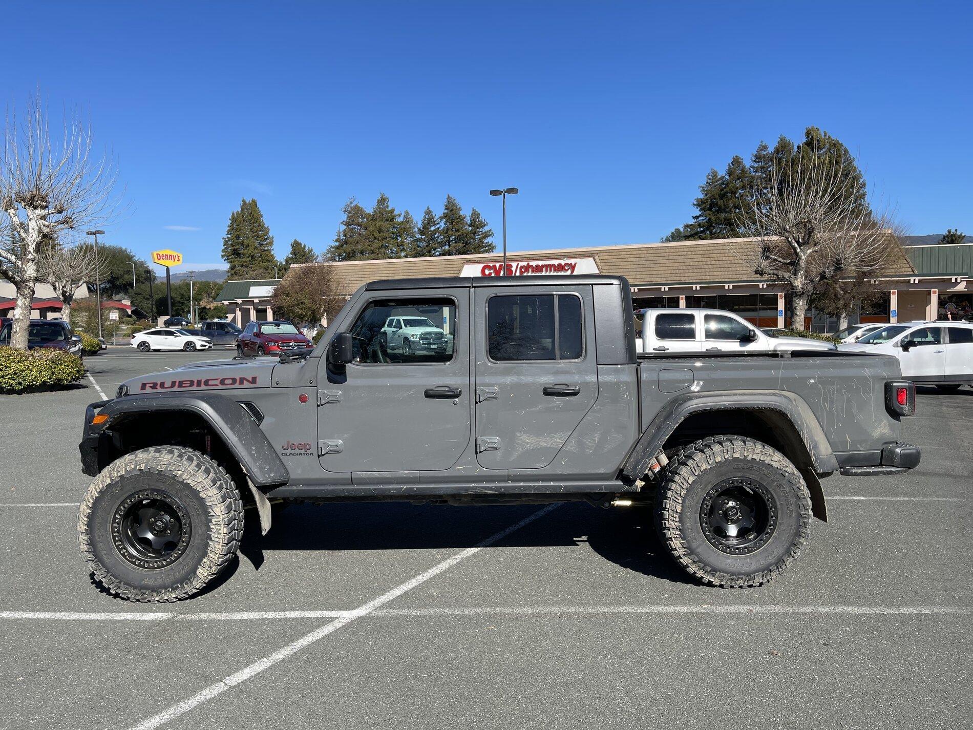

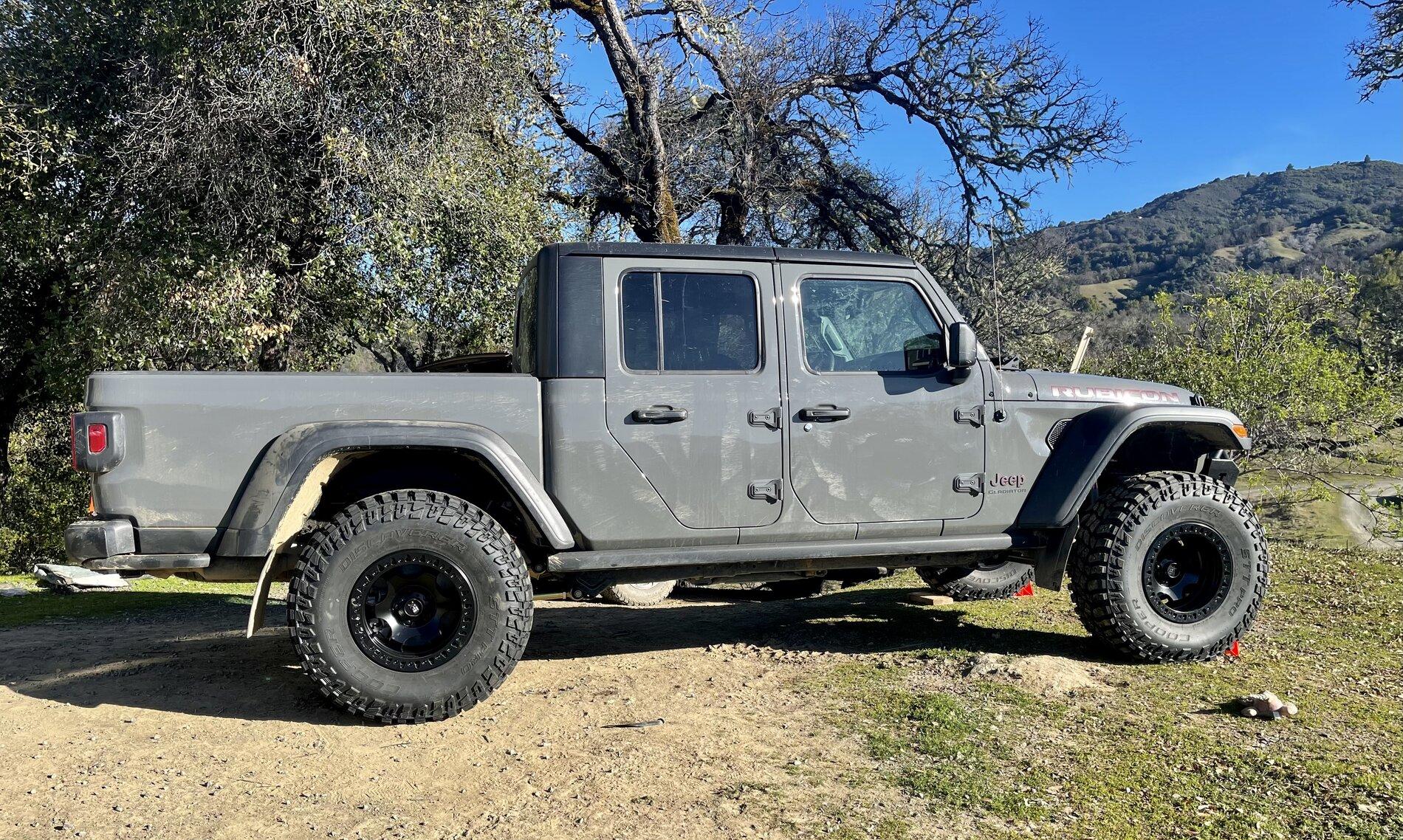

Finally got the lift and everything in metalcloak 3.5ā€ with a 1ā€ spacer up front and fox 2.5 dscā€™s. 37ā€ stt pros on rg crawl beadlocks. I havenā€™t been to town to perfectly level ground but I think itā€™s sitting pretty level. I havenā€™t driven it much yet but if rides really nice so far good bye easy bottoming out stock suspension!!! I will update more pics n info later.
Jeep Gladiator Eco Diesel lift 13188BB8-356D-46A1-9E3B-AC24DC7AA3DA
This looks great. I have the MC 3.5 gc on my JT diesel and just went to a jeep event this weekend. I have 37 and there is about 1.5 inch between the bumpstops. Bottomed out alot. MC said they were releasing diesel springs in about a month or two. I am thinking about adding a spacer in the front like you did though. I ran all of the advanced trails that wranglers did. Only slid on the rock sliders a handful of times but you learn how to drive it and when to power. However, I think another inch in the springs could alleviate this problem. Let me know your thoughts...
I got the 1.5ā€ teraflex leveling kit for $99 and it comes w a 1ā€ spacer and a .5ā€ spacer I just put the 1ā€ spacer on top. I am running 4ā€ of bump stop in the front due to my shocks I have the 2.5ā€ fox resi dsc...
in retrospect I kinda wish I had gotten the 6 pak for extra up travel but Iā€™m not complaining. I live on 6 miles of gravel. I will report back tonight on if Iā€™m bottoming out at all and try to get a picture on level ground so you can see how it looks w the 1ā€ spacer

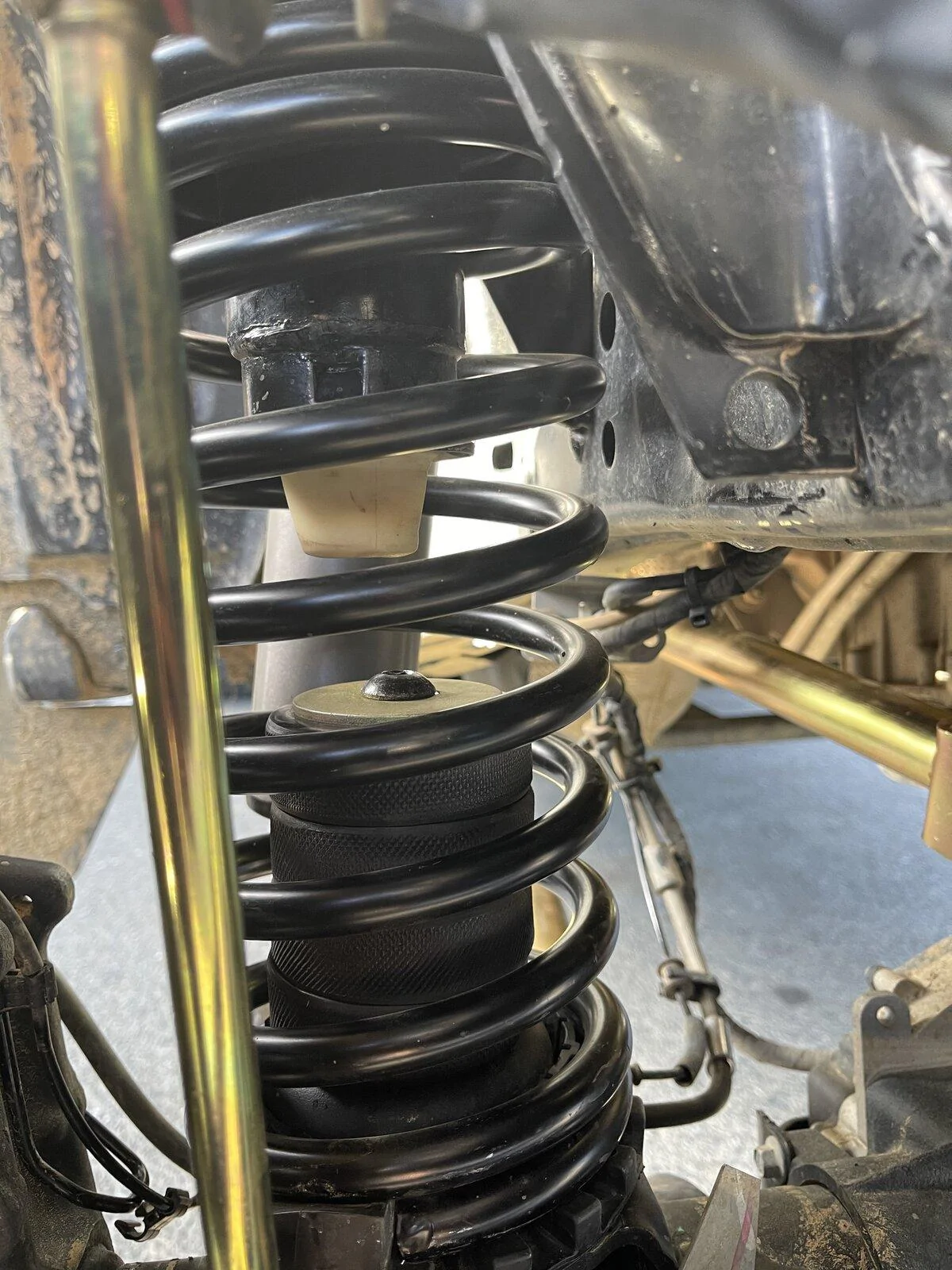

can you also get a close up photo of the front MC springs while you are on level ground. I am curious to see how much the front springs look compressed with the weight of the diesel
Yeah I will here is with it in a parking lot looks pretty level maybe even a hint of rake. Didnā€™t bottom out on my road at all. The stock suspension would bottom out on everything!!
