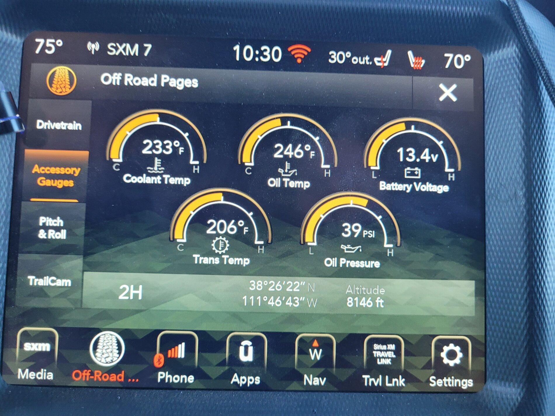

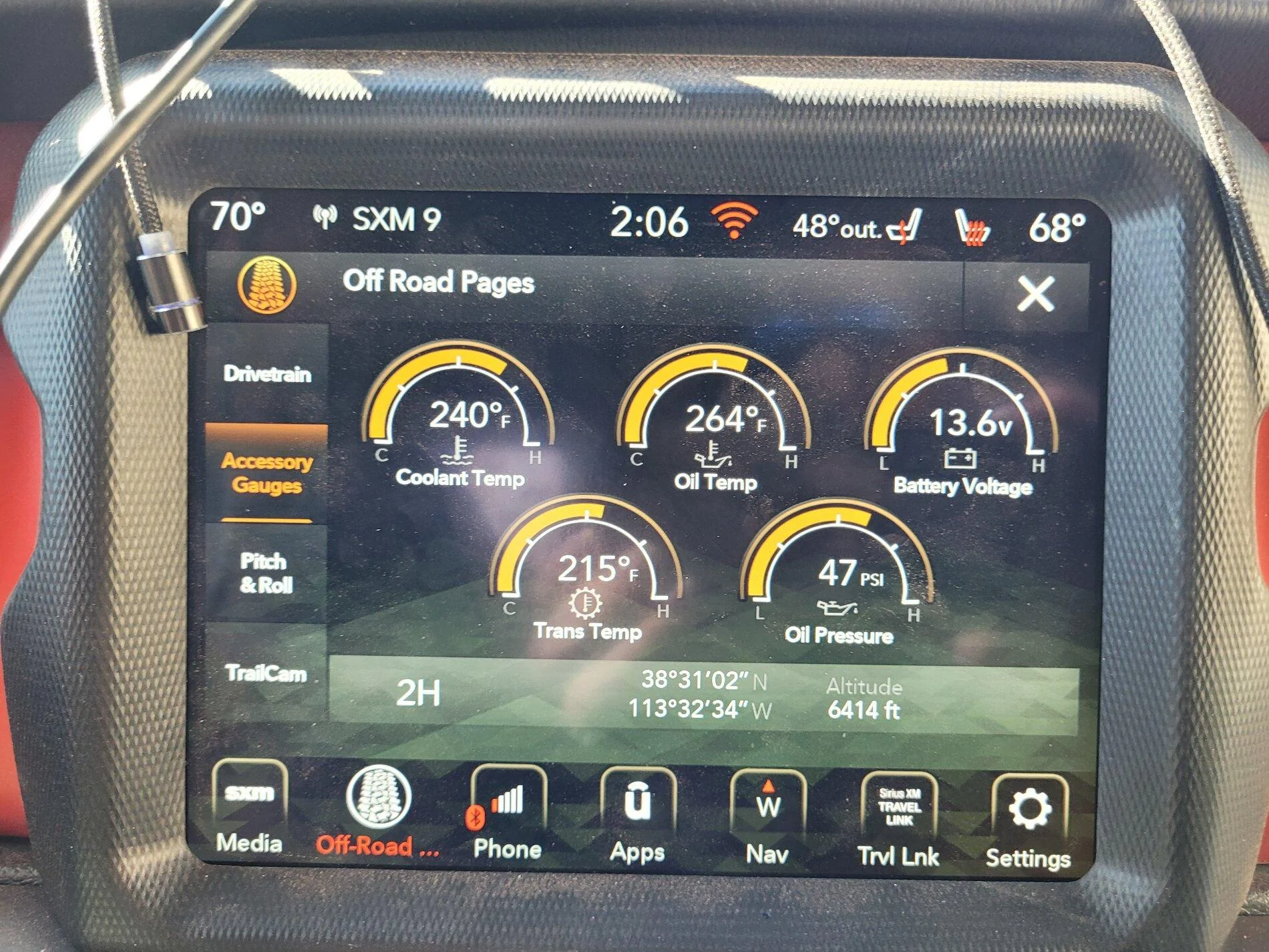

If you note he ambient temps in these pics.....could you agree the cooling system is undersized? Nothing is in danger of exploding, but the temps are much higher than any other vehicle I've operated in the past 30 years. 30° ambient would think it could keep anything cool.
Forgive me if you already stated, but what was your situation in these pics? Lift, Tire size, Towing how much and how much in cabin? I see the 2kft difference and 18* temp difference.

Those are high temps for the ambient air temp - but to say that it's all cooling system being undersized is suggesting that EVERYONE will have the same issue.
IS that the case? Does every ecodiesel JT owner have this same issue?
If some are towing at 90+ degrees on hills with no problem could suggest there's other things at play as well.....
By the same token, saying "it works fine" when the outside temp is only 70 also doesn't prove it's fine because it should also work like that at 90.
I think what we do out here on the west coast is much harder on things than what most are doing elsewhere in the country. Sure the highway system has 6% grades all over the country, but most of the ones leaving my city toward the mountains are 9% and our temps regularly go over 110° during the summer. Many of the smaller county roads heading up to where we go camping are more than 9%.
I think Jeep sized the cooling system just large enough to pass the J2807 towing test which it seems to do........Maybe that's all that could be done with what they were working with. I just don't think climbing 40mph on an interstate where the speed limit is 65-80mph is really all that safe.
The numbers I'm seeing thrown around here under similar conditions are right inline with mine.
I was towing a 7x17 ultra light travel trailer weighing in right around 4K wet, 2 people in the cab, 150lb in the bed, with 37" tires 2"/.75" lift. I was traveling in central Utah in hilly country last week at the time of these pics during a 4300 mile SW National Parks tour. Every time we hit a good hill, my wife would grab the pbone to snap an pic as we crested the summit.
If you read this thread from the begining, you will see where I tow tested about 16 hours apart with the same trailer and road but with the stock tires. The results were pretty close to the same, but the ambient temp was a few degrees cooler.
