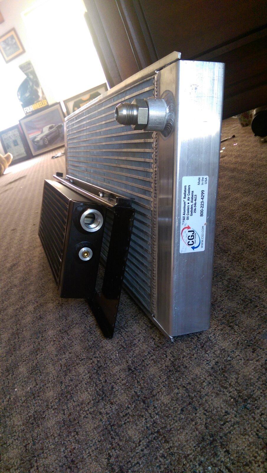

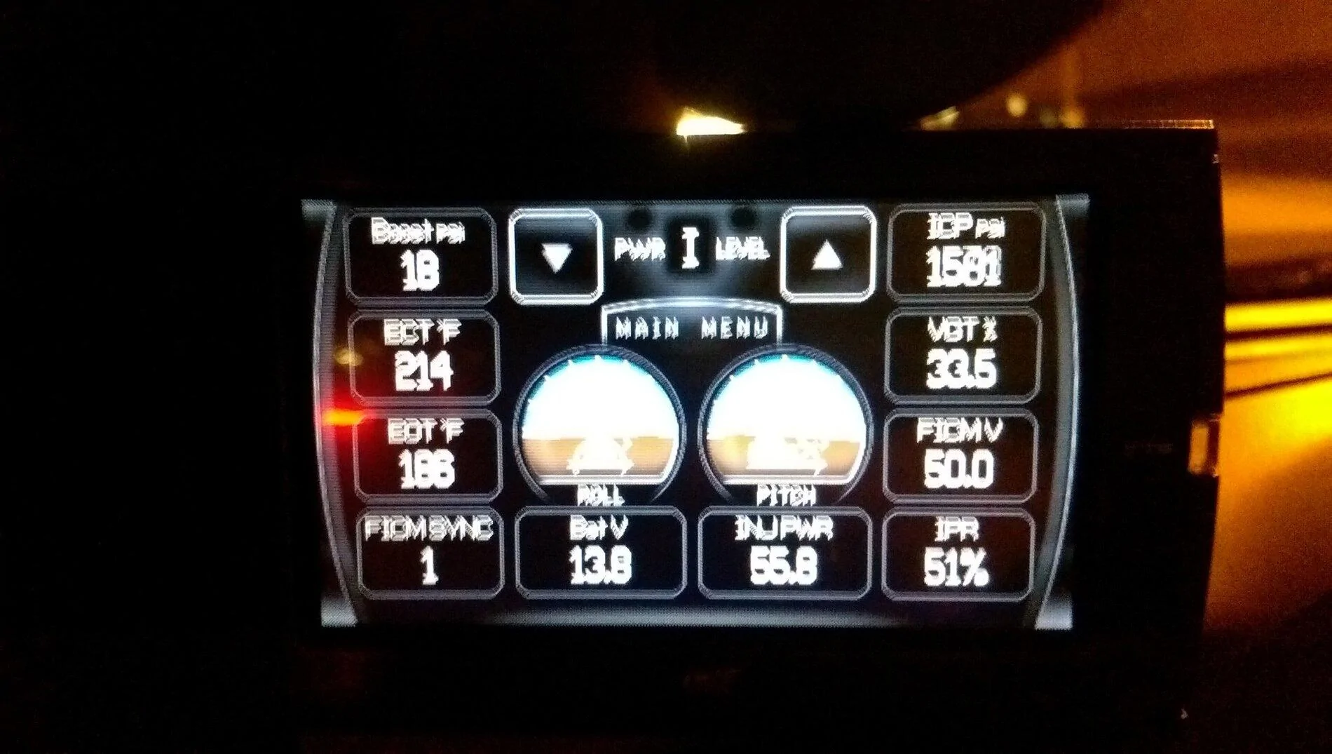

Tortuga41
Matthew
Aug 26, 2023
Arizona
2021 Jeep Gladiator Rubicon
If I was to be using my Gladiator for towing and hauling I want a setup where my oil temps are always below my coolant temps like this. That way I know 100% if my oil cooling system or engine cooling system is having issues or needs attention.
Note** this is on an extreme setup of a 500 rwhp truck that is used to haul and tow daily throughout the Western US. So I had a custom cooler made with 3x the volume over the BulletProof unit.
How has this setup worked for you?
