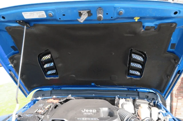

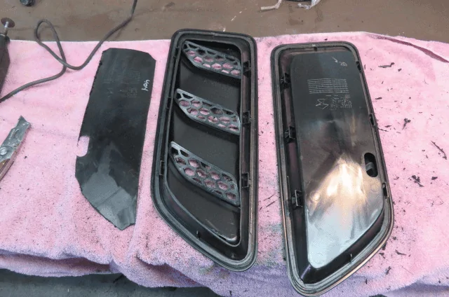

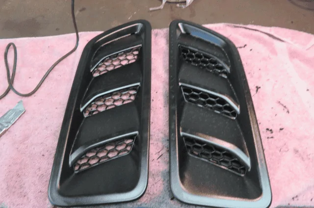

This is how I did mine.

I cut my Rubi hood vents open last summer. Never had any trouble with rain or snow.

I park outside, but I am in the desert so not tons of water around here. I also don't park under a tree. It's been 1.5 years and haven't had a problem yet.
People around here have been venting jeep hoods as long as there have been jeeps.

I park outside. I'm in the south west corner of PA. Lots of rain and snow.

I park outside and live in the Valley - So Cal with pretty serious heat in the summer. This year we had an atypical amount of rain. Zero issues with water or debris. Been about a year that they have been cut open.
