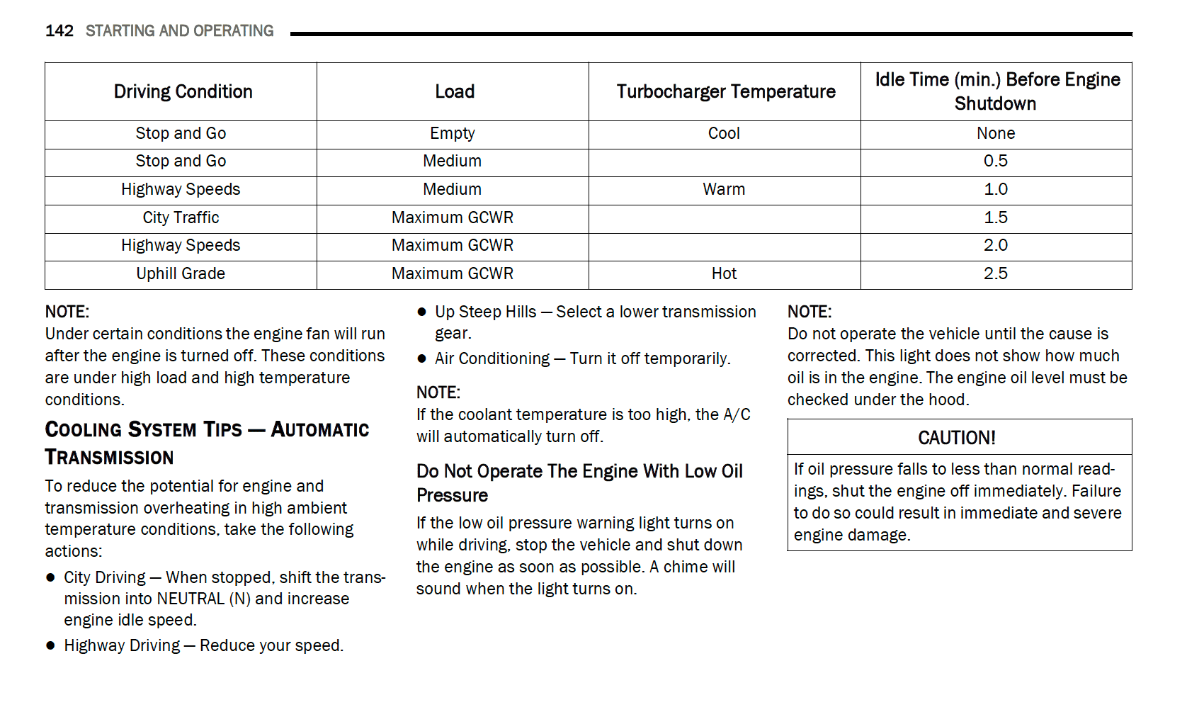

Also, found this:
Jeep Gladiator Ecodiesel power derating as temps rise? 1691431979902
I'll let it cooldown after long trips from now on.

Also, found this:
I haven't, I'll definitely check it out! Thank you?
11,396
30,398
On any turbocharged vehicle. It's best to let it idle for a minute or 2 before shut down. This lets the turbine wheel come down from high speed. Revving the engine up, then shutting down is one of the worst things you can do. You just increased the turbine wheel speed, and shut off it's oil supply.
