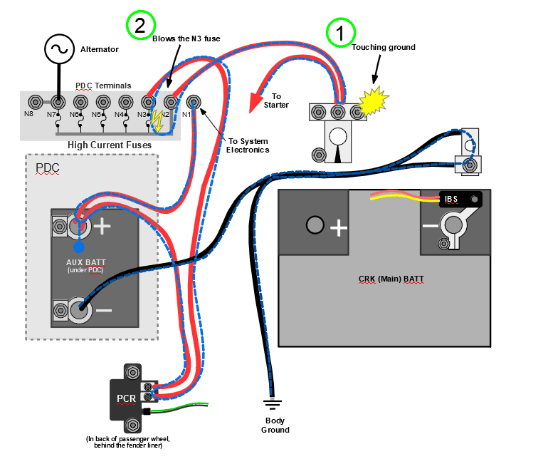

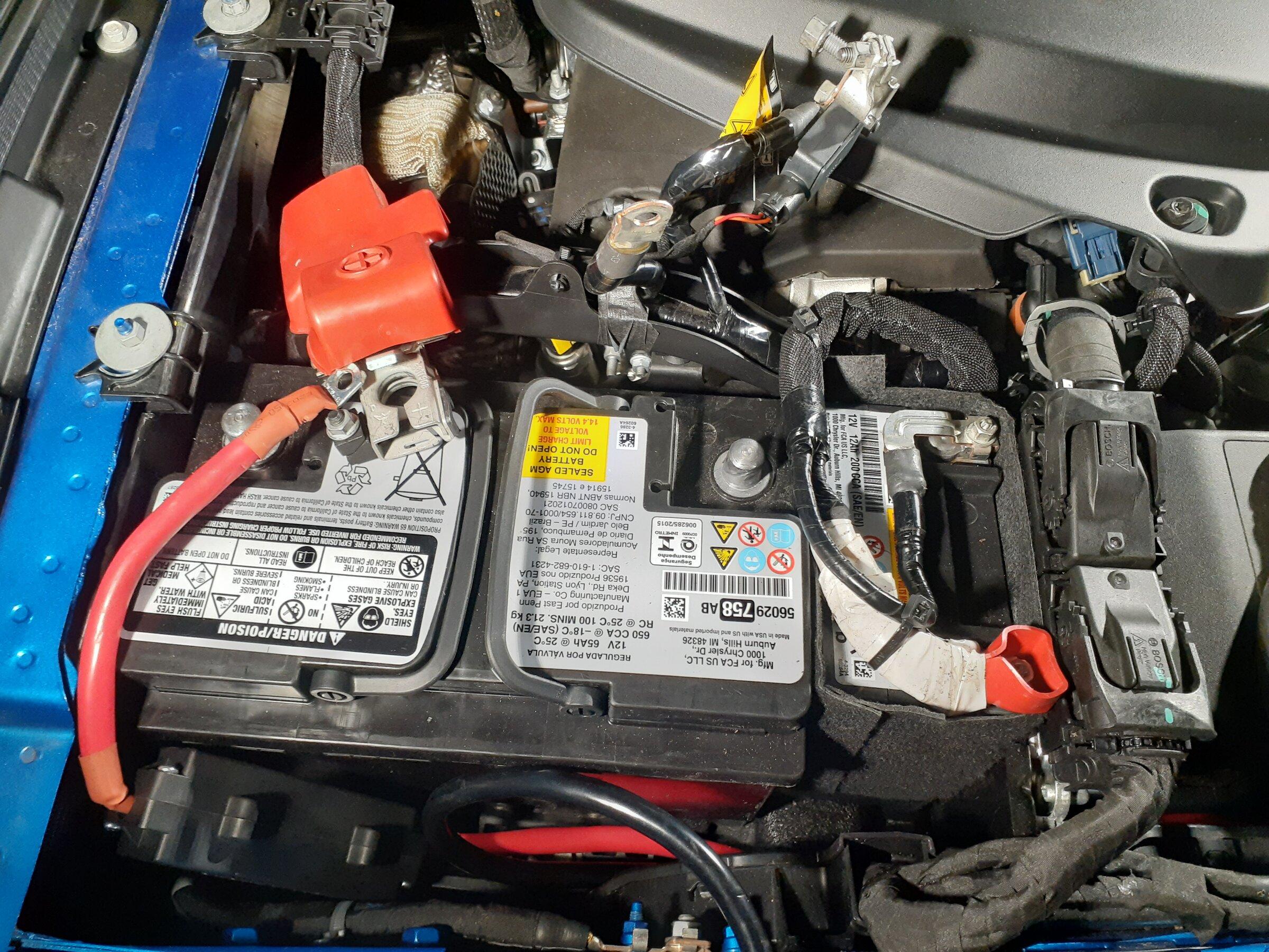

Okay, so I decided to relocate the auxillary battery next to the main by cheating the main closer to the firewall which makes just enough room.
The problem I'm having is a spark when I go to connect the loose ground that attaches to the negative post.
Is there that much draw just sitting there? It does it whether the aux battery is wired or not.
I only disconnected the terminals from both batteries, rerouted the auxillary leads to the new location, and now I have this spark that's a bit disconcerting.
Since you've already rerouted the aux battery leads, just connect the aux battery positive lead to the main battery positive and remove the aux battery. This is how the Genesis dual battery system works, it uses a single battery for the main and aux battery and the second battery is for accessories.
It is best to disable ESS and not run it off of one battery, although it will work 6 times before it disables itself.

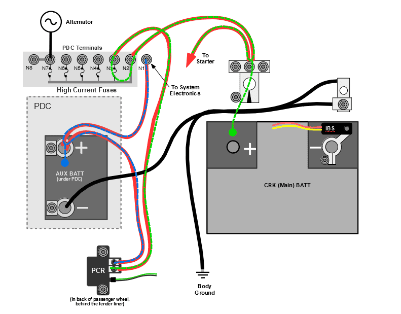

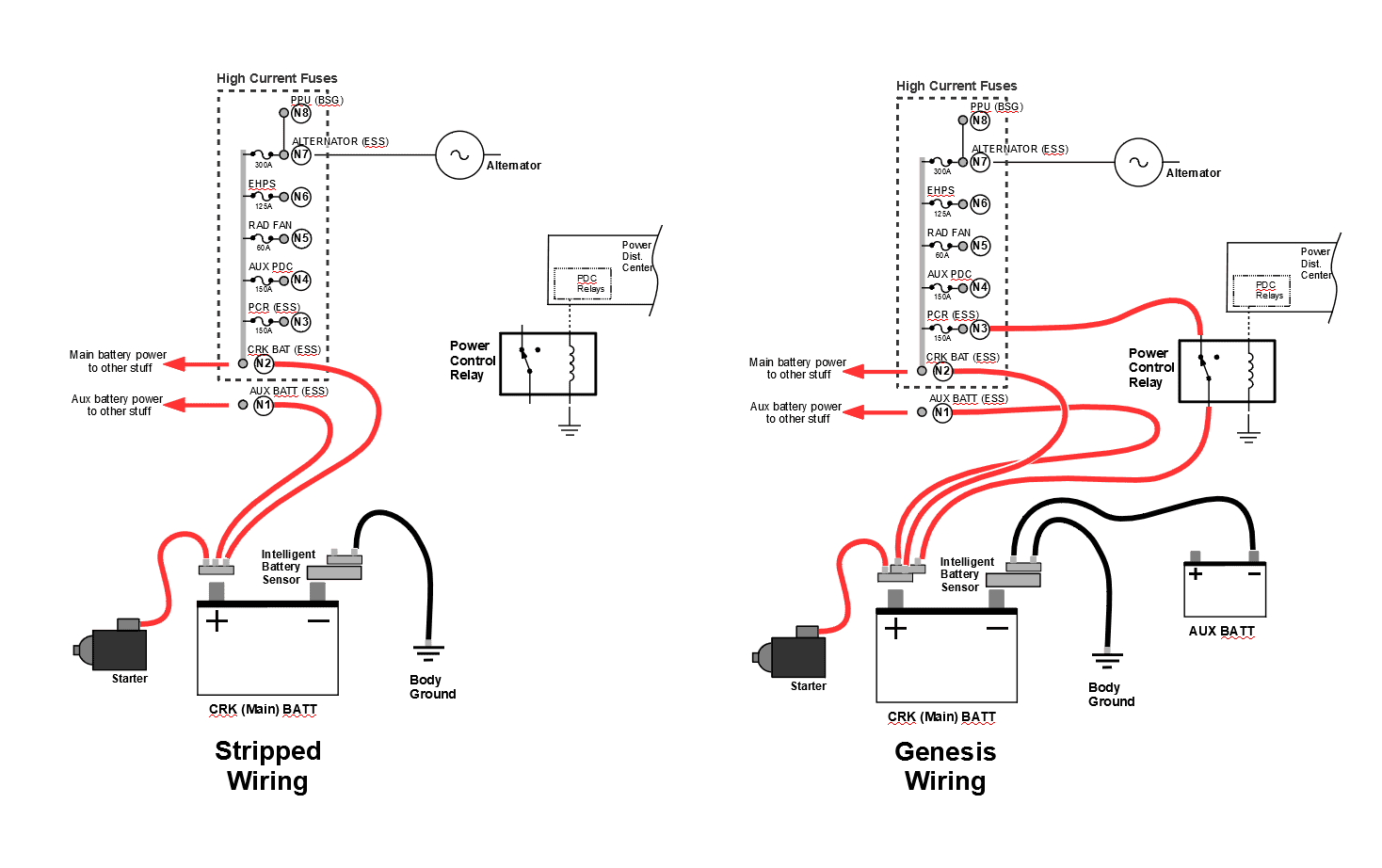

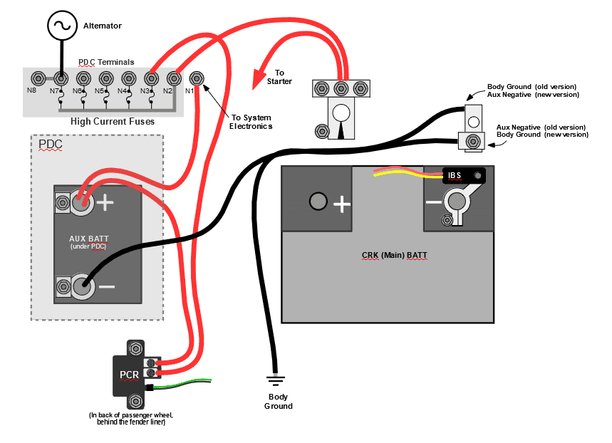

Here's a diagram that shows the Genesis wiring and the Genesis wiring with the redundant wires removed.

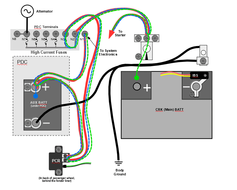

I don't use ESS.
Okay so run a jumper from main battery to N1, remove the hot and negative leads on the auxiliary. How do you isolate the PCR? Undo the plug at the module but where is the other end, and what codes may be thrown once disconnected?

I don't use ESS.
If you unplug the PCR, you don't need the jumper and if you use the jumper, you don't need to unplug the PCR. Either one provides uninterrupted main battery power to the system electronics. I haven't tried it, but no one that has unplugged the PCR has ever reported getting errors.
I typically like to phase in changes one at a time so if anything goes wrong, there's only one change to investigate. From where you are now, I would connect the aux battery positive cable to the main battery positive and run that way for a while. If everything is good, then clean up the cables if you want.
