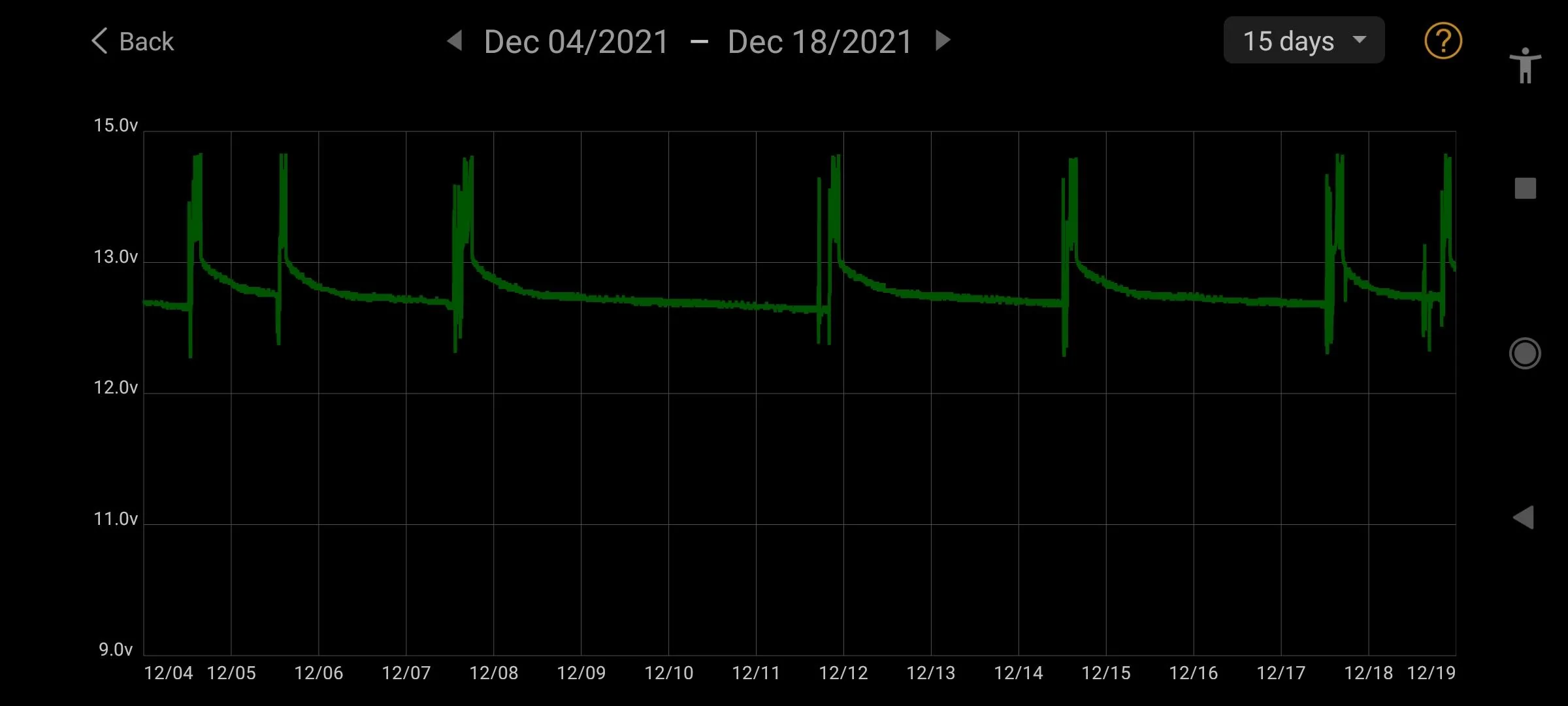

I'm not currently experiencing any problems. I have installed an Anderson socket in my Passengers side ww and connect a 4A maintainer (main battery) when parked as I don't drive every day and am paranoid about battery failure. For reference, attached is a screen shot from my (main battery) battery monitor (https://www.aliexpress.com/item/32794632957.html?spm=a2g0s.9042311.0.0.27424c4de30JVC) for the past 2 weeks.
Jeep Gladiator ESS Dual Battery System Operation Screenshot_2021-12-20-09-46-22-691_com.dc.battery.monitor2
Good information. I assume the longer "flatter" portions are when it is not being driven and showing normal voltage drop.
Side note: notice you are driving an altitude edition by are in FL.....just thought that was funny.
Correct, the spikes are the days when I drive, flat parts sitting in the garage. Sure, zero Altitude ?. I like the factory murdered look.

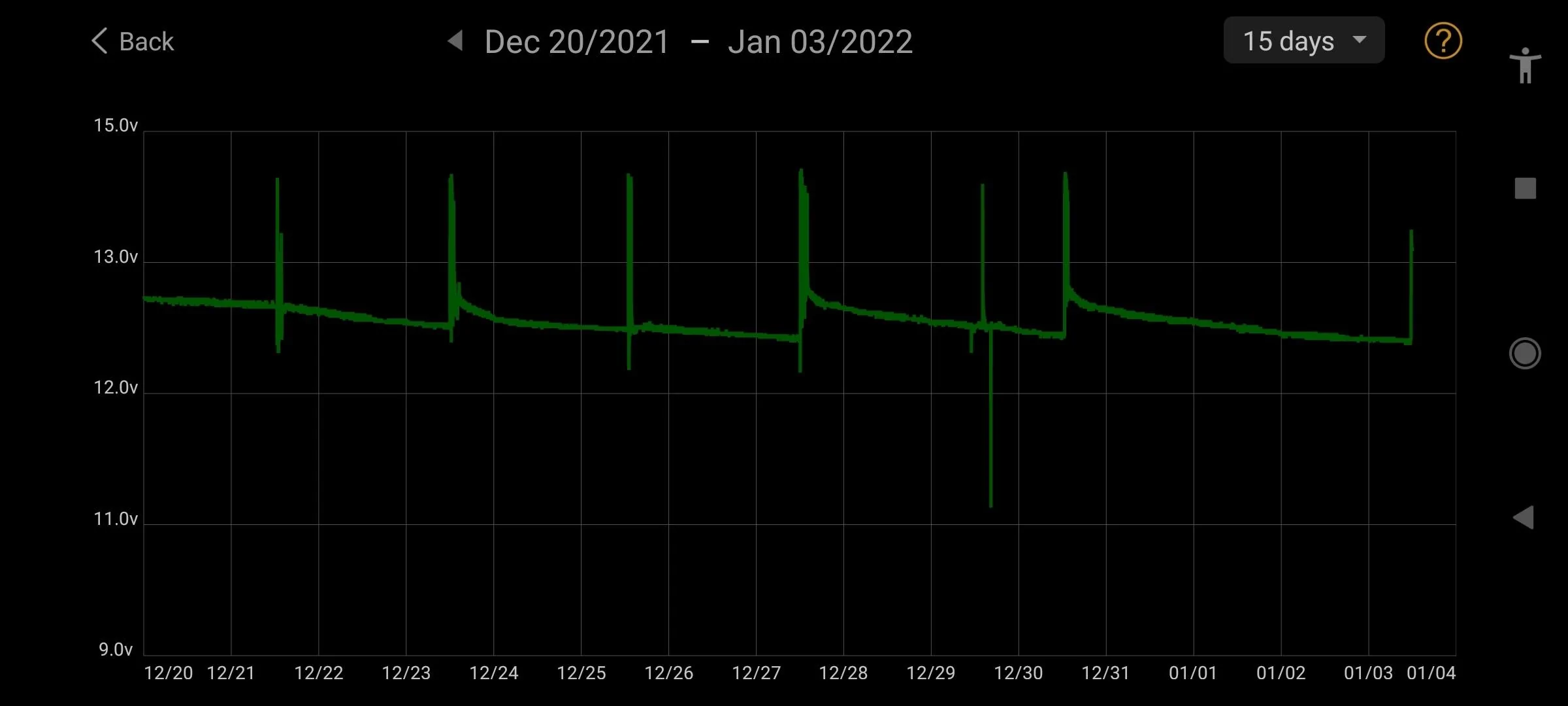

Is this graph with the battery maintainer on and running when you park it? Do you mind posting a graph without the maintainer? I suspect after 2-3 week of no vehicle use the voltage would be below 12.0V.
Yes, that graph was with engine off maintainer on. Below is maintainer off for 2 weeks, as you can see, there is a gradual creep downward despite several driving events. It would be interesting to see the data from a true 'daily driver'.
Jeep Gladiator ESS Dual Battery System Operation Screenshot_2022-01-03-11-57-17-902_com.dc.battery.monitor2[1]
