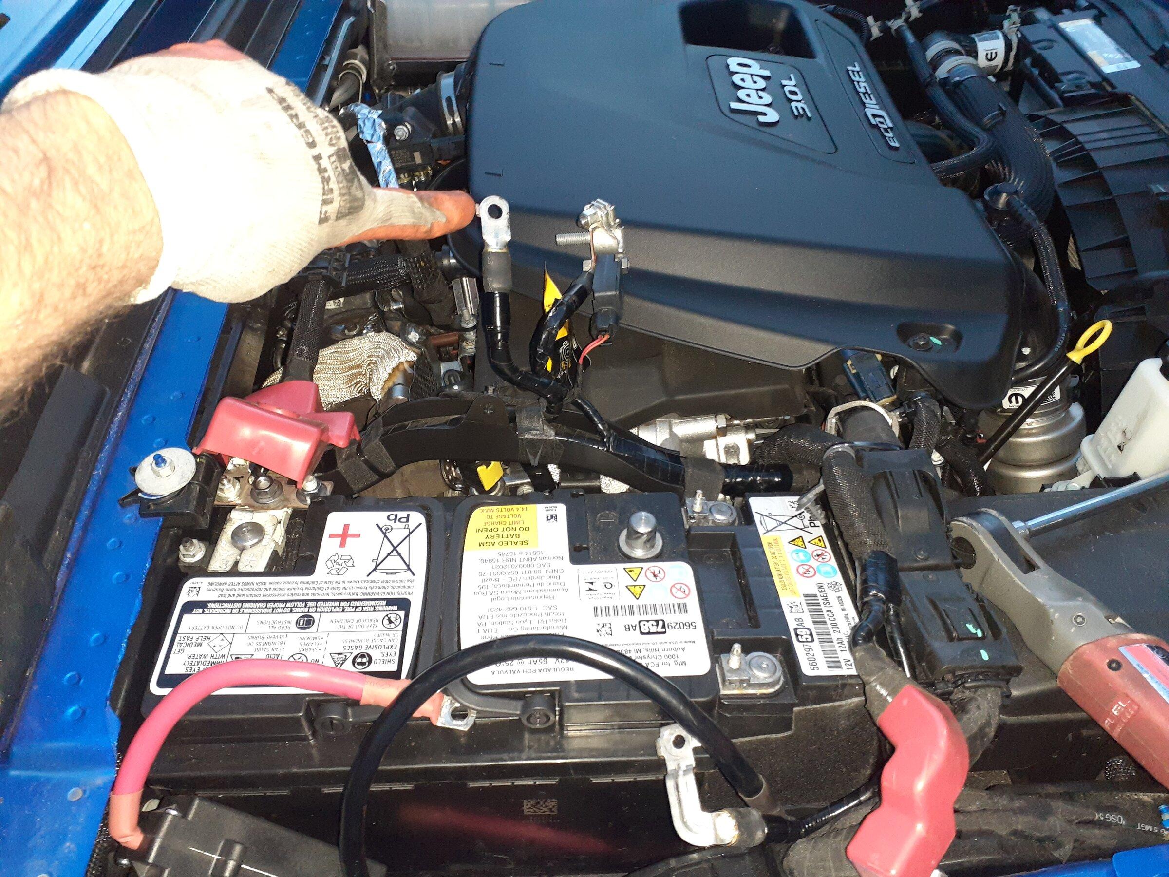

Okay, so I decided to relocate the auxillary battery next to the main by cheating it closer to the firewall and it makes just enough room.
The problem I'm having is a spark when I go to connect the loose ground that attaches to the negative post.
Is there that much draw just sitting there? It does it whether the aux battery is wired or not.
It is possibly normal, with the diesel, since it is powering up the computers and the heaters all at once.
Should I check the negative for voltage before connecting it?
If it's just a minor spark when attaching the cable, I wouldn't worry about it. If it's major sparking, like a short, then I would carefully check all the cabling and connection points.

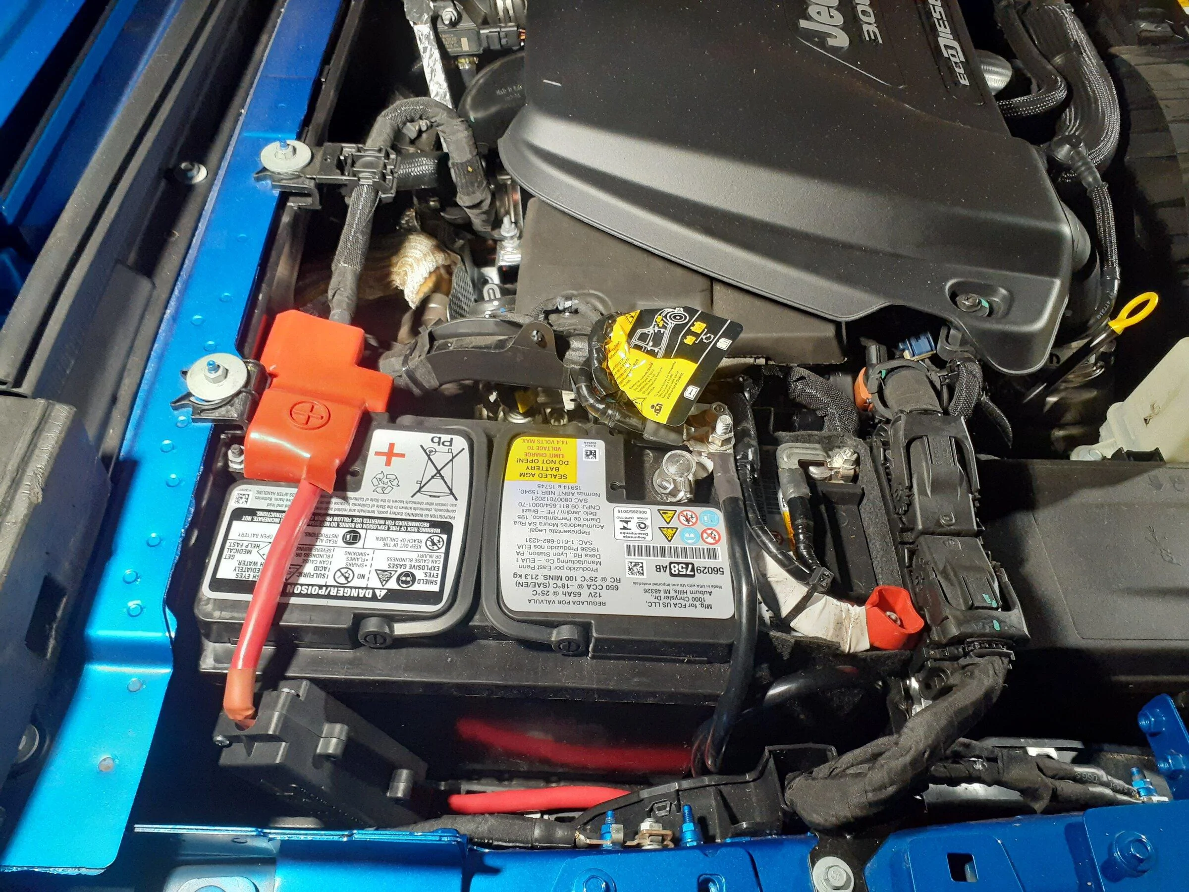

The big chicken got out the voltmeter and everything checked out as it should so I hooked it up and all is good!
I'm going to look at doing this with mine, if I can't get them replaced under warranty. My batteries are getting close to three years old, and won't likely last another summer.
Apparently you can put AGM batteries on their side. I considered opening up the back of the pocket the auxiliary battery sat in and make a little angle bracket to bear all its weight but when I pulled the leads out it seemed everything would fall in place this way, but it's something to consider.
