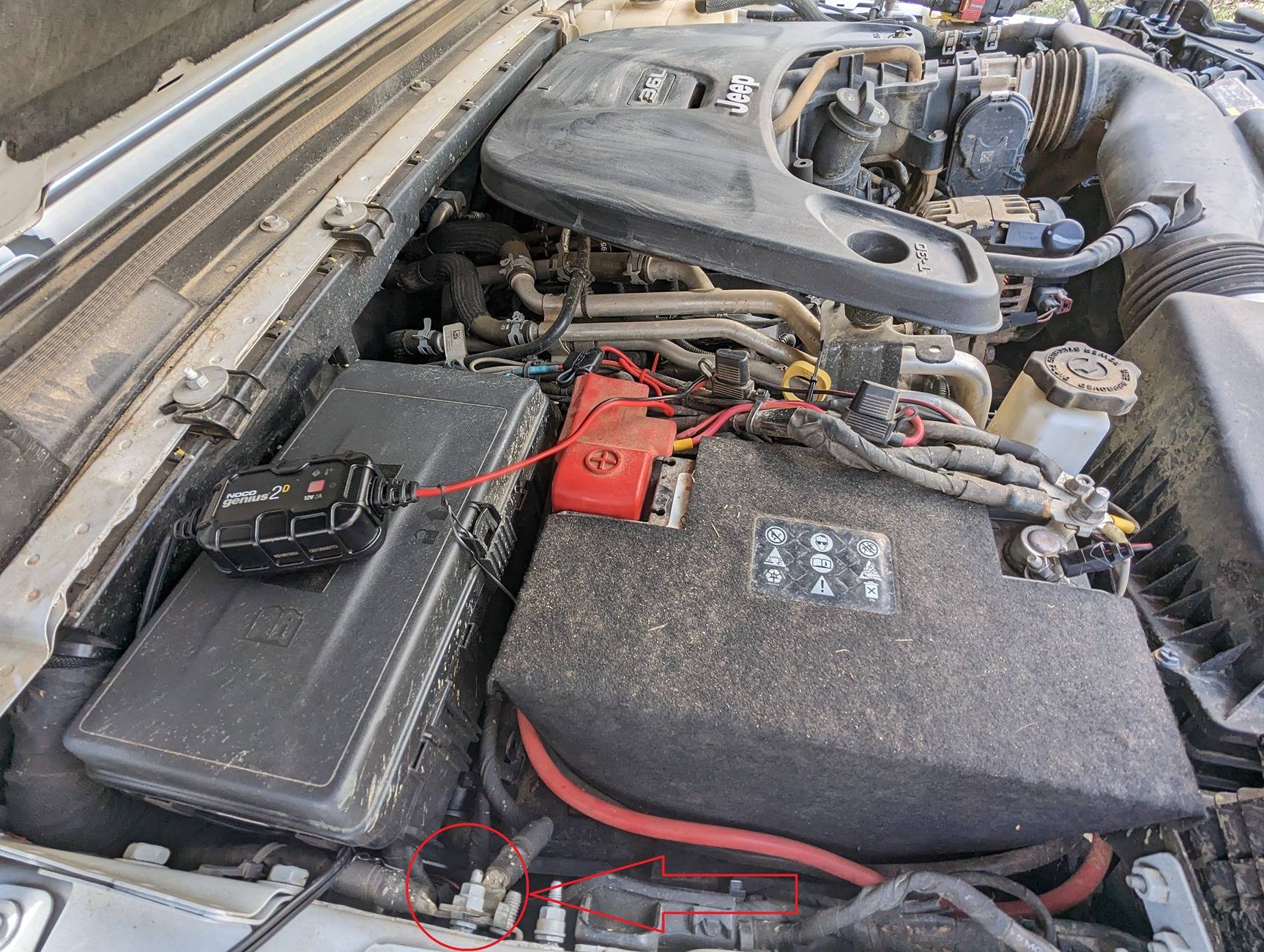

You can ground it here.
Yes, and my BatteryMinders have a lead disconnect so you can leave the leads connected there, but disconnect the charger when not in use (driving, etc.)
Then when you want to charge, just reconnect the leads to the charger.
I like my method (I never have to open the hood), but this is a good alternative depending on your charger and needs and situation.
that's the ideal ground spot.

So one more question Folks if you don't mind, in the two options to connect the tenders negative lead, both which got many "thumbs-up", post #25 by Lost Wing "above the plate on the batteries negative" (and which I have always used since day 1 with these tenders), and post #28 by jhale1800 "ground bolt on side of engine compartment where fender attaches", is there any reason to believe that if I start using option #2, that it (might) make a difference in getting more longevity (vs only 6-8 weeks) out of my new Ctek tender?
Thanks in advance for any opinions,
-Joseph
-Joseph
I think what ever is most convenient to you. I have a few things going on in the area above the fender ground stud, so that is why I chose the stud above the IBS. It makes no difference electrically.
If you had to draw out a schematic for both install locations, the drawings would be identical.

I have had a NOCO genius 5 for a couple years now. It revived both of my batteries after the Jeep was sitting for 7 months, batteries were at 8 volts. Took 3 days to get them fully charged, but it did its job and the Jeep fired right up. The instructions in the NOCO said to not connect to the negative terminal on the battery, but to use an engine ground. I used the ground located on the side of the vehicle by the battery. That ground can be finicky, I didn't get it to charge at first and figured that the negative wasn't connecting.
Yeah, electrically, the would be the same, assuming tight ground connections
-Joseph
It shouldn't matter. If I remember correctly, my charger instructions said to use body grounding connection instead of going directly to battery. If you don't use the body, make sure you connect it to the Intelligent Battery Sensor (IBS) like others have suggested. Use some dielectric grease on your terminal connections to prevent corrosion and maintain a good connection. If your maintainer isn't keeping up, consider checking for draws in the electrical system by measuring voltage drops across each fuse.

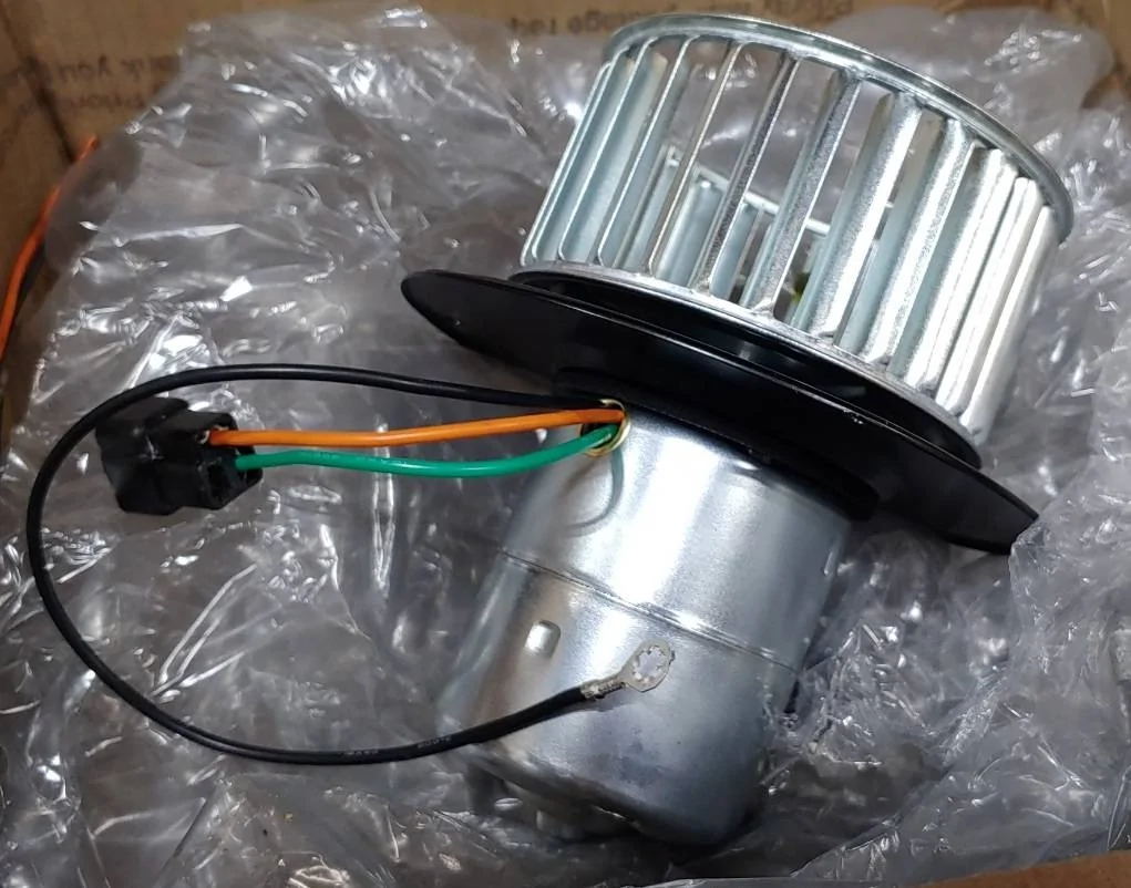

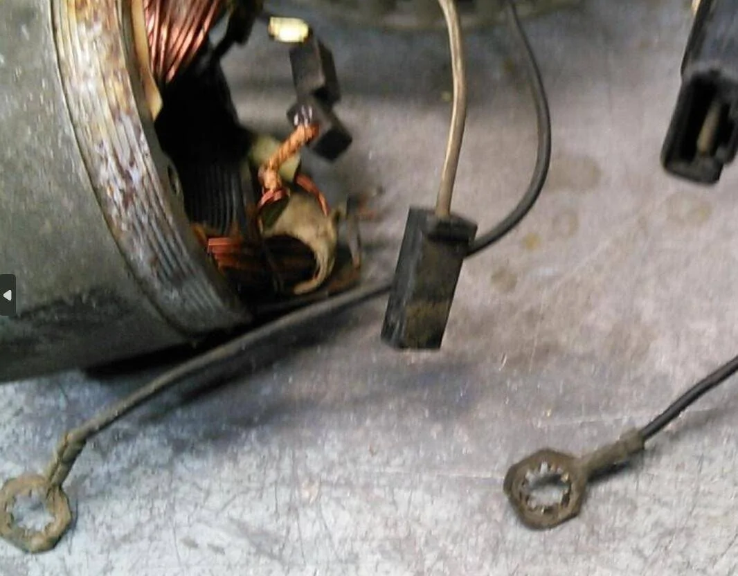

I have a good friend who does a fine job with paint and body work. He paints and clearcoats everything. His projects that call for bare metal (from factory) he sprays them with satin clear to retain a some what of the factory look. He painted firewalls, frames, engine blocks and powersteering and alternator brackets. Needless to say he had all kinds of electrical issues from the start. Now days, after cleaning his metal parts, he installs a bolt and washer wherever there is ground cable or bonding strap. His thinking was once he tightened the bolt, it would conduct electricity. He also found out that when you unplug an electrical connector that has been plugged in for 50 years, it probably will give you problems when reinstalled. He cleans all his connections now.
Thus, the sort of ground connectors found on many vehicles of the past -
This is a blower motor I restored, put the same sort of end on as original (as close as I could buy, anyway)
