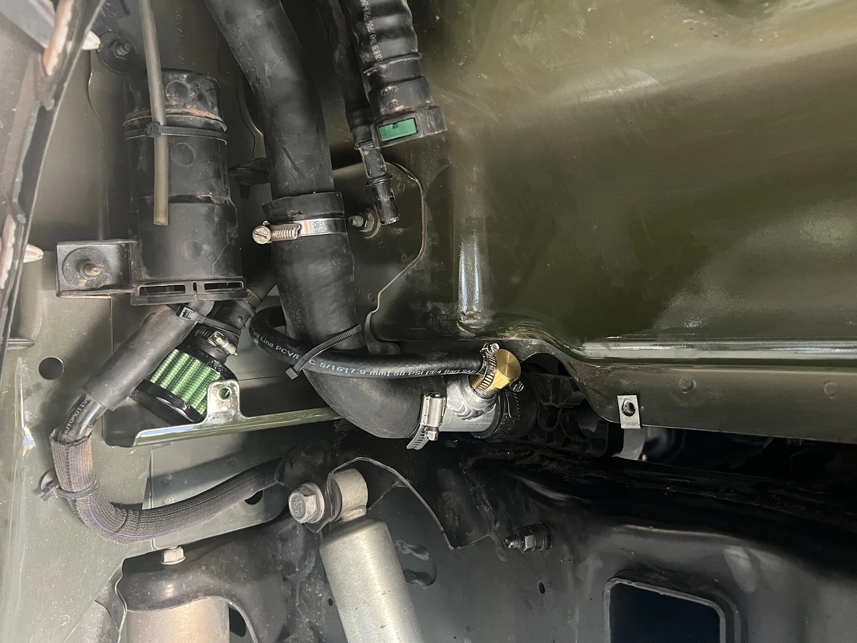

The OEM setup from filler to tank is 1 1/2”. You intercept this with 1 1/2” fuel hose. Filler to top of Aux tank plus hose from bottom of Aux to OEM tank. Gravity feed the OEM tank.
You will also need to add a 3/4 vent fuel hose from top of Aux tank into OEM breather located near the factory fill location. Behind fender liner. Depending on how you off road, you might need to raise the breather location. If the fuel level is above the breather, fuel, not air will come out. You could also add a second breather for the Aux tank
The key for ease of installation is to lay out the 2-1 1/2” and 3/4” nipples in an easy place on the aux tank to run the added hoses.
Finding a complete kit is not easy. DOT requires fuel tanks to be between the frame rails and axles on all passenger vehicles ’06 and up. Gassers have the additional problem of fuel tanks being part of the emissions system.
Including a pic of my Aux tank. Same as described with added fuel filter in Aux tank. In the bed.
Hope this helps.

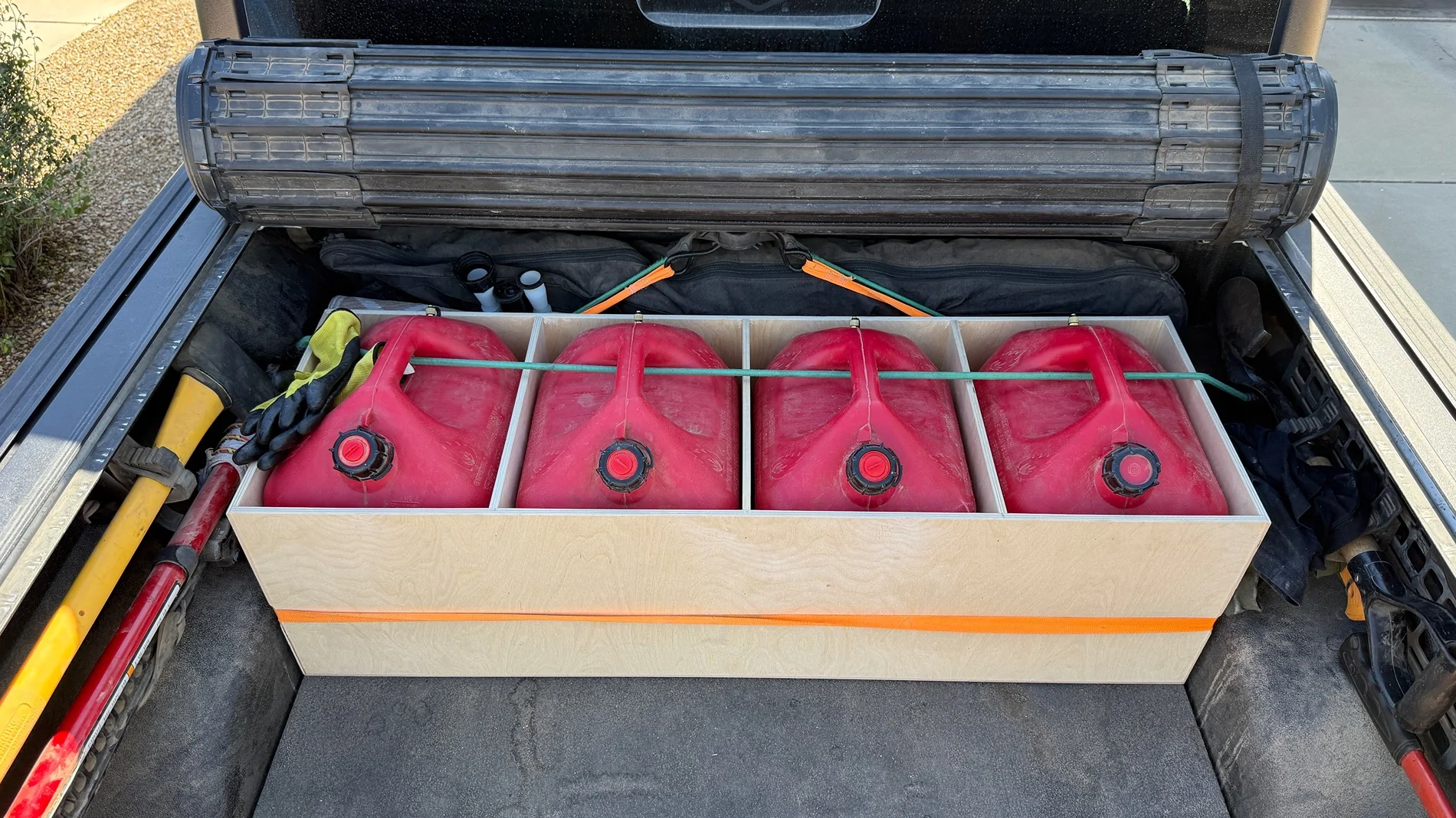

I like that a lot. Here’s my homemade version LOL
I use a ball valve siphon hose so it’s less messy

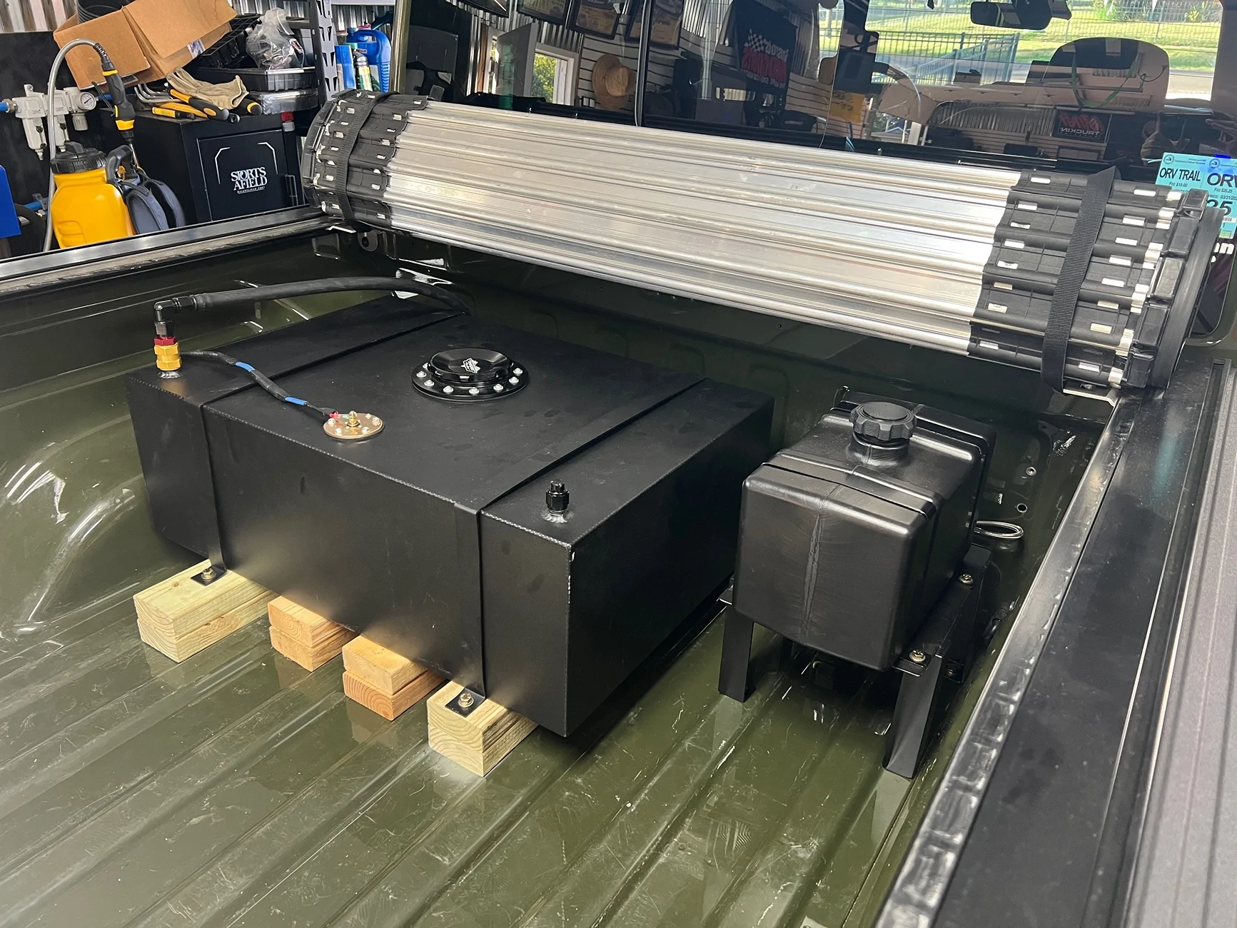

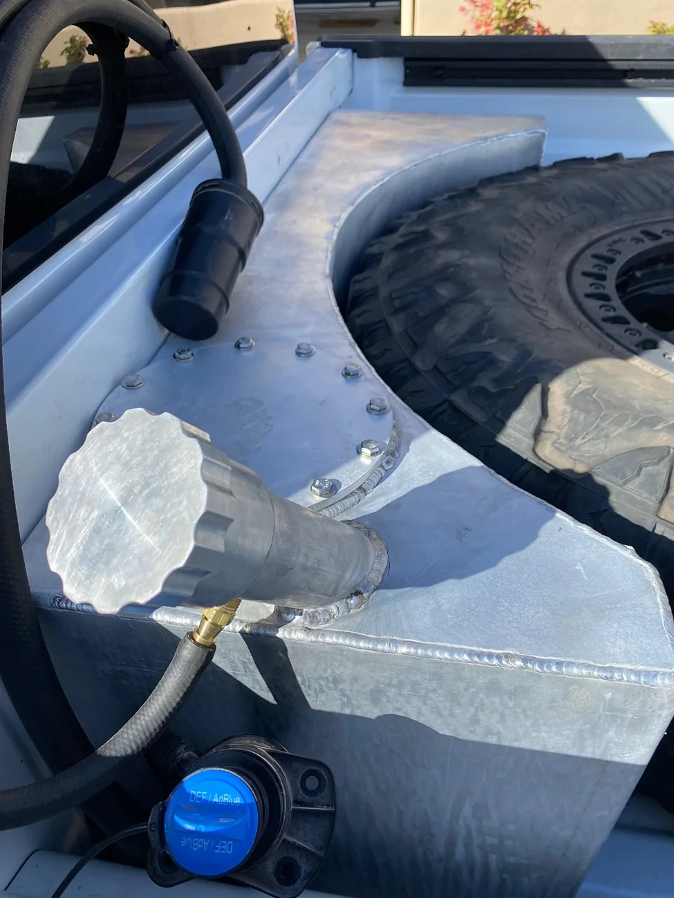

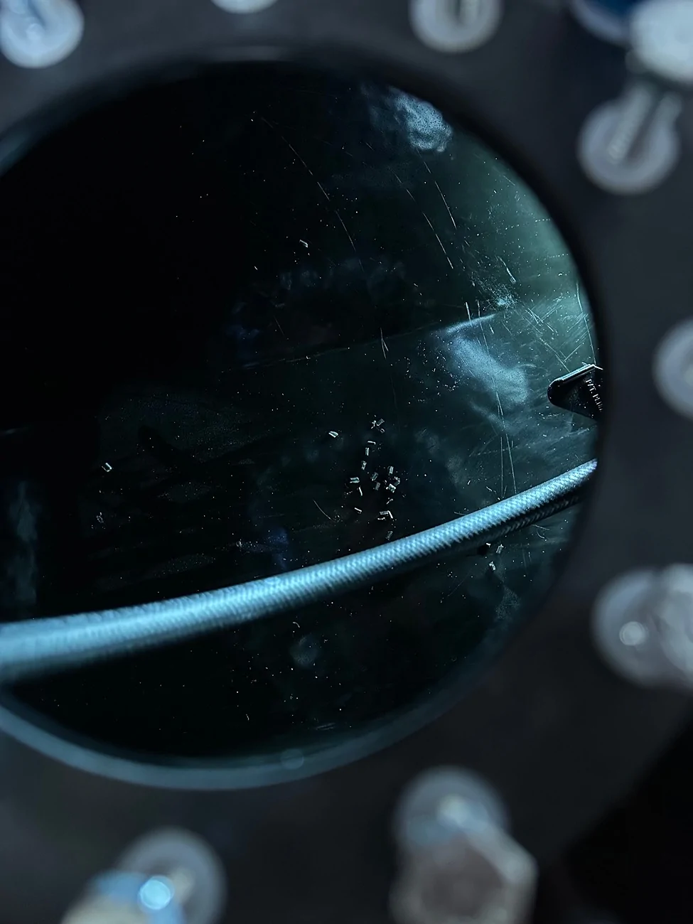

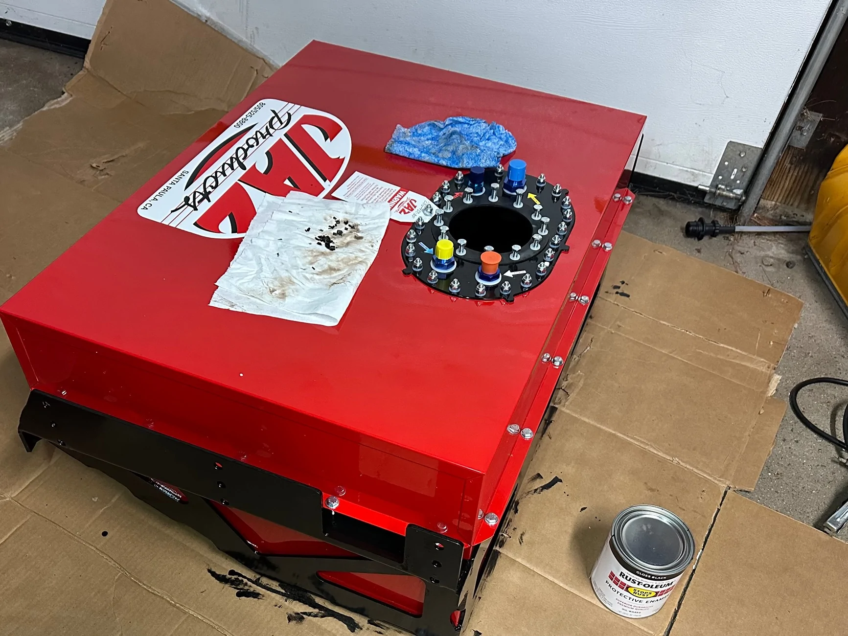

This is my 25 gallon fuel cell setup, just an aluminum fuel cell with a sump, gravity feeds into the filler neck. Uses a rollover prevention valve to an open breather , works great and was around $400 bucks. Takes me about 5 minutes to remove and install.
Jeep Gladiator evo 32 gal fueltank IMG_7108
Jeep Gladiator evo 32 gal fueltank IMG_7046
that's a nice set up, once i figure out if i am getting deck system or not i may simply do a bed tank like this but a custom one that takes up the first 6-8" of the bed to maximize tank and bed space
