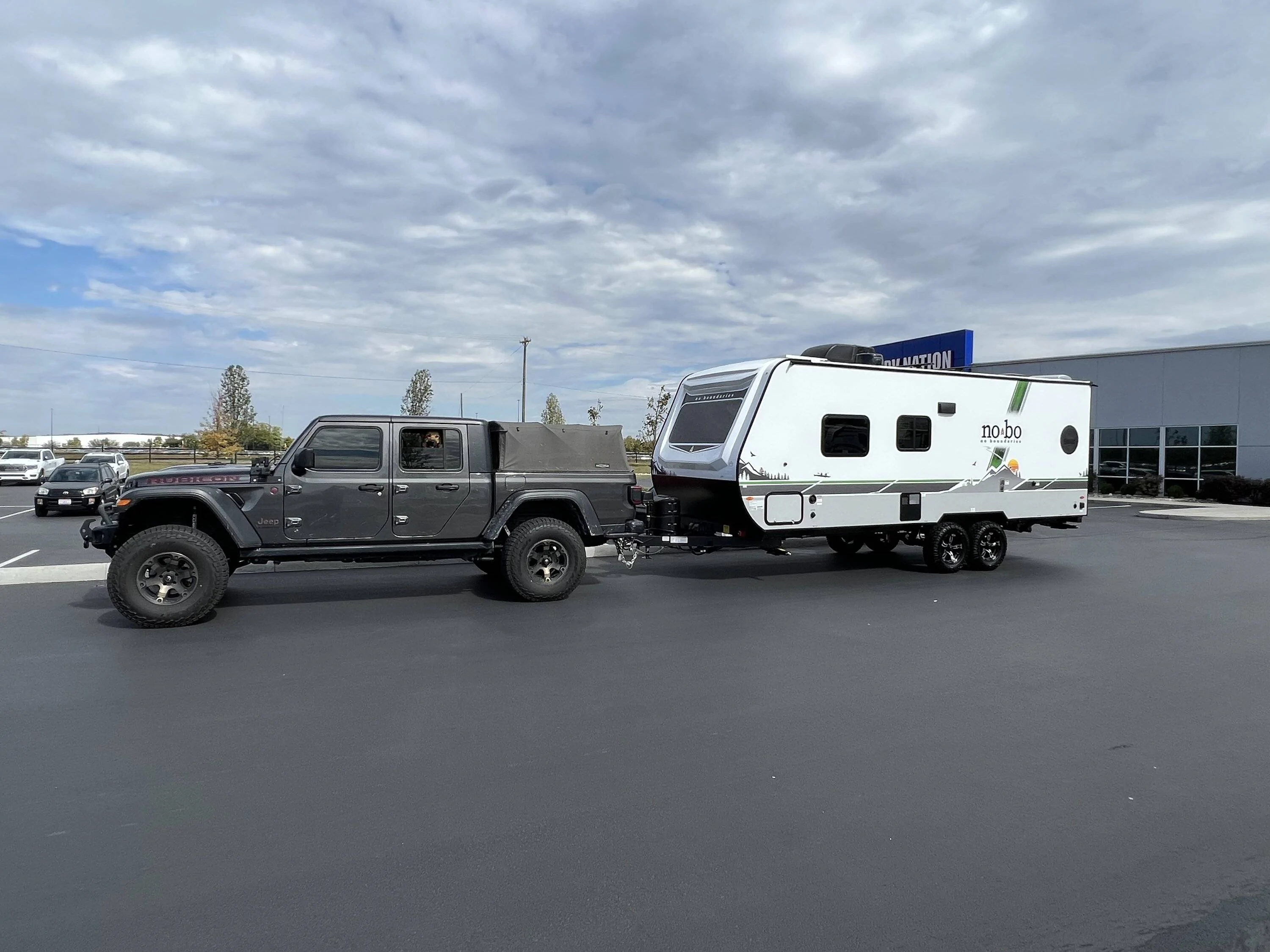

I tow an RPod 189 fully loaded it scales at 3450

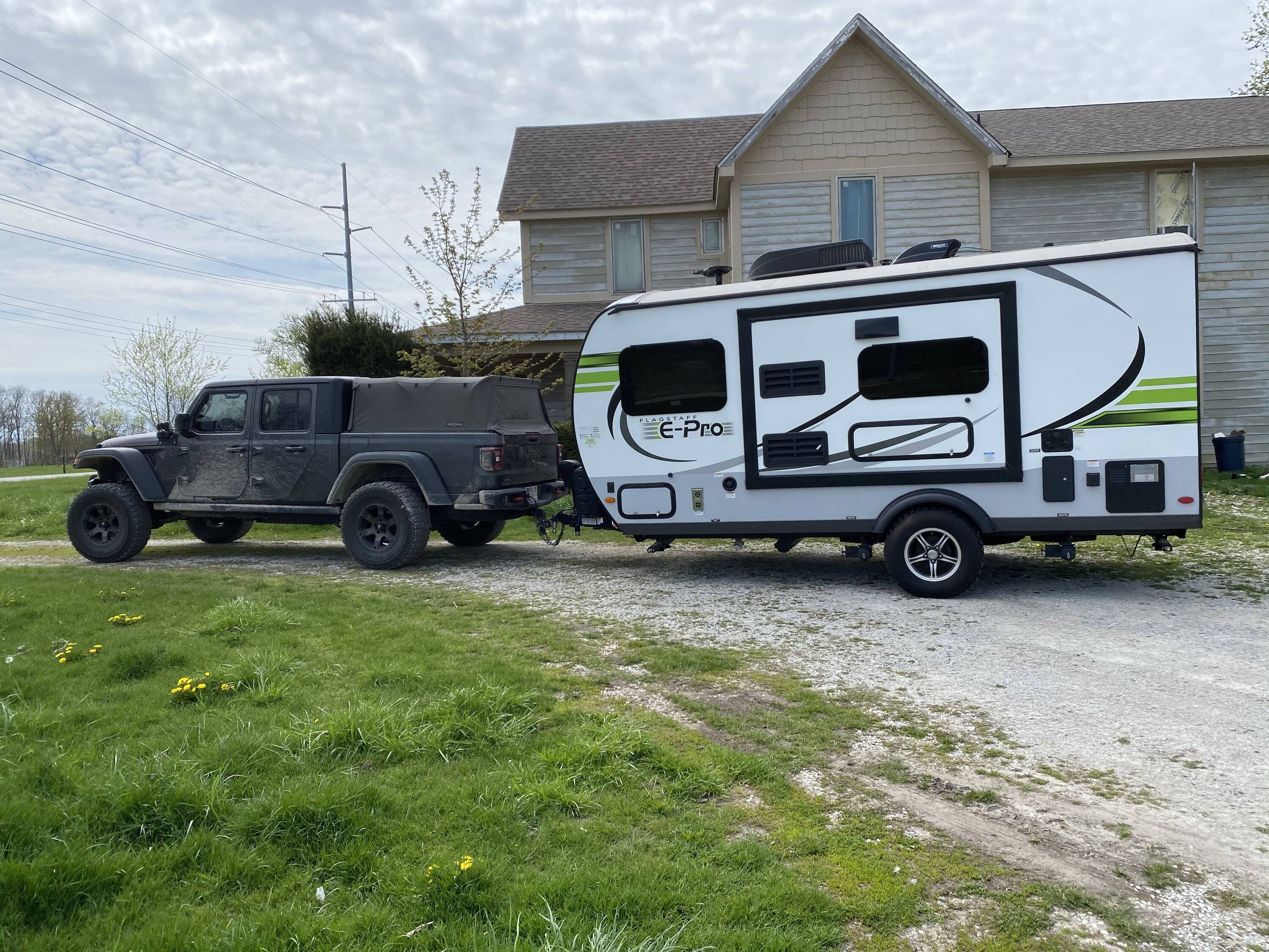

I traded my Willys Gasser after towing my 3000lb a few trips.
The difference with the diesel is night day.
With the gasser I was wringing its neck to keep up with traffic on the highway.
First couple trips with the diesel I would catch myself cruising at 85mph +.
I am still on the stock 33s though.

I pull a ~5000lb Airstream. Great fuel economy (~22mpg) and the rpms are much lower than the gasser at full torque and hp. Set up a weight distribution hitch properly and keep the tongue weight around 500lbs and you'll be happy. Don't expect it to tow or feel like a full size truck.
