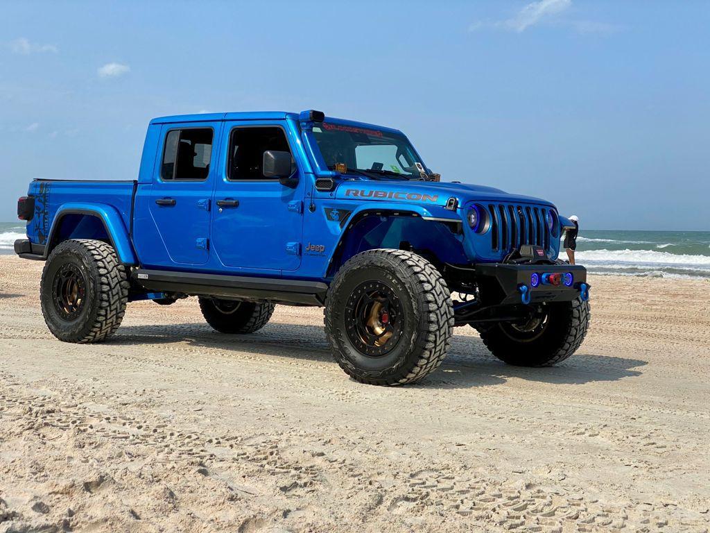

IT LOOKS FANTASTIC! did you go with the premium 3.5 or overland? Also wondering what shock combo you went with?
im on Clayton’s 3.5 with evos front drop brackets. The 3.5 is more like a 4.5 lift.
So you feel the bumps a lot more when your on the trail. It made a huge improvement on the ride.
I went with the overland and i paired it with the fox adjustable 2.0 performance with reservoir in the front and piggyback in the rear. Honestly i would go with the falcon adjustable shocks, if I did it all over again. There's nothing better than a thicker shock. I had the fox 2.5s on my first gladiator and those were amazing shocks.
