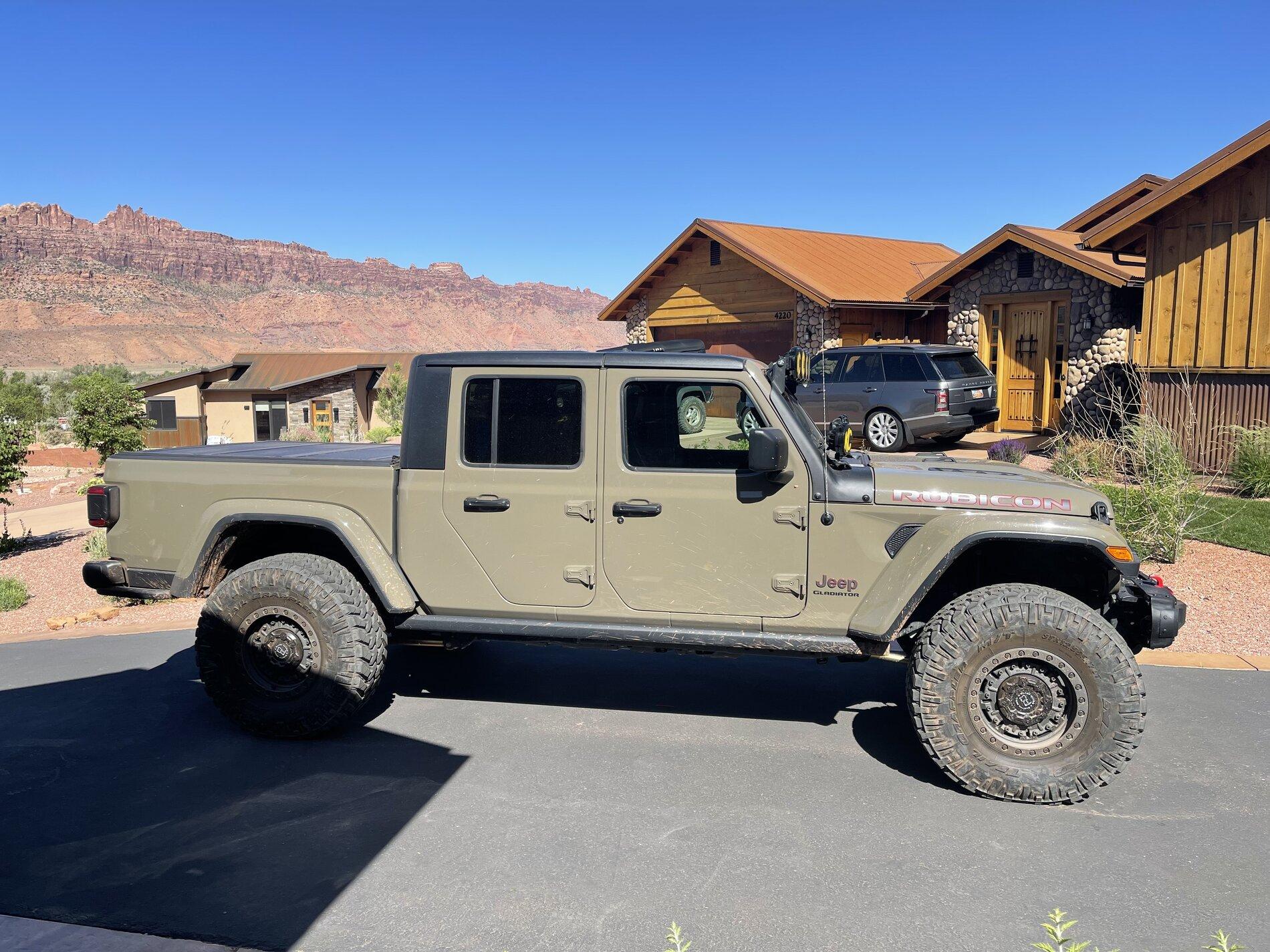

I do. She is a little dirty from the ride…
Jeep Gladiator Metal Cloak vs. Clayton 045129D6-4AD4-4841-B9D4-293856155EF0
