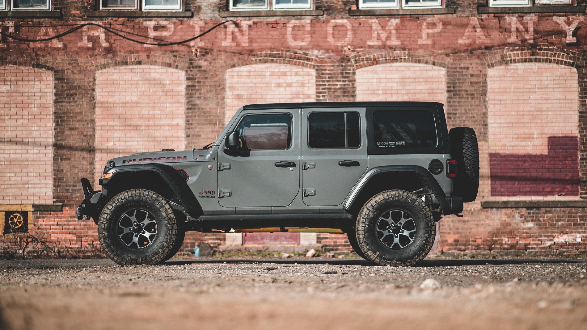

Yeah factory wheels don't work, however our buddy does run our Overland kit with the factory rims and 1.25" wheel spacers! Even with the clearance bends in the arms, the larger tires still rub at full lock, so going with a wheel with more backspacing is required to fix the issue. I'm sure you would have no issue returning wheels that are un-opened!

well that bursts my bubble... There was a ton of space before the LCA's so I didnt figure it would be an issue, but you guys know your product better then I do.
