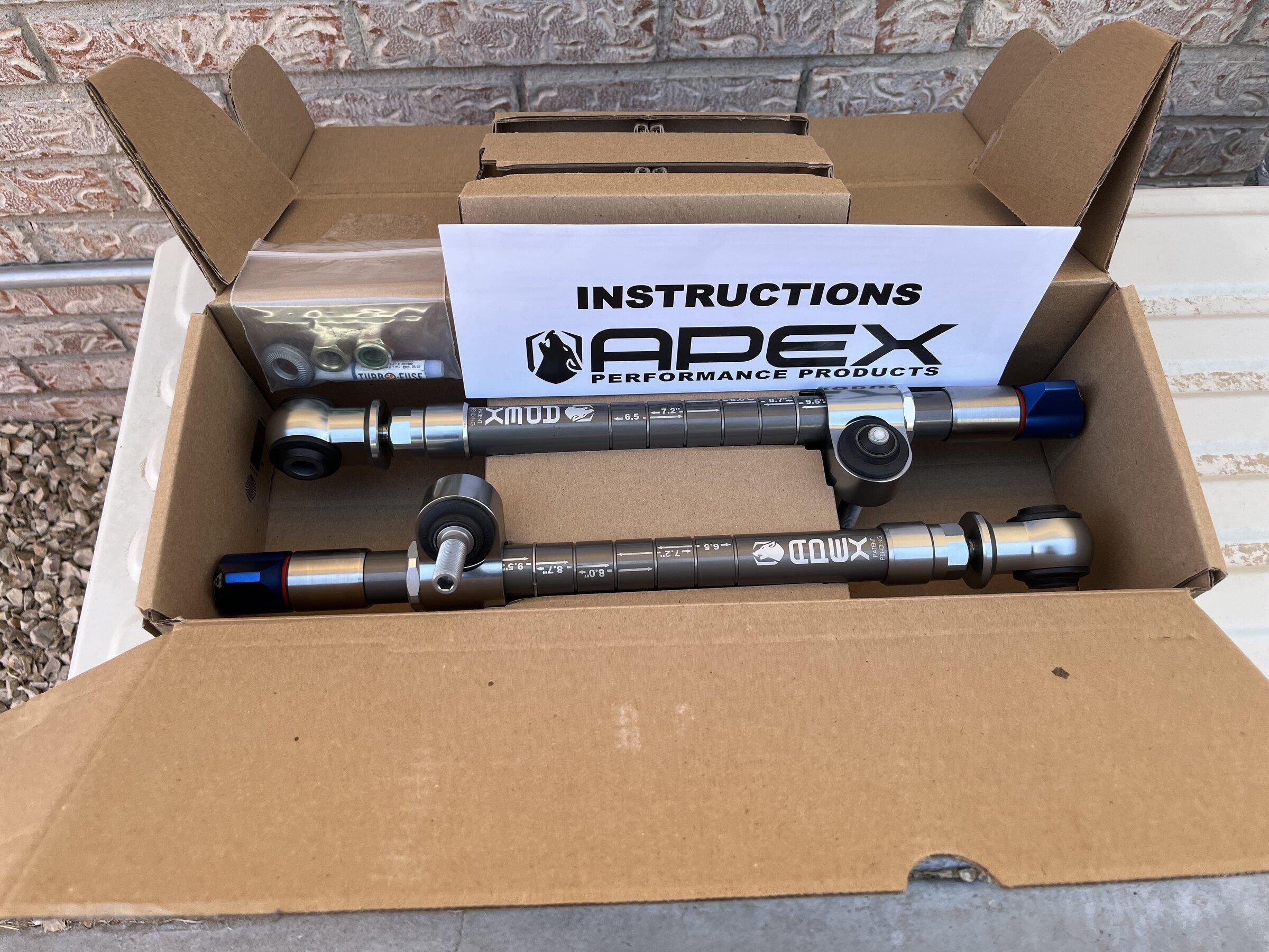

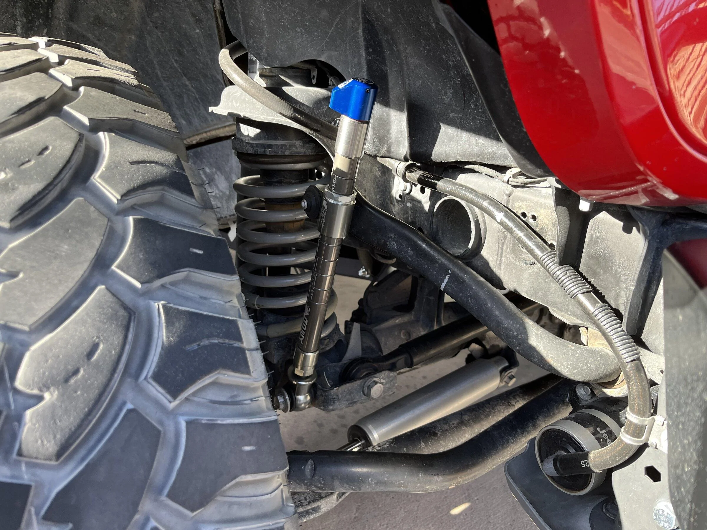

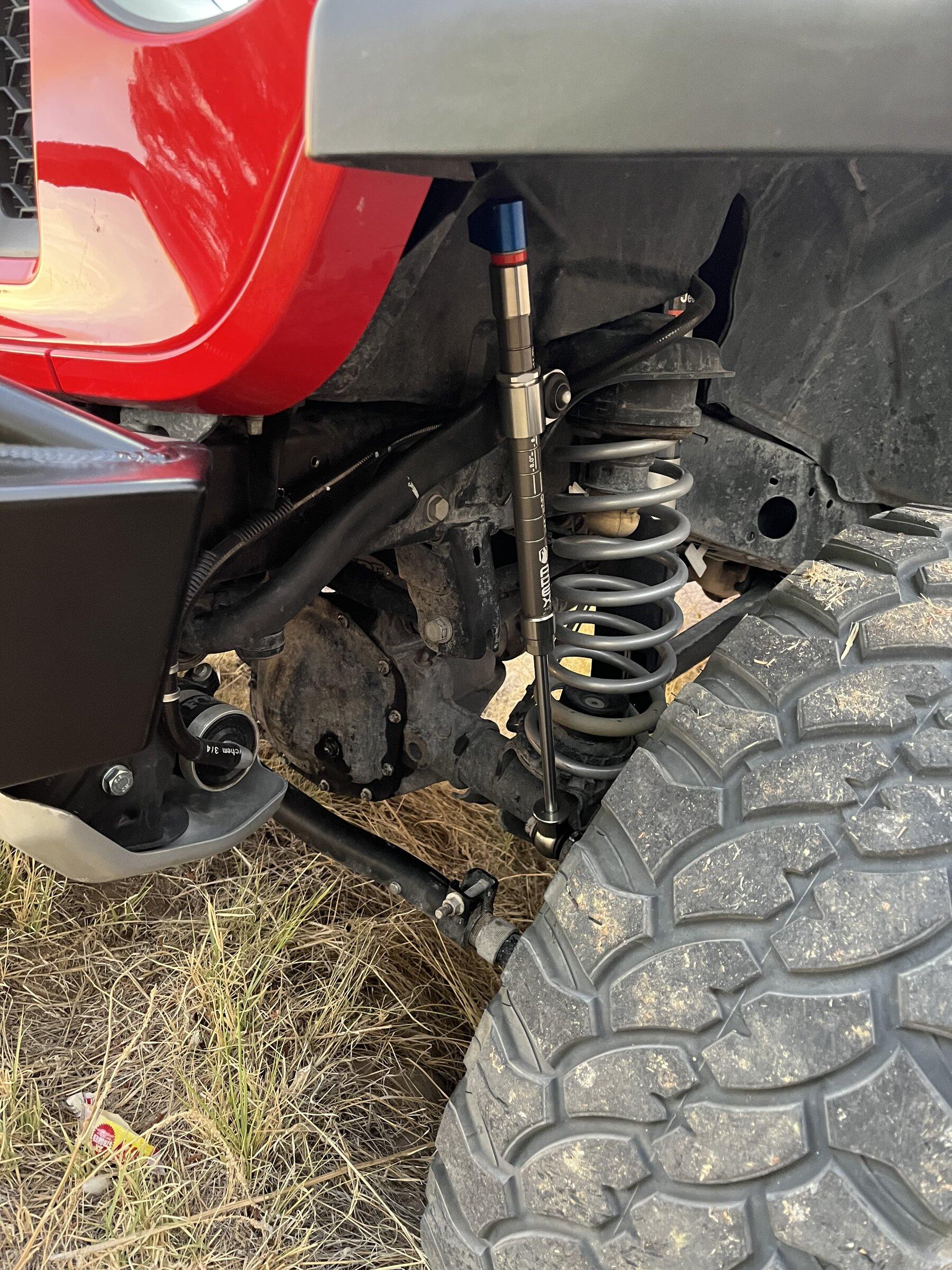

That's the nature of quick disconnects, they're a major PITA to get on and off. My Synergy's were the same way. One trick to getting them on is to have someone rock the vehicle while you try to reattach, usually with a rubber mallet. WATCH YOUR FINGERS!
If you want some other options:
1: Apex Autolynx, what I upgraded to after getting tired of the Synergy's, twist the knob and go. $450 last I checked.

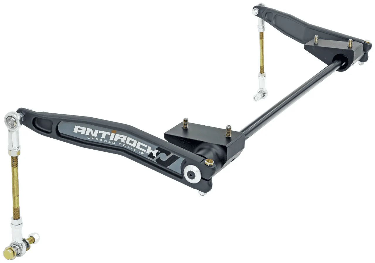

2: Rock Jock anti rock sway bars $550 (basically a REALLY soft sway bar)

Anti rock is the way to go.

What size lift are you running with the Apex. Trying to make sure I have mine at the right setting.
Fair warning, I bought my truck used and it was already lifted, the lift kit is still a 20% mystery to me, my best guess is it's a Ready Lift 2.5 inch lift, I've taken apart the lift to add the Mojave suspension and that was the most similar lift kit to what I was taking off. I also dropped the bumpstop from a 2 inch to a 1 inch for better flex.
No rubbing/binding issues whatsoever. I'm running the Apex 10.5 inch stroke (also gives room for a bigger lift later on if wanted), at the 10.2 setting. Apex recommends that you measure the links that you removed, and set them to that, if you're in-between sizes, round UP. My links were 10 inches, so 10.2 setting.
They also recommend you set the logo on the link facing forward, so the knob faces front/back depending on locked/unlock. I realized this after the locktite set, and since I didn't have any binding issues, I let it be. Didn't even need to adjust the liner.
