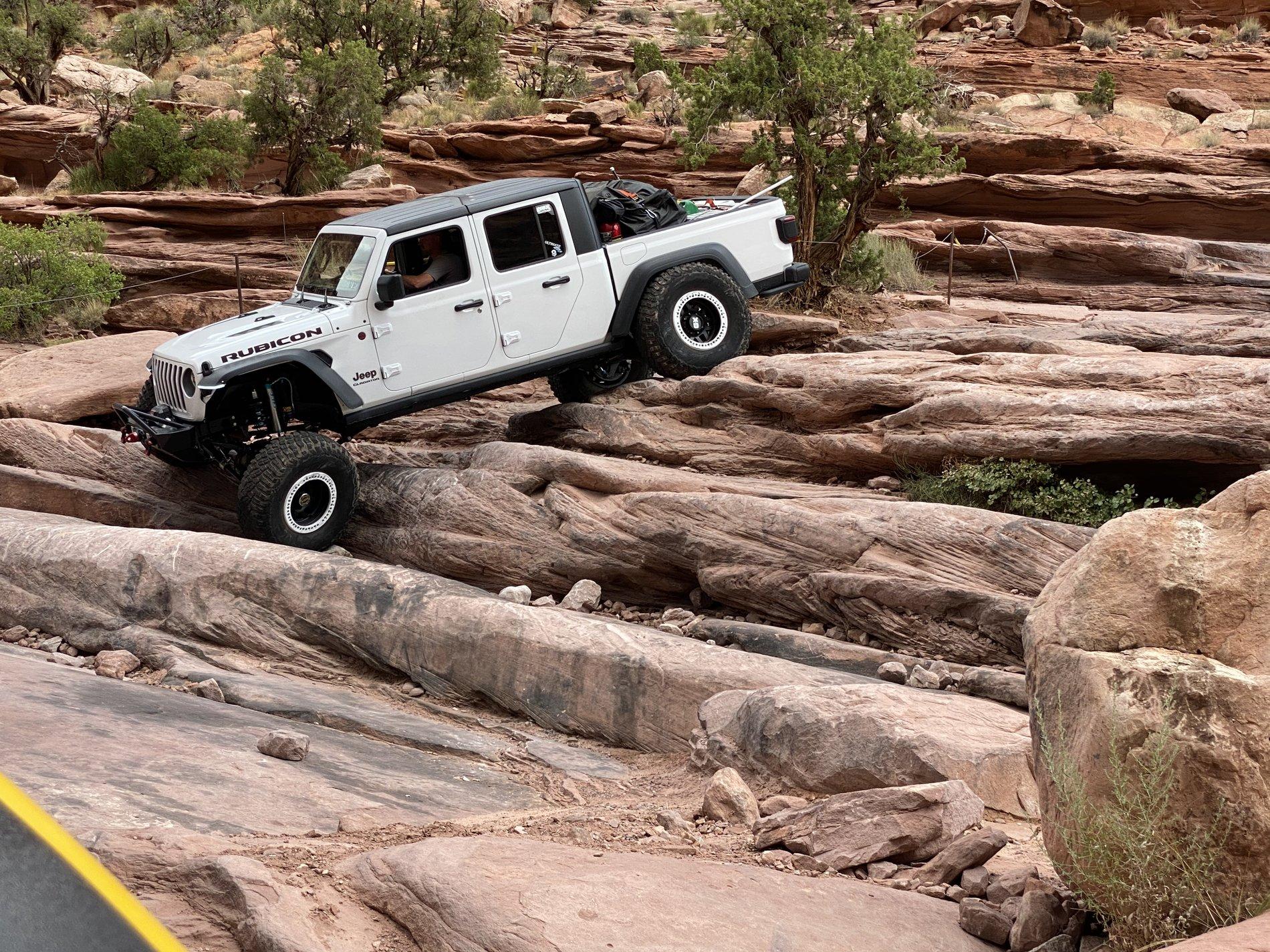

I just put on a MC 3.5” GC. It rides nicer than stock. I got mine with the Rocksport shocks and it’s nice and smooth. The downside to MC is the rear track bar is so beefy, it’s tough to get my new 37” Nitto Trail Grappler spare underneath. It’s pressed hard up against the track bar and hitch, even deflated to 20lbs. The MC guys said to take it to 12lbs and it will fit as they said that’s how their guys run them. I will try that, but I am thinking of swapping it out with a Clayton rear track bar for that cool bend to make room for that spare.
The MC articulation is insane. It’s maiden voyage was the trifecta Poison Spider, Golden Spike, Goldbar Rim trail yesterday. I went with a few friends who had Land Rovers. They told me the MC on the Gladiator made the Golden spike Crack look easy. No tire in the air… the MC articulationhad nearly full time contact on all 4 tires. It was amazing.

Thats a cool shot with impressive flex. Do you have any side photos of it on level ground
