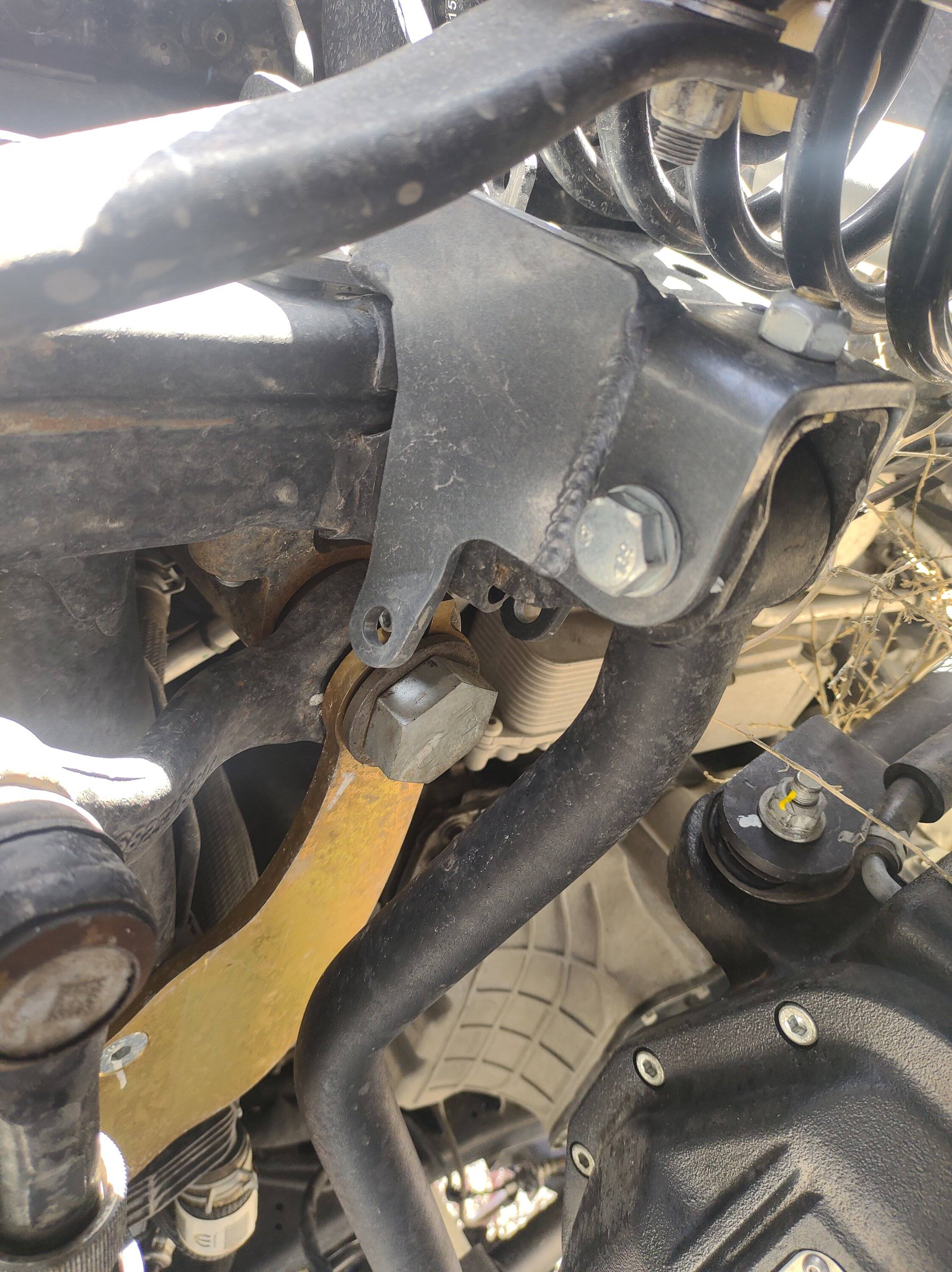

I ended up using both. Meatalcloak and synergy. Used the Meatalcloak one with the bushing and their nut. Ended up finding out after the fact that there was just a trackbar brace. I ended up with the synergy sector shaft brace as well and using both. Now it's captured on both sides. I like the synergy one better because of the gusset on it. With the Meatalcloak one it's more secure to the frame.

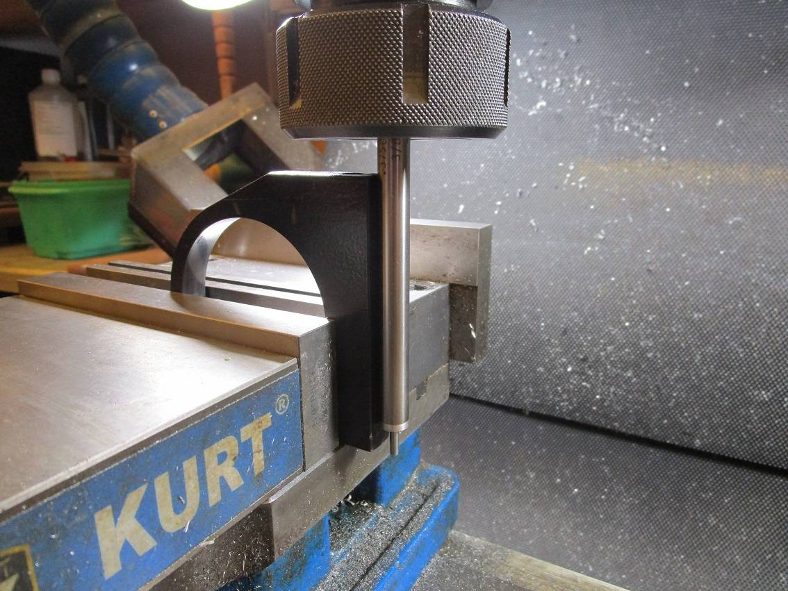

First of all let me say I am a machinist so this was easy for me
The best way is with a milling machine put can be done with a large dill press
1. Lined up the housing in the vise with a drill blank to make sure we are true to the piece

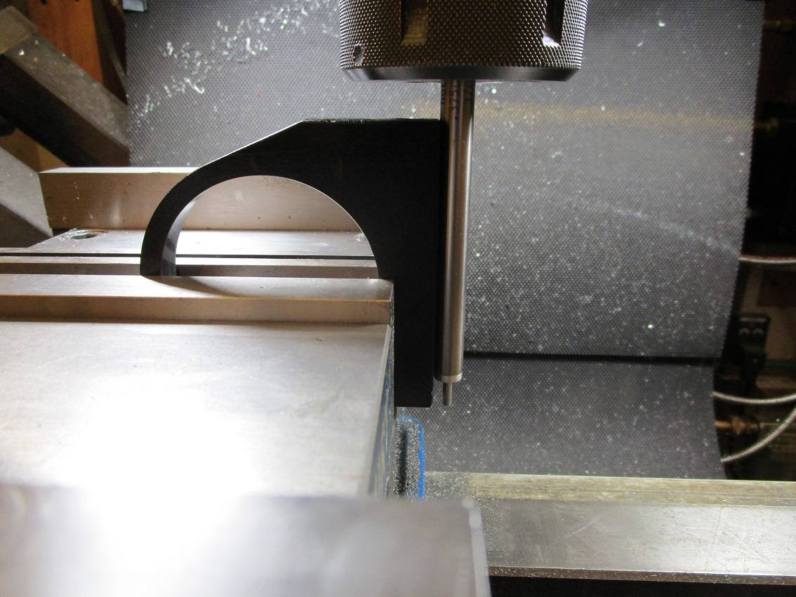

2. I used a no. G letter drill bit .261 to line up the threaded hole to be drilled
A .261 bit is a perfect fit in the threaded hole

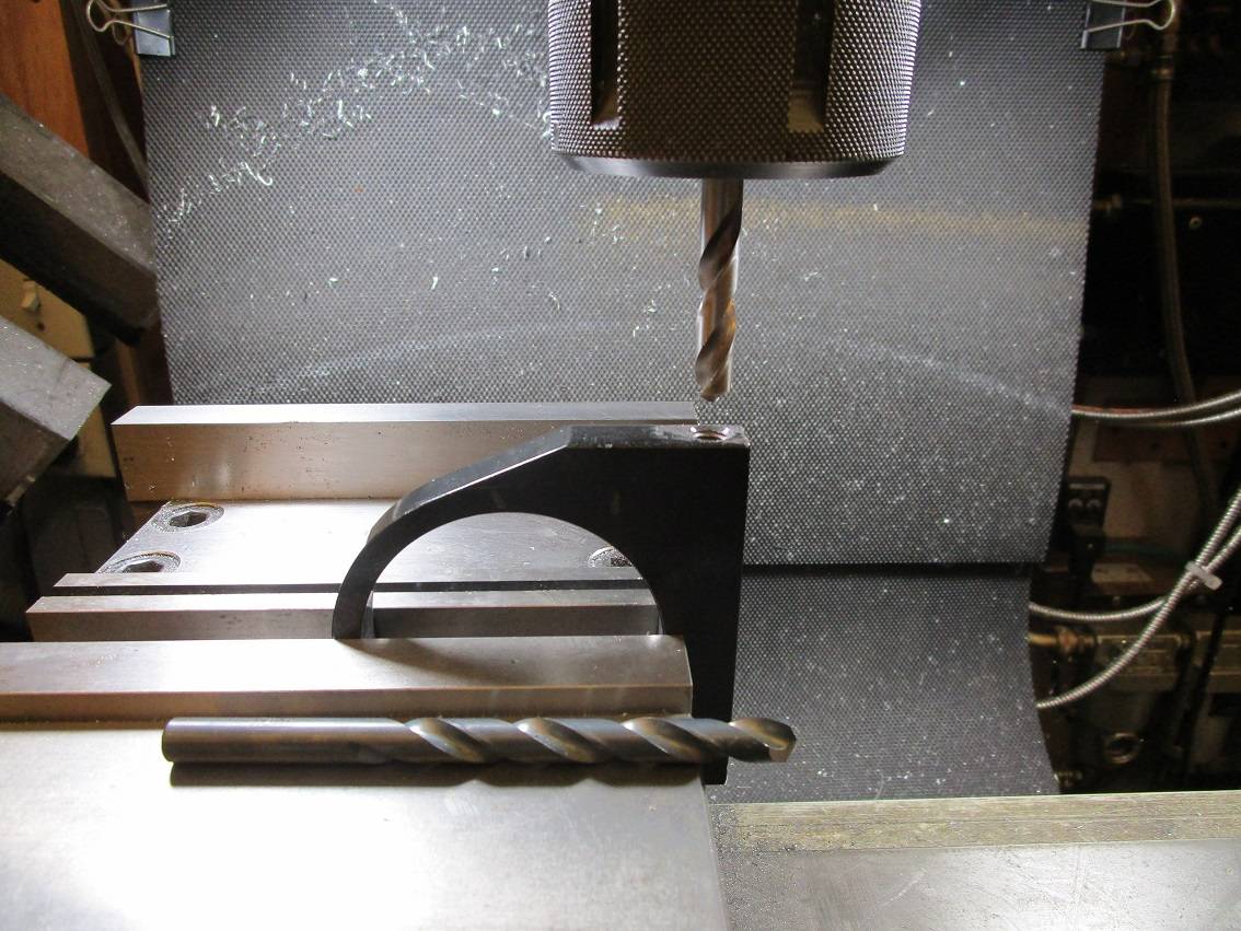

3. Took a 5/16 machinist drill bit to start and drill as deep as it will go
A machinist drill bit is a short brill bit and will not wonder when drilling

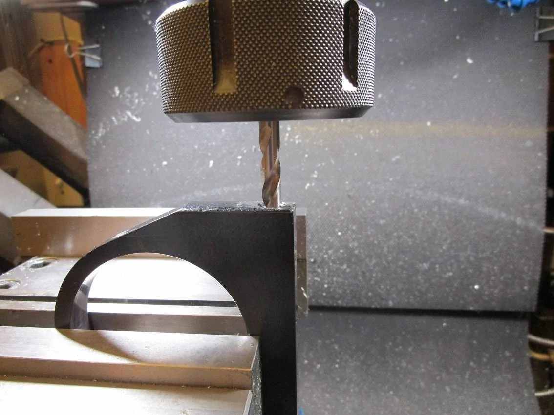

4. Finished the hole with a jobber drill bit or longer drill bit
I could always tell when the bolts would come loss. The jeep would start to wonder
One you do this you will no longer have the bearing housing bolts come loss
Hope this helps
