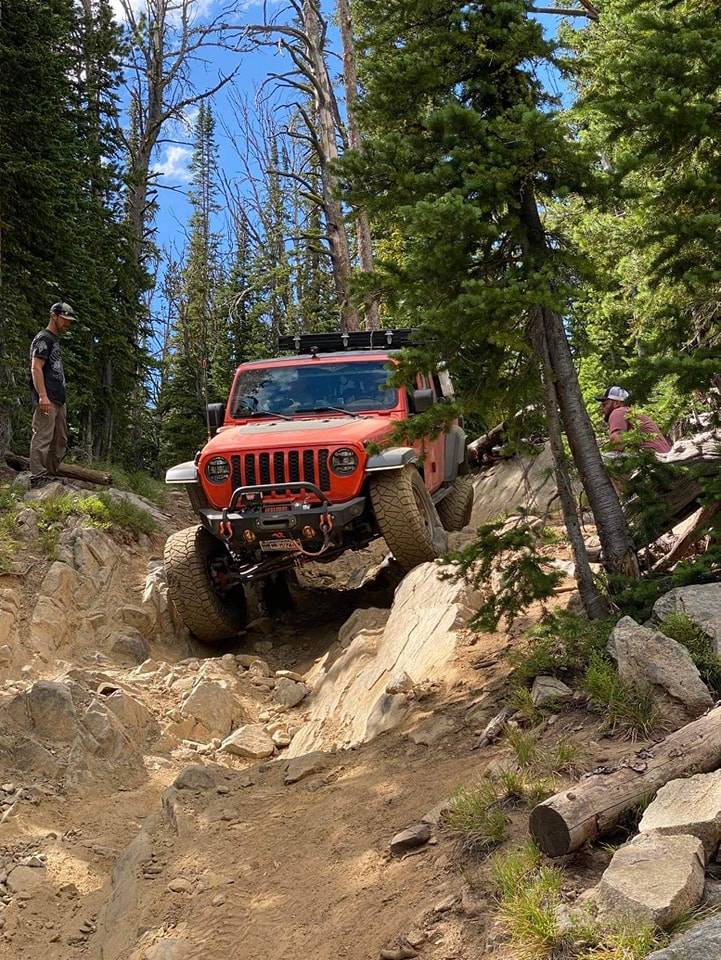

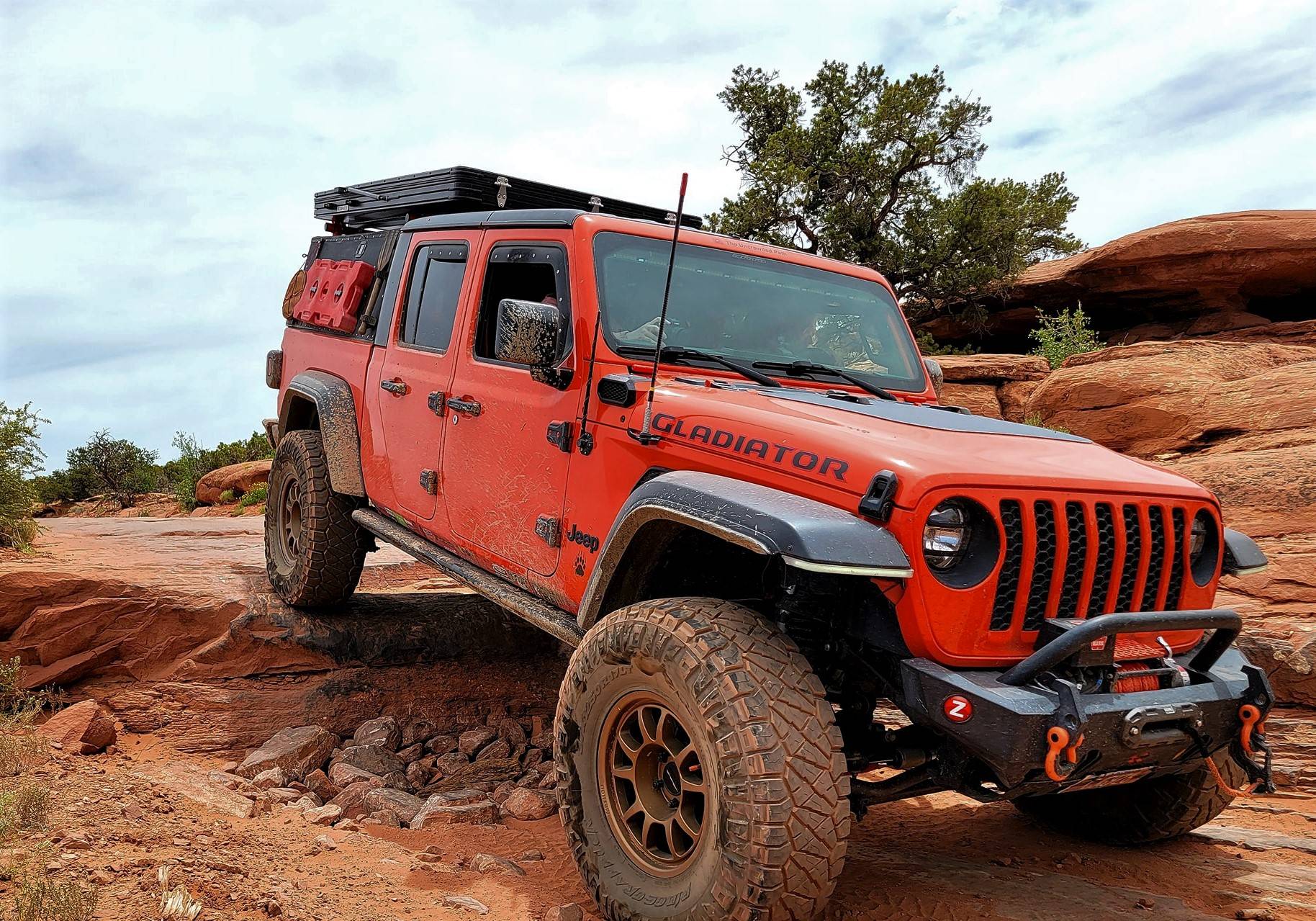

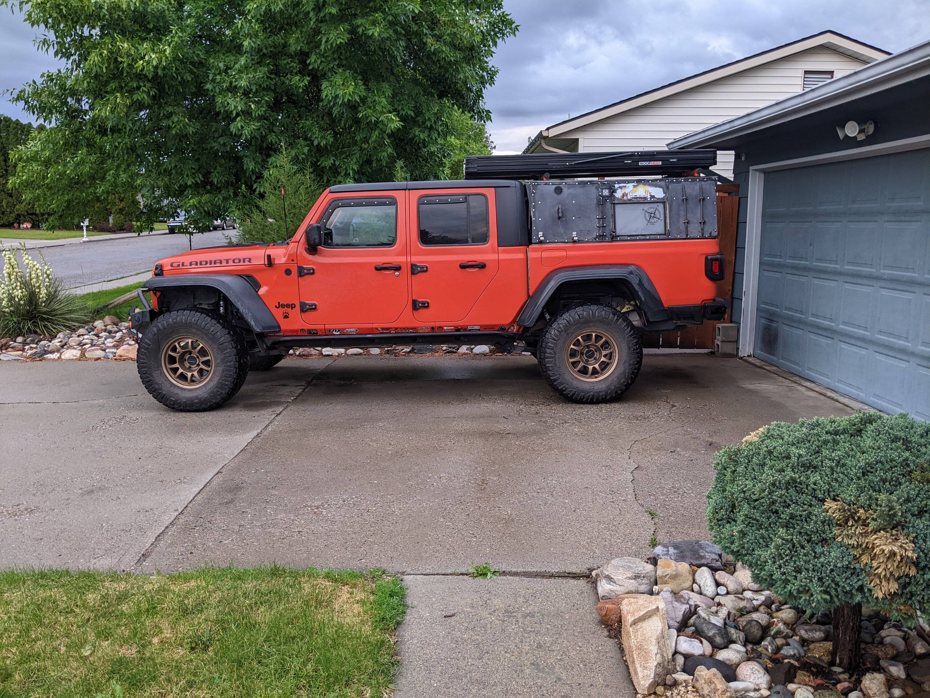

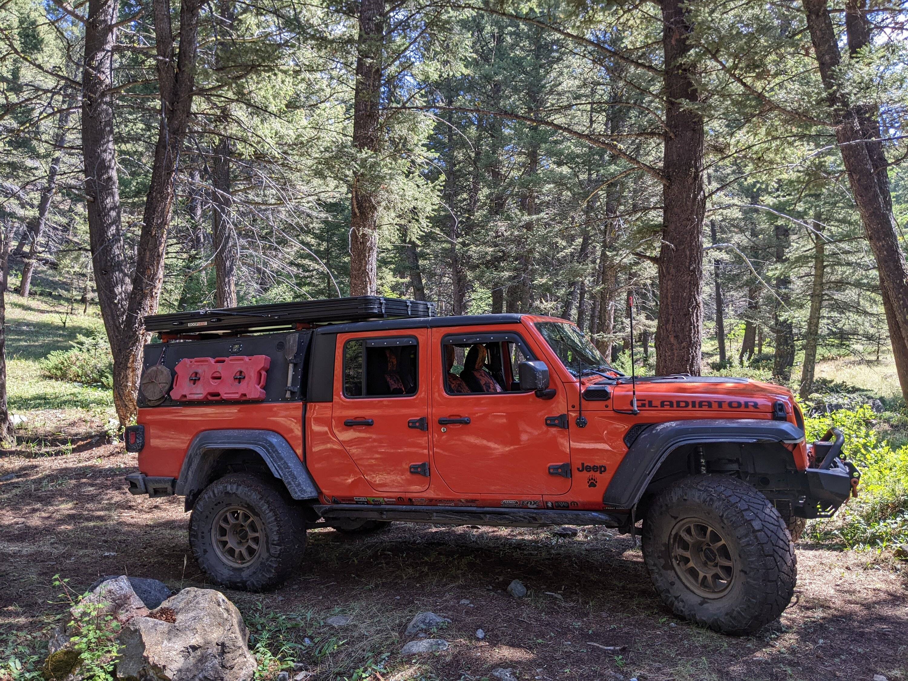

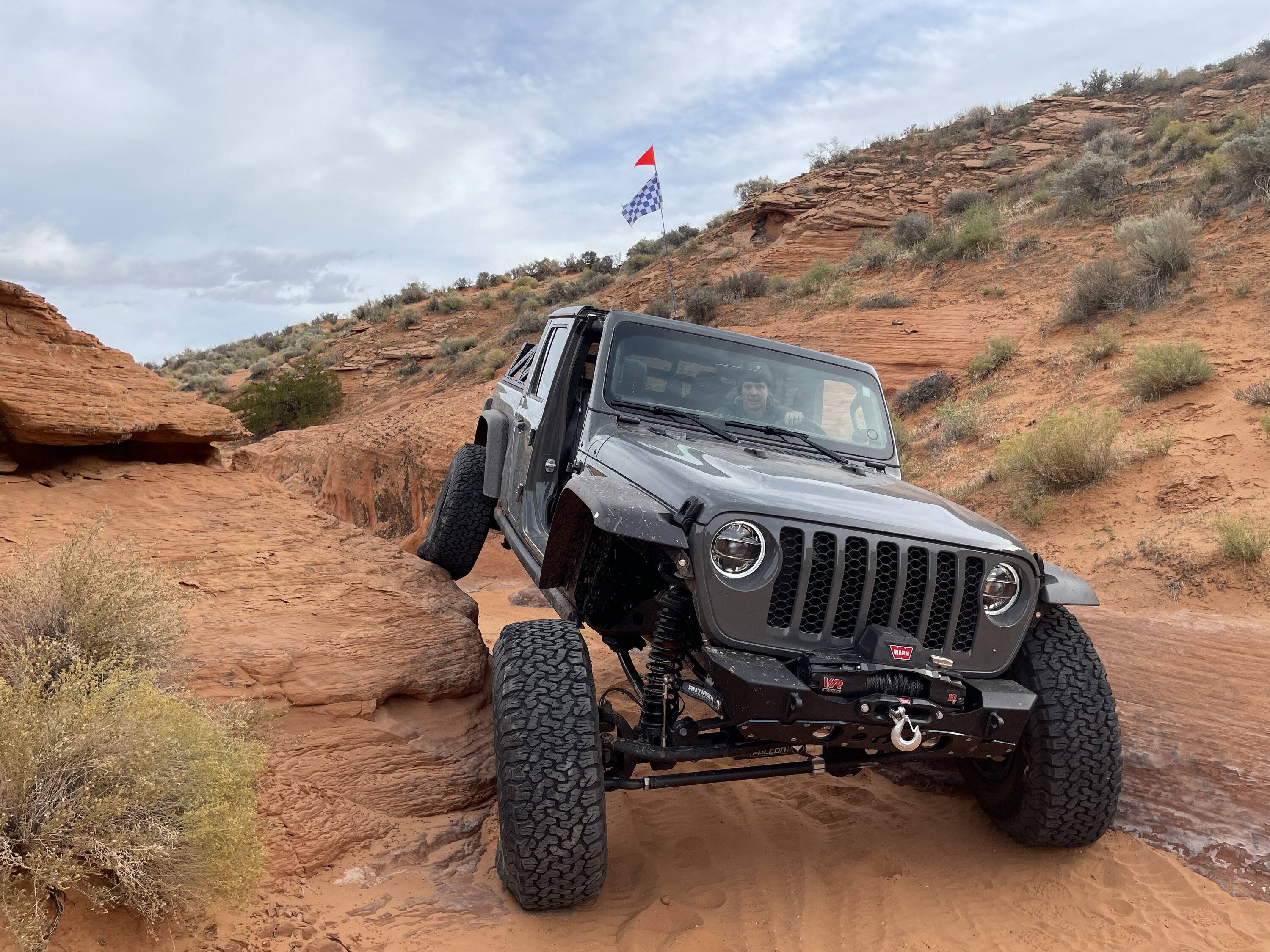

I have the evo plush rides ...they said 2.5 inches but were about 1.5 inches taller. When laoded... they lost the inch quickly. Since I often rock crawl and such while loaded for trips... I exchanged them for evo 4.5 inch plush rides in the rear. These handle the weight much better when bouncing around in the rocks. In the third from the top picture I was loaded with about 650 lbs for a month long trip... with the 2.5 coils. They would rock and compress too quickly with a load on when rock crawling. The springs could not slow the roll. After that trip and 1000 miles offroad... I changed it up. The top two pictures and the bottom pictures are the 4.5 inch coils in the rear with about 400 lbs on... I have since put a good 450 in it and it settles a little bit but it still holds the weight way better coming off of ledges and such. The front is the 2.5 inch- I just put a 1 inch spacer in for now. It has a rake when empty but doesn't turn into a porpoise when loaded.

Wow! Nice flex and great picture! My Evo 6.5” coils did the same.
I’m wondering if you also installed the Evo control arms? I did and they’re great.

I had stock arms still at the time these were all taken... I recently went with metal cloak full set of 8 arms.
