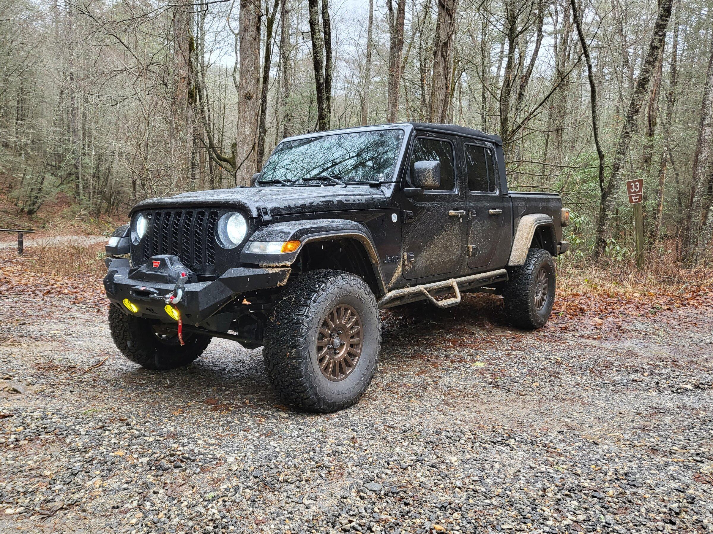

Jeep Gladiator EVO vs Clayton vs Rebel? 20220116_160230

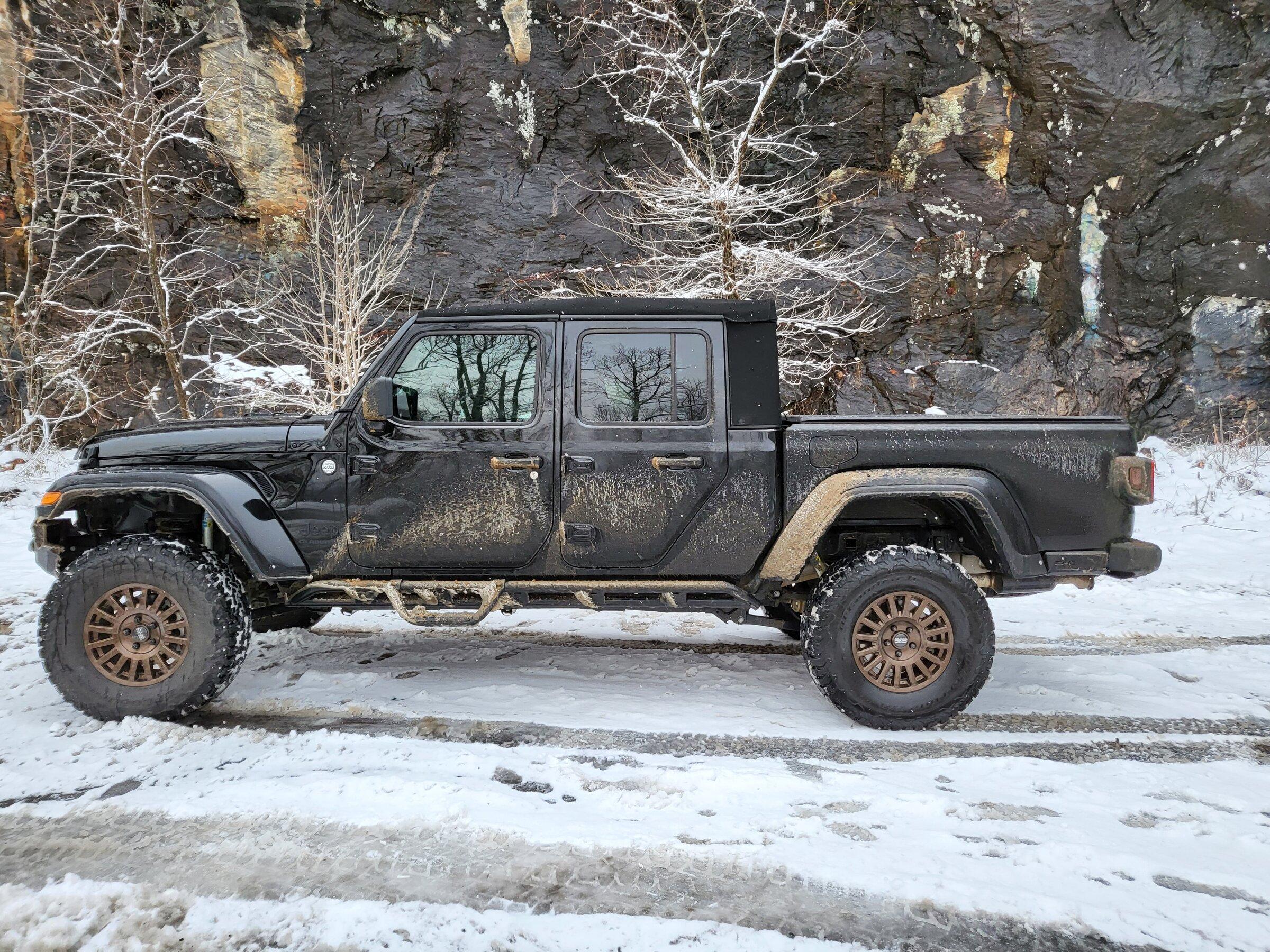

Jeep Gladiator EVO vs Clayton vs Rebel? 20220116_151941
Clayton 2.5" Ride Right + with Mopar front LCAs, JKS disconnects, Rock Jock driveshaft spacer, Bilstein 5100 shocks and stabilizer. I also have a .5" front spring spacer to compensate for the bumper, skid plate and winch. I'm not sure if the spacer was necessary or not. I've got it set a 6* of positive caster and a little toe in. It drives very well! The Bilsteins are a bit firm, but help control body roll.
I gained 4.5" in the front of my Sport S Max Tow. My rear is about 1.1" taller than the front, which to me is great. I bet with towing it will drop an inch to two inches.
I had Rubicon LE front springs on originally and the gave me an inch of height in the front.
