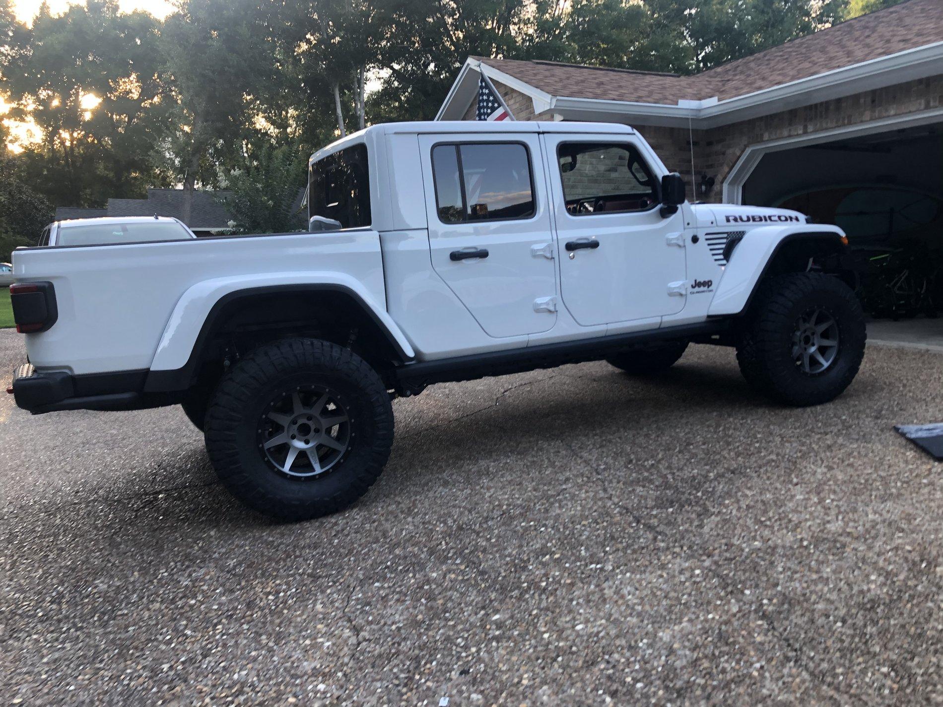

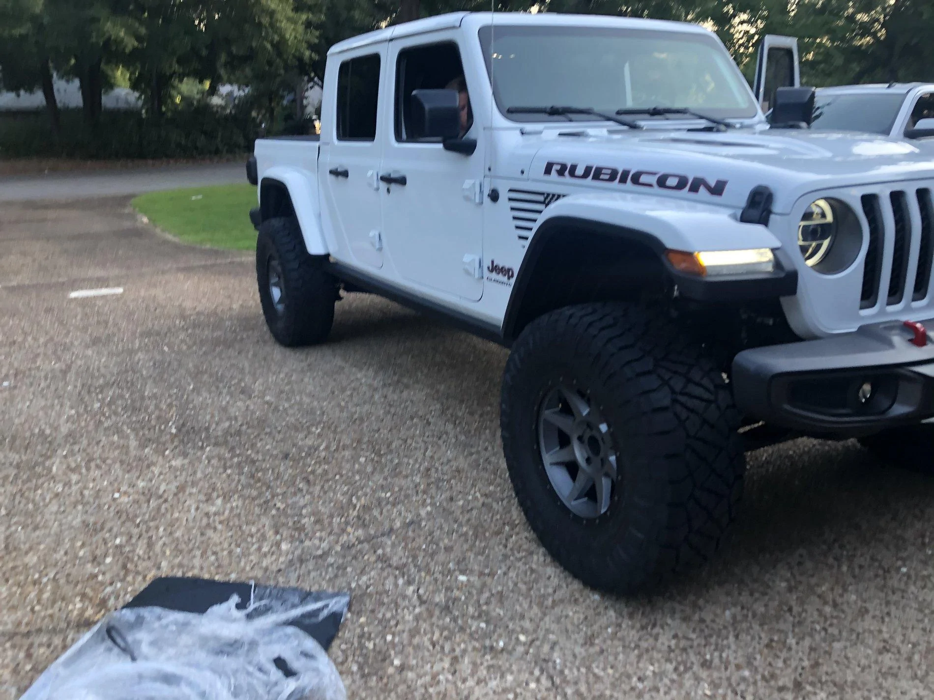

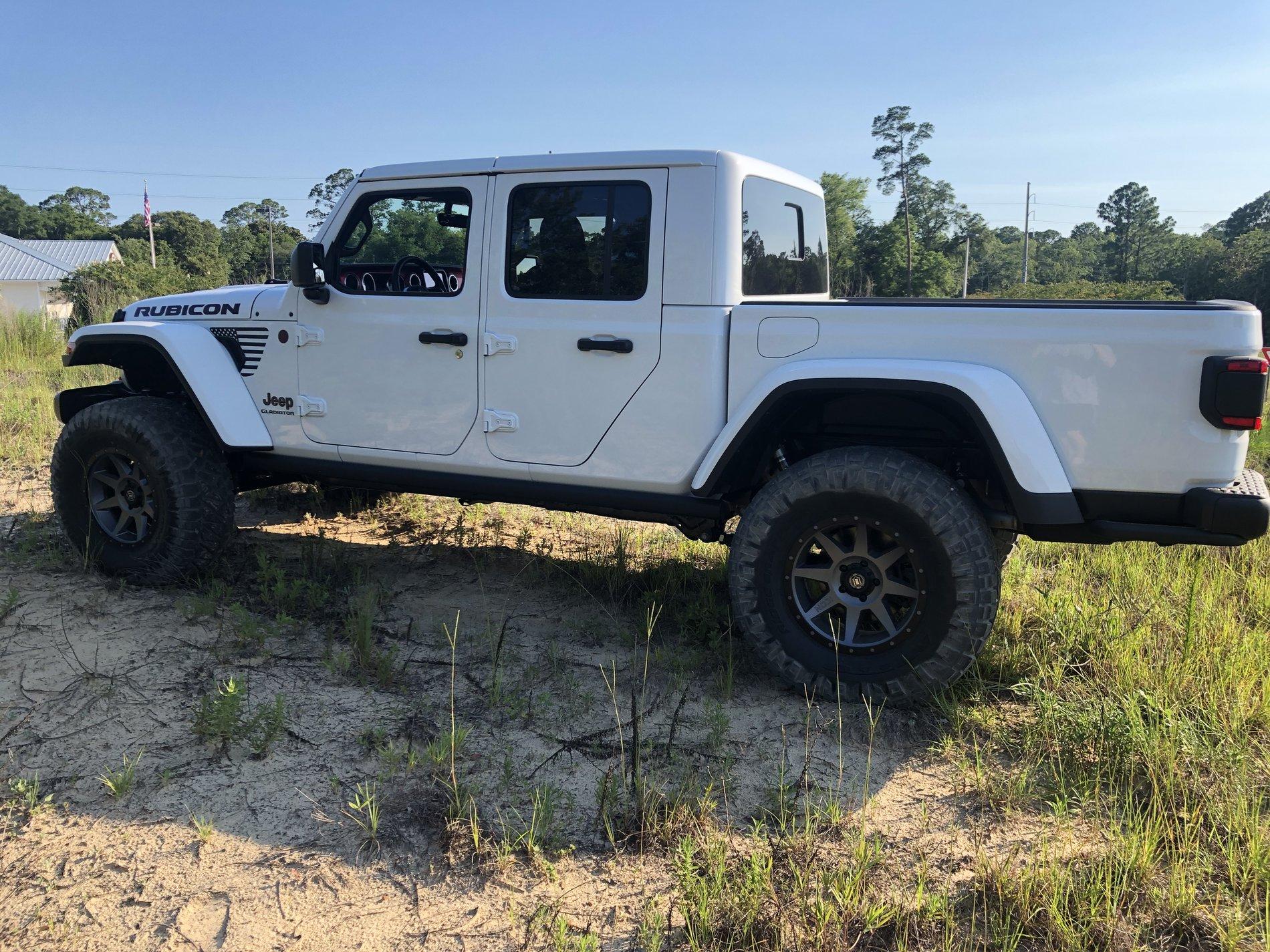

However not sure if the EVO springs would ride better as the overland kit maybe designed for carrying weight. I currently don’t have any overland gear or bumpers weighing down the vehicle so body roll is a bit drastic at first. driveshafts need to be changed as well. If your not doing any hardcore four wheeling u can get away with it for a while. And I am not sure if anyone else is exsperiencing the wandering and pulling from the gear box. Hopefully getting mine swapped soon utilizing the service bulletin from Jeep. If u are you might want to wait on the lift until u get it swapped. Anyone have any questions let me know as I have done an ungodly amount of research on all this.

It looks great! I am currently waiting on this exact lift , ordered it on the Labor Day sale , are you saying it rides bad? what exactly do you mean by "drastic body roll"? How does it ride/drive compared to stock?

No but 3.5 inches is high. It turnes a lot of heads and I get a lot of compliments. The front springs are 4.5 inches cause the weight of the engine will bring it down to 3.5. The kit is beefy and the parts are quality. But if you have been driving around stock for a while you will notice the body roll going over bumps and turning. Make sure you take to someone who knows how to align with all 8 arms being adjustable. Make sure your thrust angle is right as your axles will want to shift to one side but with the adjustable track bars easily correctable. This lift maybe designed for someone who is going to ad a lot of weight with overlanding gear.

It doesn’t ride bad at all. However I am exsperiencing the wandering and over correcting issue that maybe from the steering gearbox that Jeep put a service bulletin out on. Hopefully this will correct my issue and make it a bit more enjoyable to drive. When it comes in let me know if you have any issues installing. It’s no small undertaking. It took me 2 days in garage. U have any questions let me know. I also went with the fox 2.0 shocks.

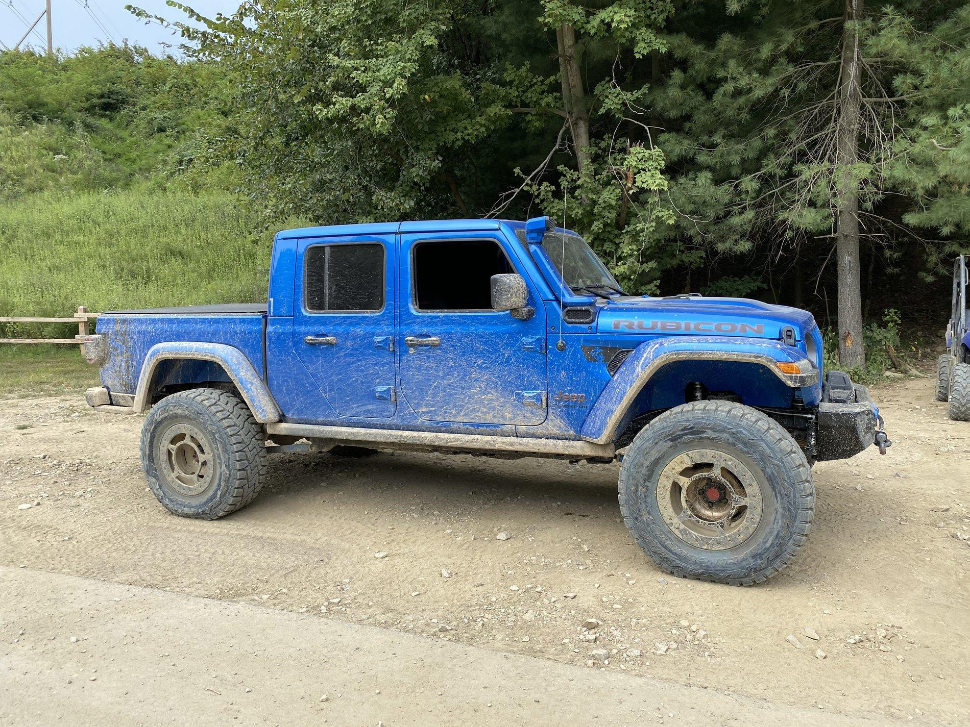

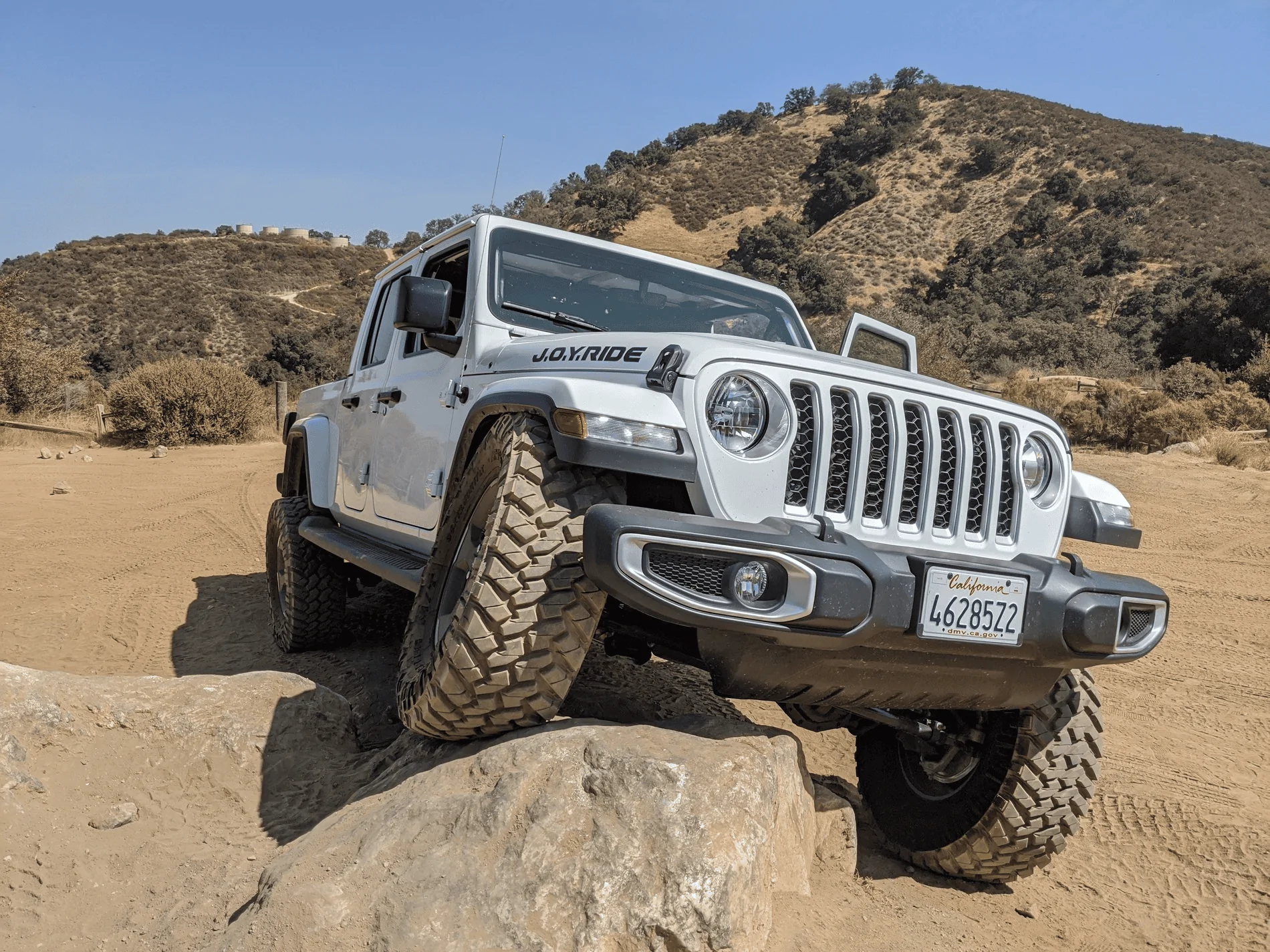

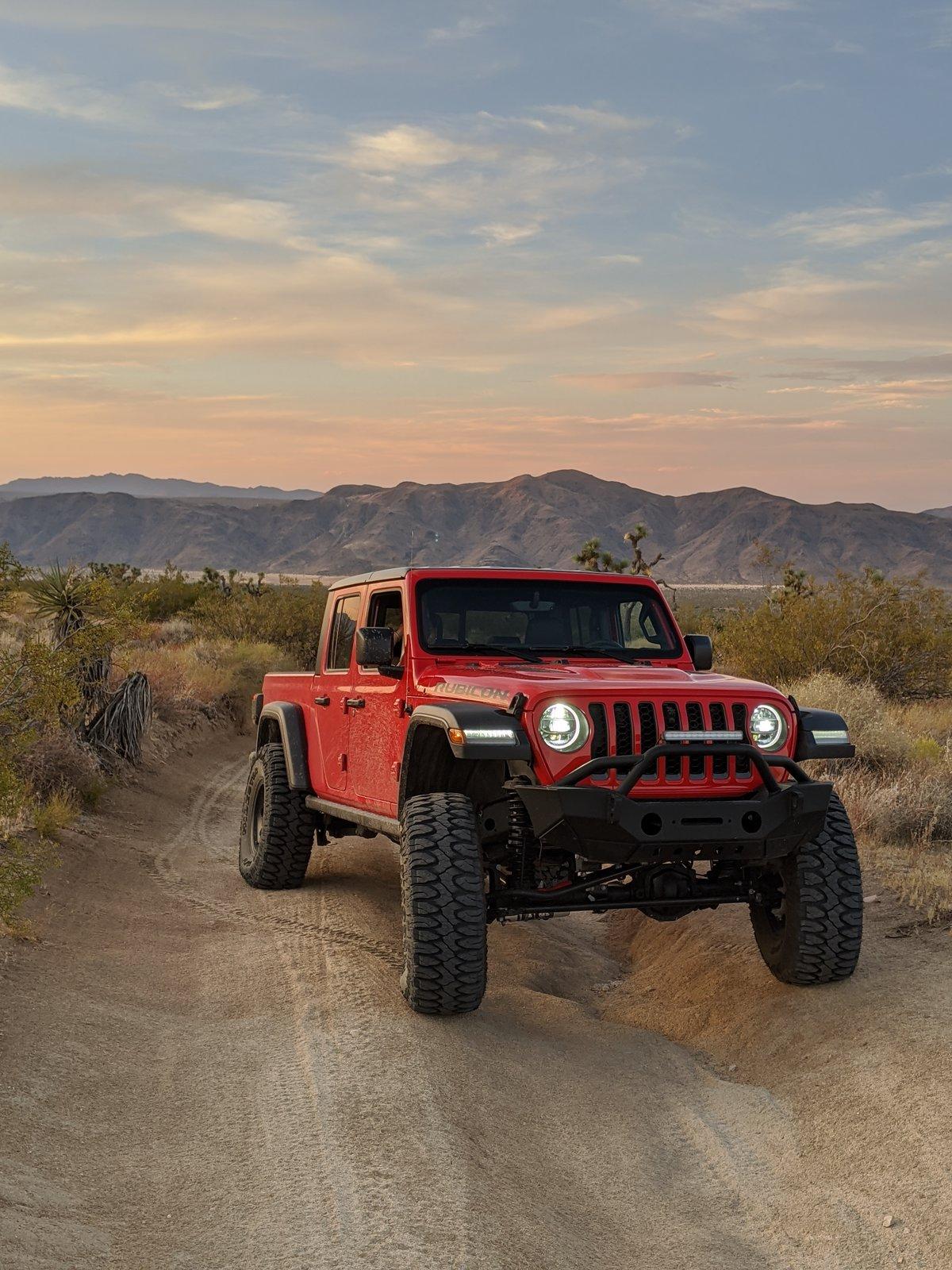

My Clayton 2.5" was more like 3.5-4". With JKS disconnects I maxed out the front fenders of the Overland. Why we went to the OHV park... see where the limits are. Right now we are limited by the fenders.
