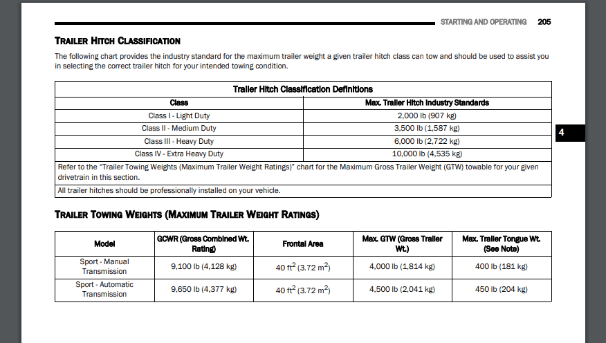

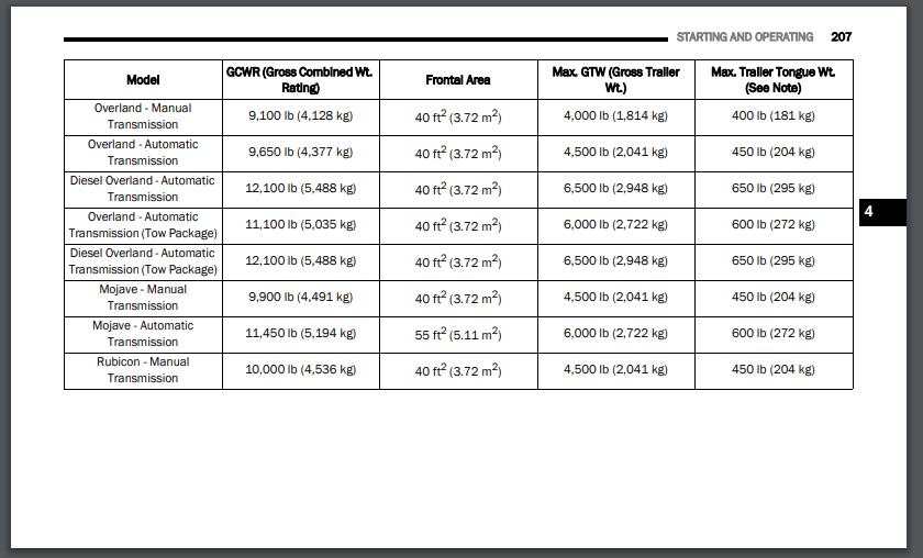

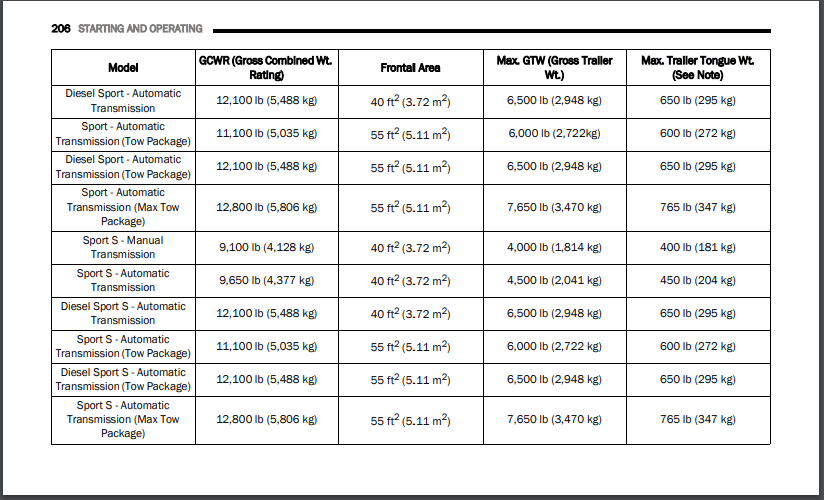

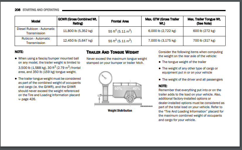

Page 205 of the Jeep Gladiator Owner's Manual (available digitally, too).
As mentioned, the towing capacity is affected by the options (overall weight) and truck components (cooling, axles, gearing, suspension).
Top towing trims:
Sport & Sport S w/ Max Tow - 7650
Rubicon - 7000
Diesel version of Sport & Sport S & Overland - 6500
Willys versions aren't included in my manual, but I think they fall under the Sport/Sport S limits.

Generally speaking here are the tow ratings in order of capacity:
Any trim w/ only bumper mounted ball: 3,500 lbs
Sport, Sport S & Overland with manual transmission & tow package: 4,000 lbs
Mojave & Rubicon with manual transmission & tow package: 4,500 lbs
Sport, Sport S & Overland automatic transmission w/o factory tow package (assume aftermarket hitch): 4,500 lbs
Sport, Sport S, Overland & Mojave auto trans w/ factory tow package: 6,000 lbs
Rubicon Diesel Engine (regardless of tow package equipped): 6,000 lbs
All others with diesel engine (regardless of tow package equipped): 6,500 lbs
Rubicon gas engine w/ auto trans (regardless of tow package equipped): 7,000 lbs
Sport S gas engine w/ Max Tow package: 7,650 lbs
