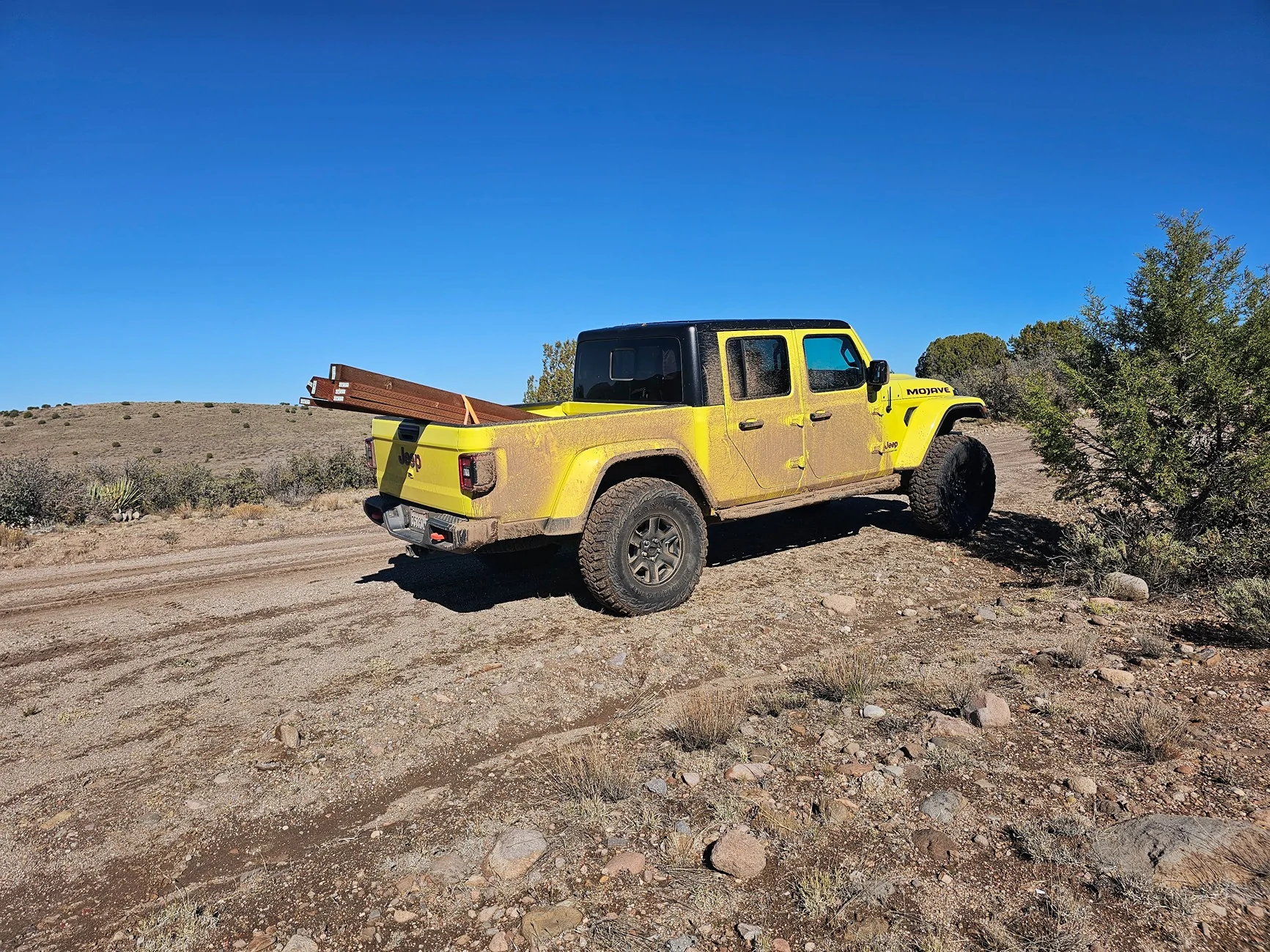

Isn't the max tow rated at 7,700 pounds anyway? Toyota towed the 300k pound space shuttle with a tundra rated at 10k pounds without hurting it (flat ground and low speed). The tow rating is literally worst case scenario. Part of the required testing is pulling a grade with the max load in 95⁰+ heat. You could back a 20k pound trailer into a spot without damage. Even if the tongue weight was 2k pounds the bumpstops will hold up just fine. The 1st Pic is my truck with 1800lbs of pavers in the bed, the 2nd is an 8200lb trailer that I towed over 600 miles including 20 miles of washboard dirt road. These things are tougher than they get credit for.
