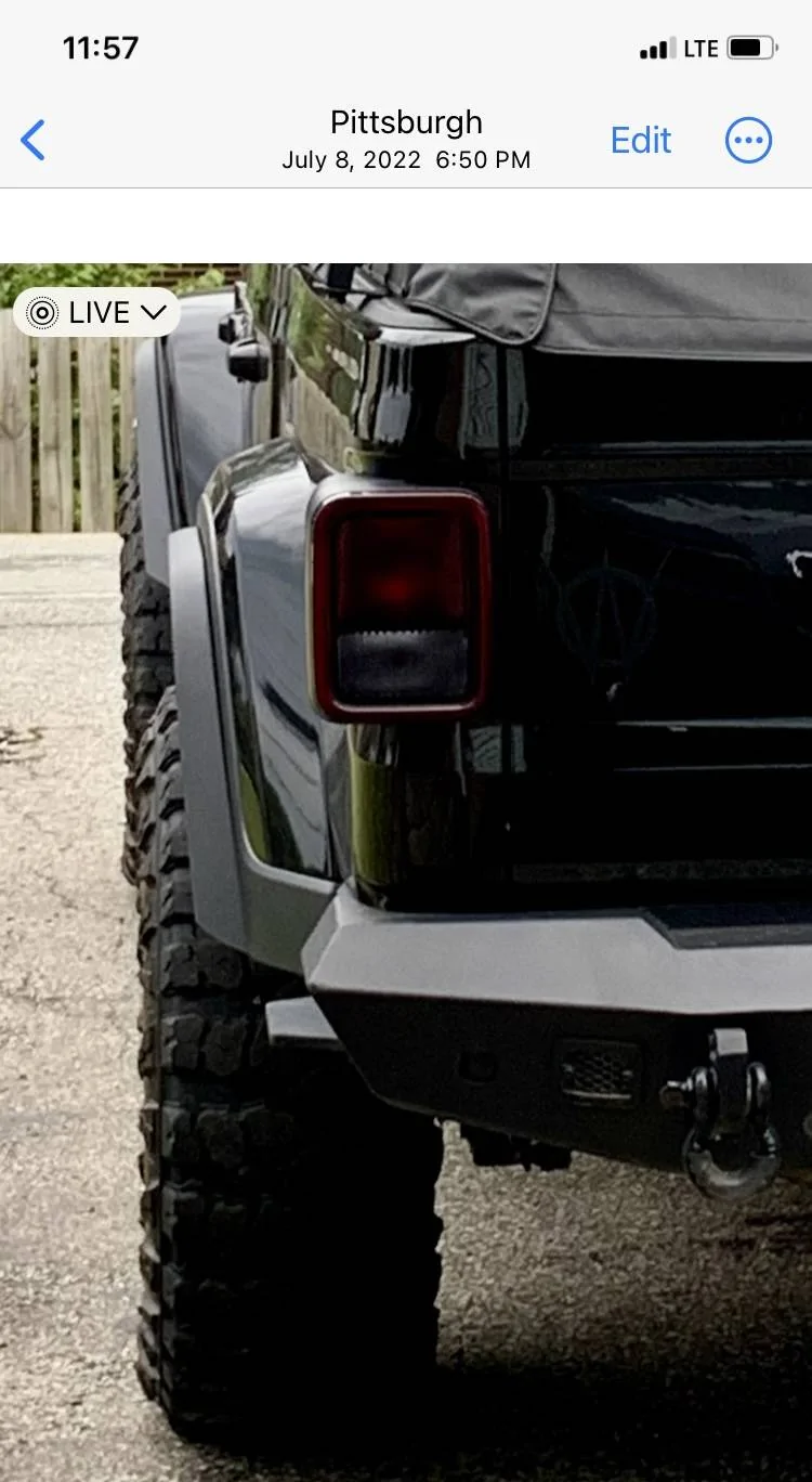

Do you currently have mud flaps? I’ll say that mine still flings crap all over the place with additional coverage. A lot of it comes from under the fender line. For context, 12.5” tire on 9” wide with with 4.75” BS.
Jeep Gladiator Extended Fender Flare Pics Anyone? 5CC7BAB3-DCA6-42C5-B713-0EDD1FC401DA

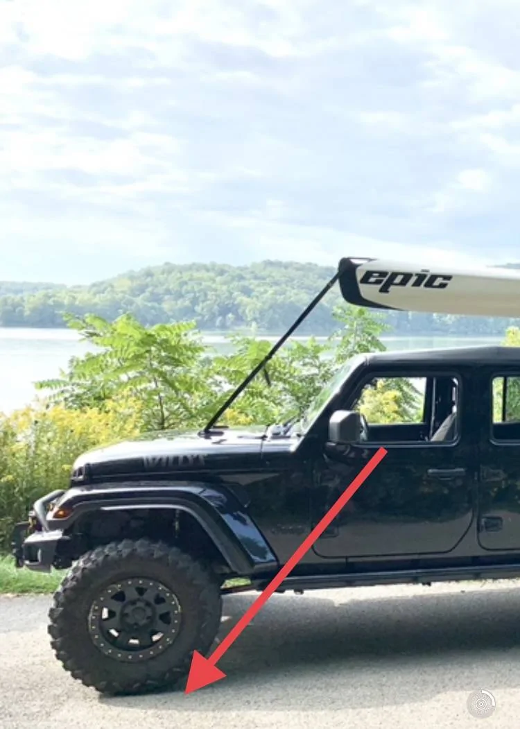

For this goal - “I'm interested in extending my fenders as to stop all of the mud, snow, rocks, dirt, dust, etc. from being flung back onto my Jeep”
I think mud flaps are the starting point. I could cut a kiddie swimming pool along the wall and tape it to the side like they did on the Bronco Raptor and my doors would still get sprayed.
Jeep Gladiator Extended Fender Flare Pics Anyone? 4A9BC906-8208-45D8-9AFA-7A0AFD5FA8C6

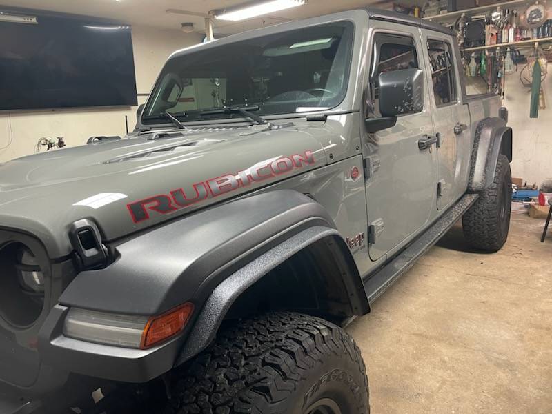

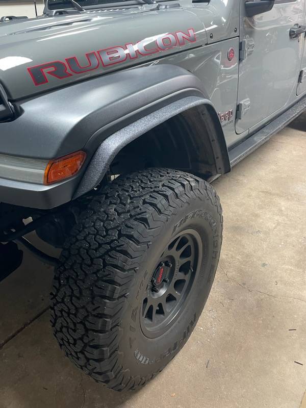

Jeep Gladiator Extended Fender Flare Pics Anyone? IMG_1700
D
Jeep Gladiator Extended Fender Flare Pics Anyone? IMG_1699
Double Black Offroad fender flare extensions... Line-X'd, 2" US spec JT...

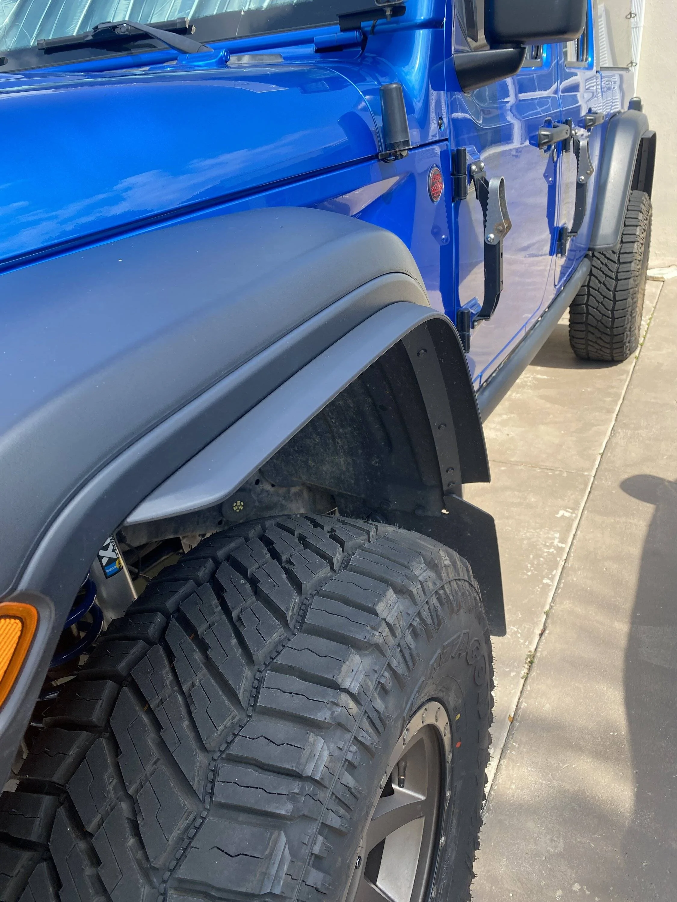

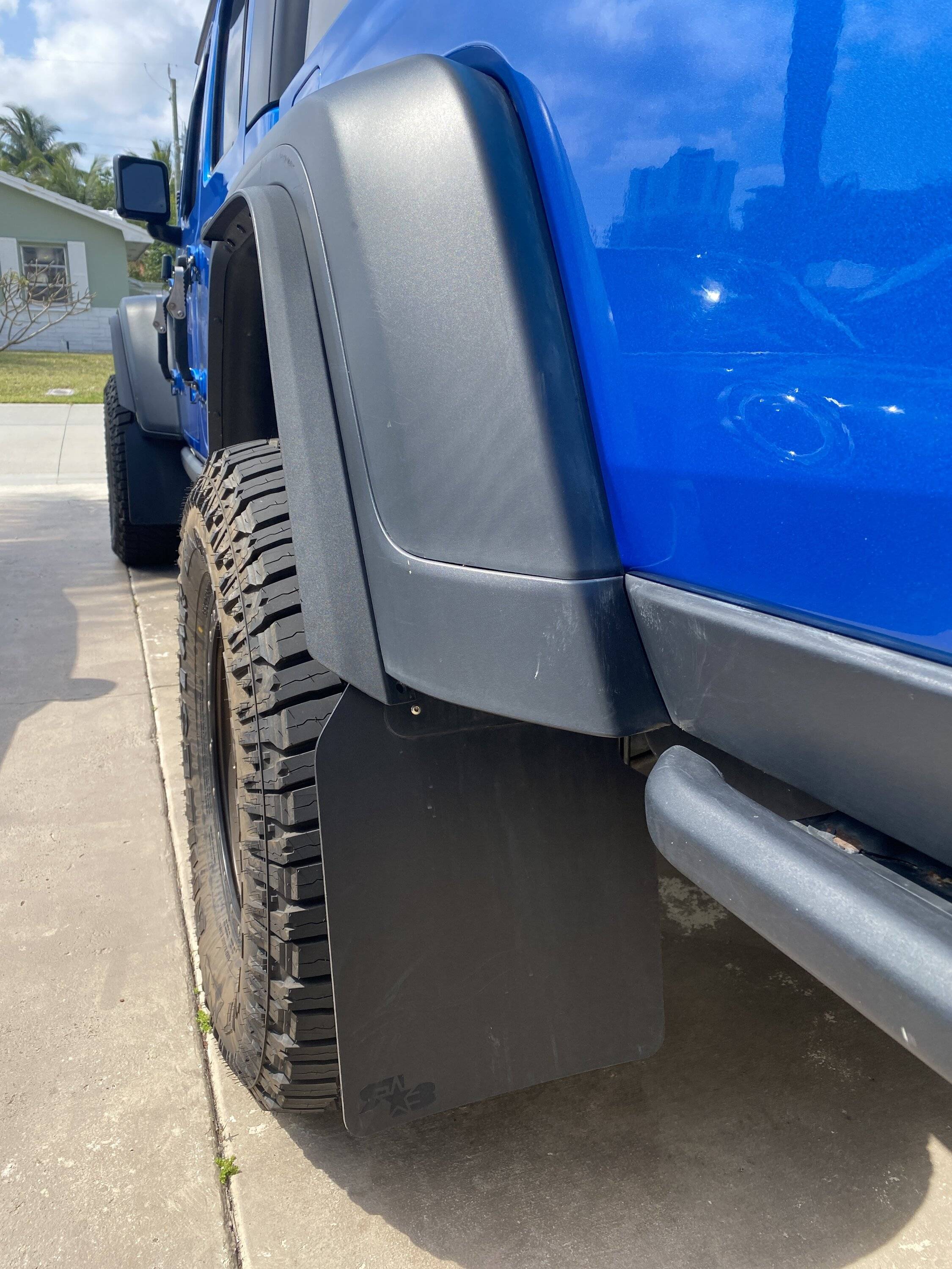

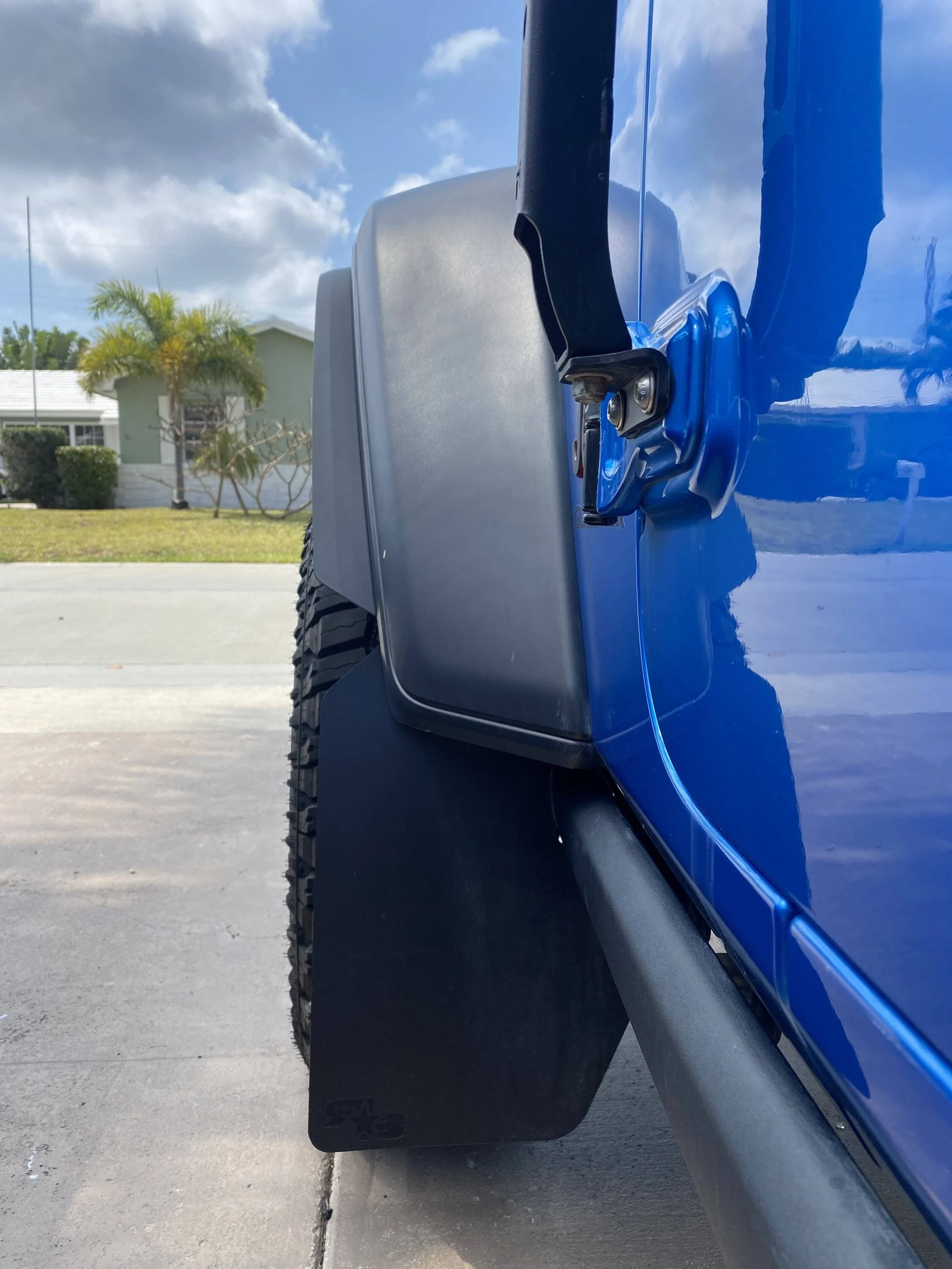

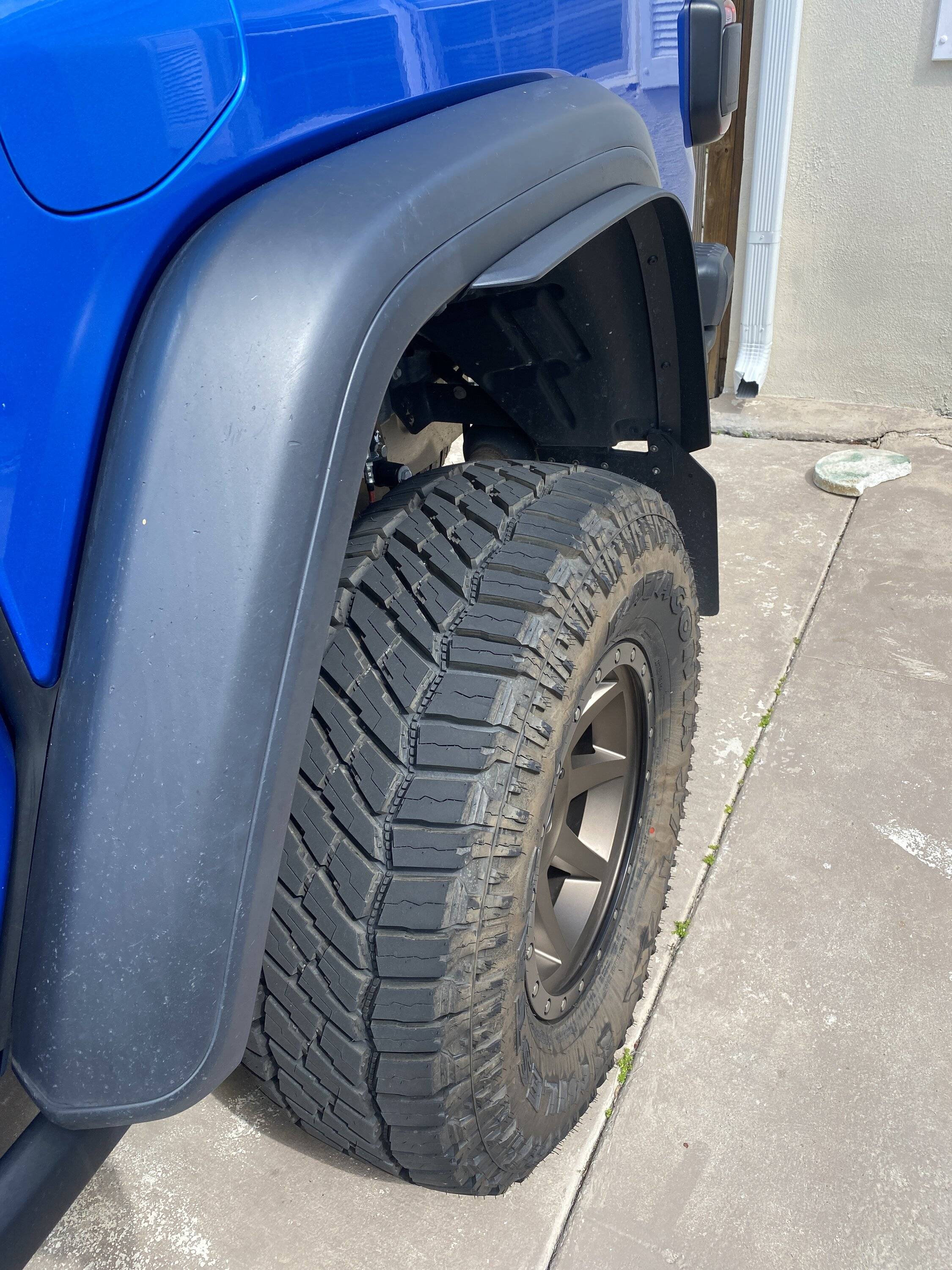

I installed the mopar Wrangler XR fender flares and already had the Rokblokz XL mud flaps. Honestly the flares helped alot. Even with the mud flaps i was getting alot of stuff flung up on the side of the truck. I would 100% go with the XR flares. They were like $120 shipped for all 4. I got all 4 front flares and they work like a charm. Easy to install. Just have to drill a couple holes in the back fenders to get them to align. I would suggest getting about 30 of the plastic rivits from mopar as well as some of the others that you can get from box stores suck when trying to install.
Jeep Gladiator Extended Fender Flare Pics Anyone? IMG_1708
Jeep Gladiator Extended Fender Flare Pics Anyone? IMG_1709
