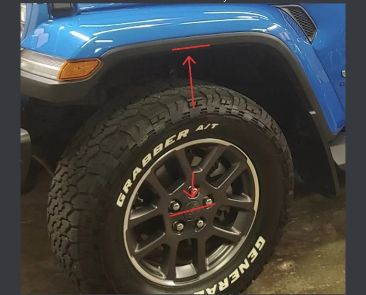

Bringing this back yet again.
I am looking for this measurement on a stock, off the lot unloaded gas JTR. So it should have 33 AT tires as well. For each corner please.
It must be a Rubicon as they have different fenders and other vehicles wont net a accurate comparison. I want to compare with my current setup, and compare again once lift is installed to see where things are at.
Jeep Gladiator Factory 2022 (almost optioned out) Rubi suspension height D7FA234E-8E45-4464-91E5-2459B8238F68
picture source of @ShadowsPapa. I hope you dont mind my screenshot of your other thread, this is a really great measurement method. From center of axle to bottom lip of fender

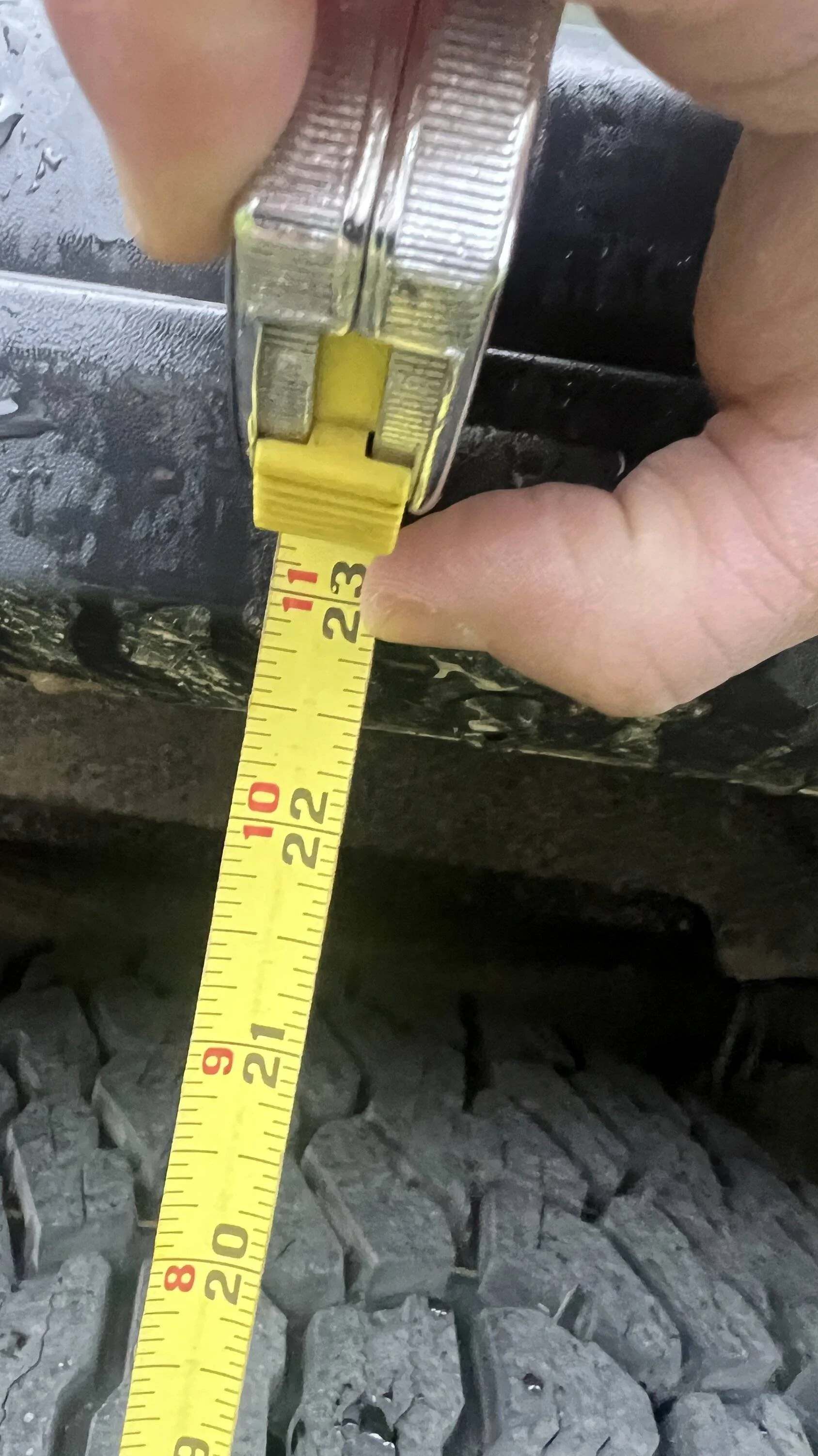

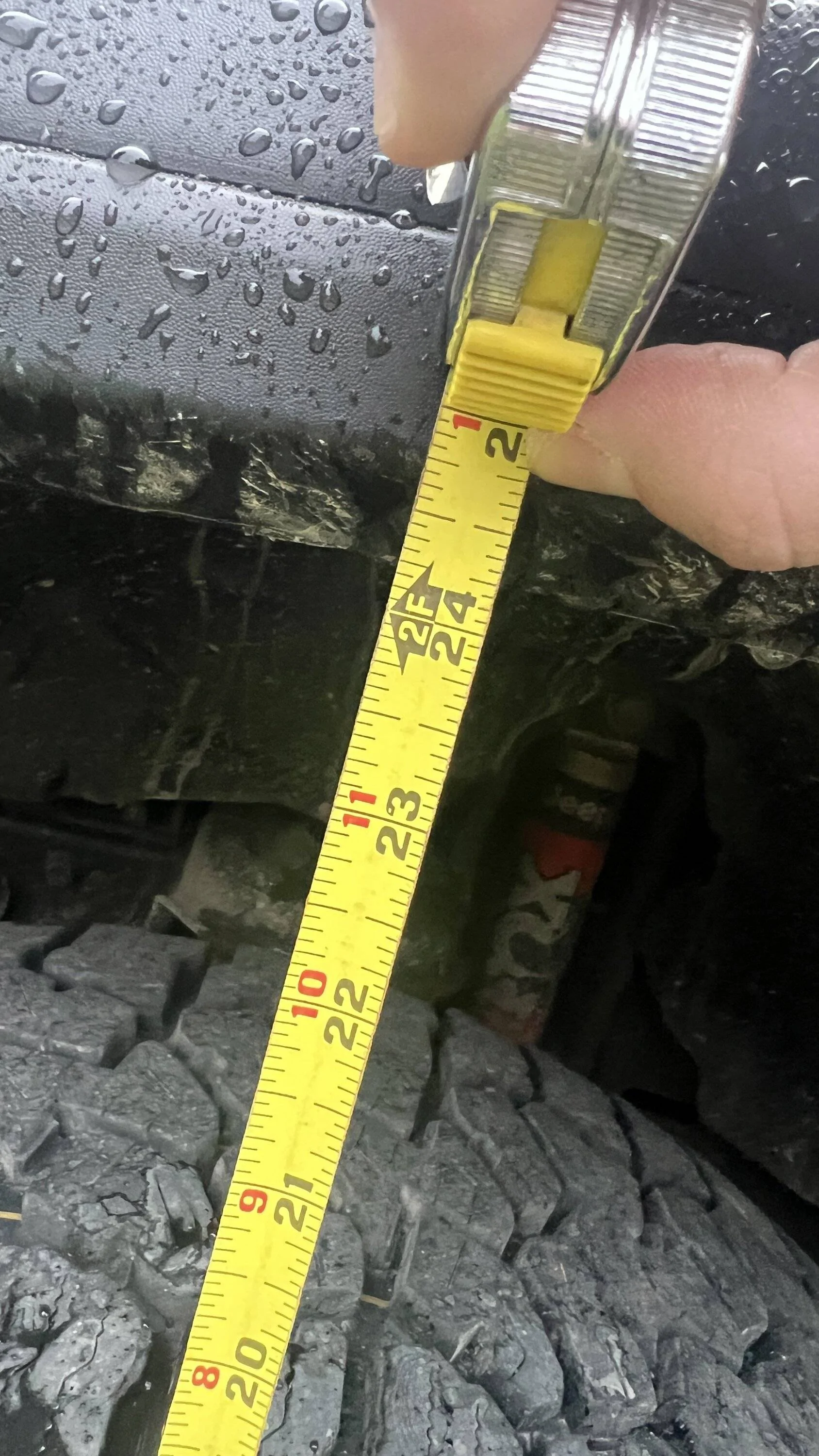

To start, my measurements with a partial load on uneven grass is:
LF - 24.75
LR - 22.75
RR - 23.5
RF - 24.25
I will redo these when on pavement but it gives a rough idea.
here are some pictures to hone in on measure points. Bottom measure point is center of axle, top measure point is my thumb, on the first lowest crease bend of fender

LOL - no problem.
To me it's the only way to compare two different vehicles. I tried to get height years ago on Eagles but everyone was running different tire sizes and so on so there was no way to compare. Then I figured all I cared about was the spring height.
This way if someone has stock tires on a JTR for example, and someone else is running 35's, they can still compare suspension height and ignore tire differences. Just agree on the top spot for the measurement and it's an apples to apples comparison. Doesn't fly between Rubicon and Overland....
