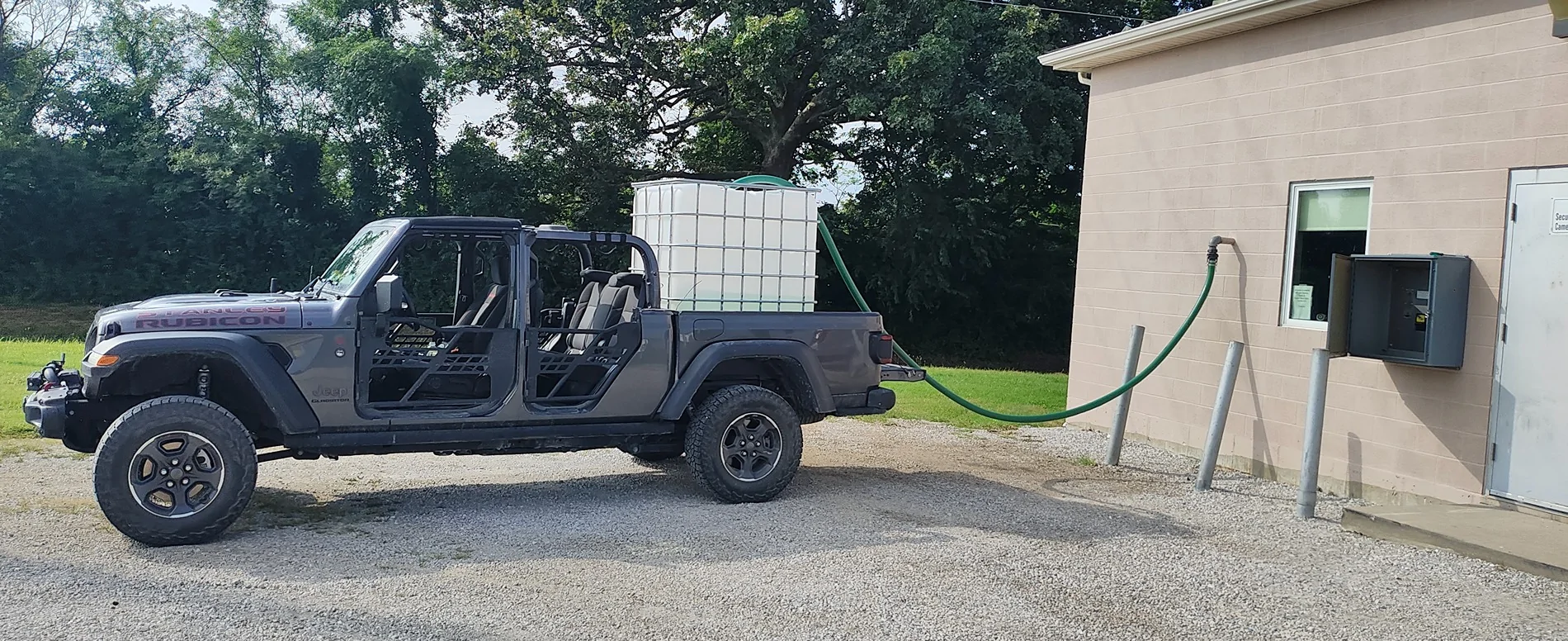

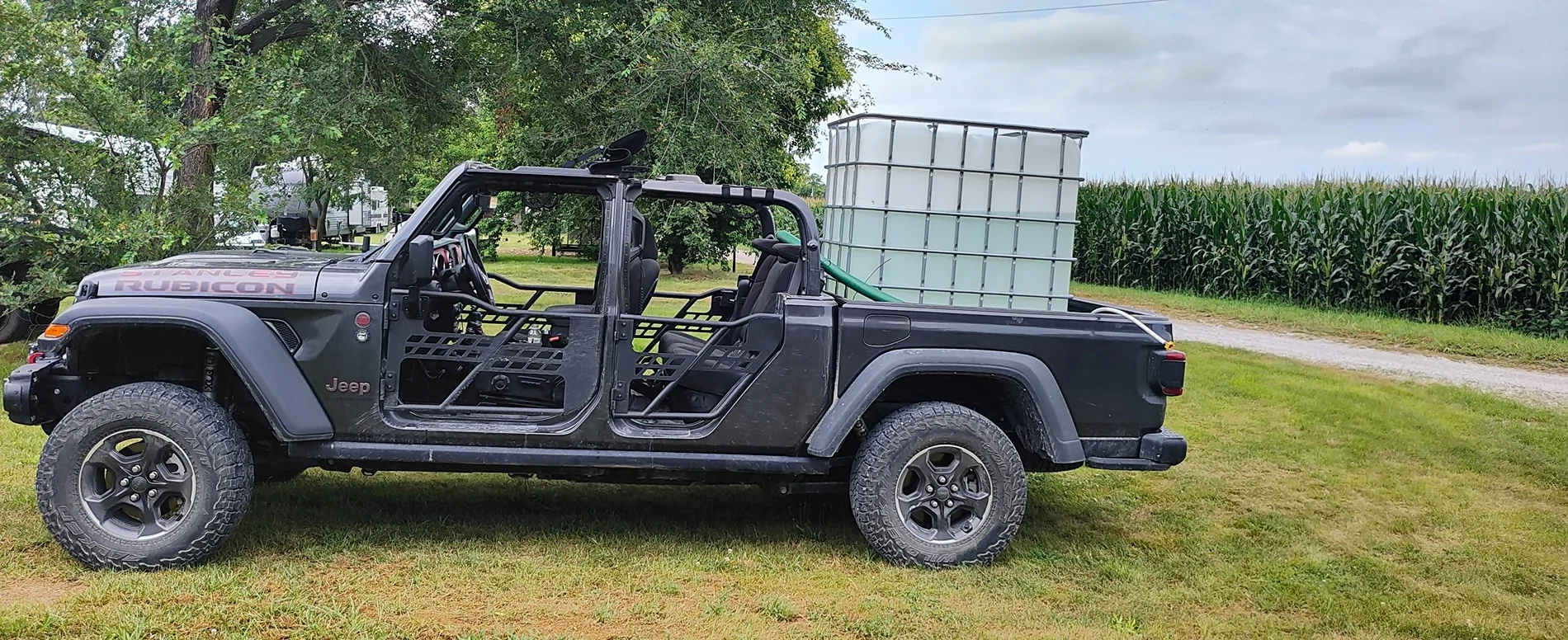

Defiantly ask questions about the spring rates. I did the Mopar 2" on my Rubi with a 1" spacer in front to ease out the rake. Ended up more like a 3" lift when it was all measured out. The springs that came with the lift were progressive, so sitting higher unloaded it feels kinda squishy compared to the stock Rubi springs. This isn't the best picture because I'm sitting in a low spot but that's about 1500lbs of water in the back. Some other unloaded pics for reference. Doesn't seem to mind the extra weight, '22 JTRD
