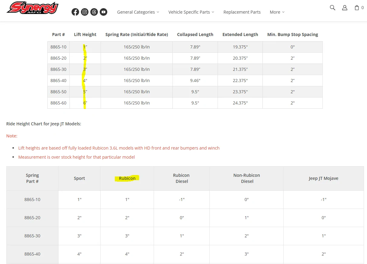

Great question, all of my research is based off Synergy 3" front & rear springs. I believe Synergy incorporates roughly 1.5" of rake into their rear lift springs.
So if the OP wants to maintain a factory ride height with the 750lb constant in the rear, they'd probably need the 1" or maybe the 2" version... that's a question for the Synergy staff though :) I always kept a pair of Daystar 3/4" rear spacers in my parts pile in case I needed to tweak the stance.
Jeep Gladiator Suspension height 750 lbs gear 1758752118497-ch
