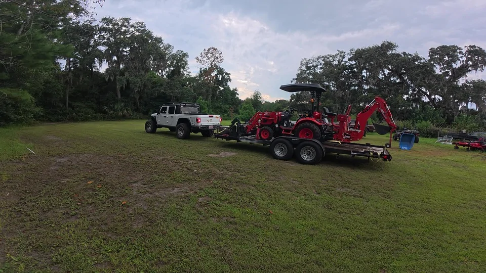

I know you have an aversion to air bags, but they do offer a lot of versatility. Tunable pressure to load is the primary. I run a roof top tent and rack with supplies nearly year around and have found my sweet spot for pressure setting. Occasionally pull a trailer with large mower or small tractor and I can adjust the pressure accordingly. I chose a reputable air bag manufacturer and have had zero issues over 20K miles so far. The timbren/sumo spring offerings to me are a glorified bump stop. Semi's run air bags millions of miles because they work. You could also get in touch with Dobinson Suspensions and see what they offer in a heavier rate spring. They are a very reputable brand .
I've been using airlift airbags on this Jeep for over 4yrs and about 130k miles. They've been working out great. I had the Ram 1500 HD springs because of my lift. The HD springs (black) are a little stiffer than the regular (red) ones. However I did just recently switch over to airlift airsprings. No particular reason. Just to try something new. Lol

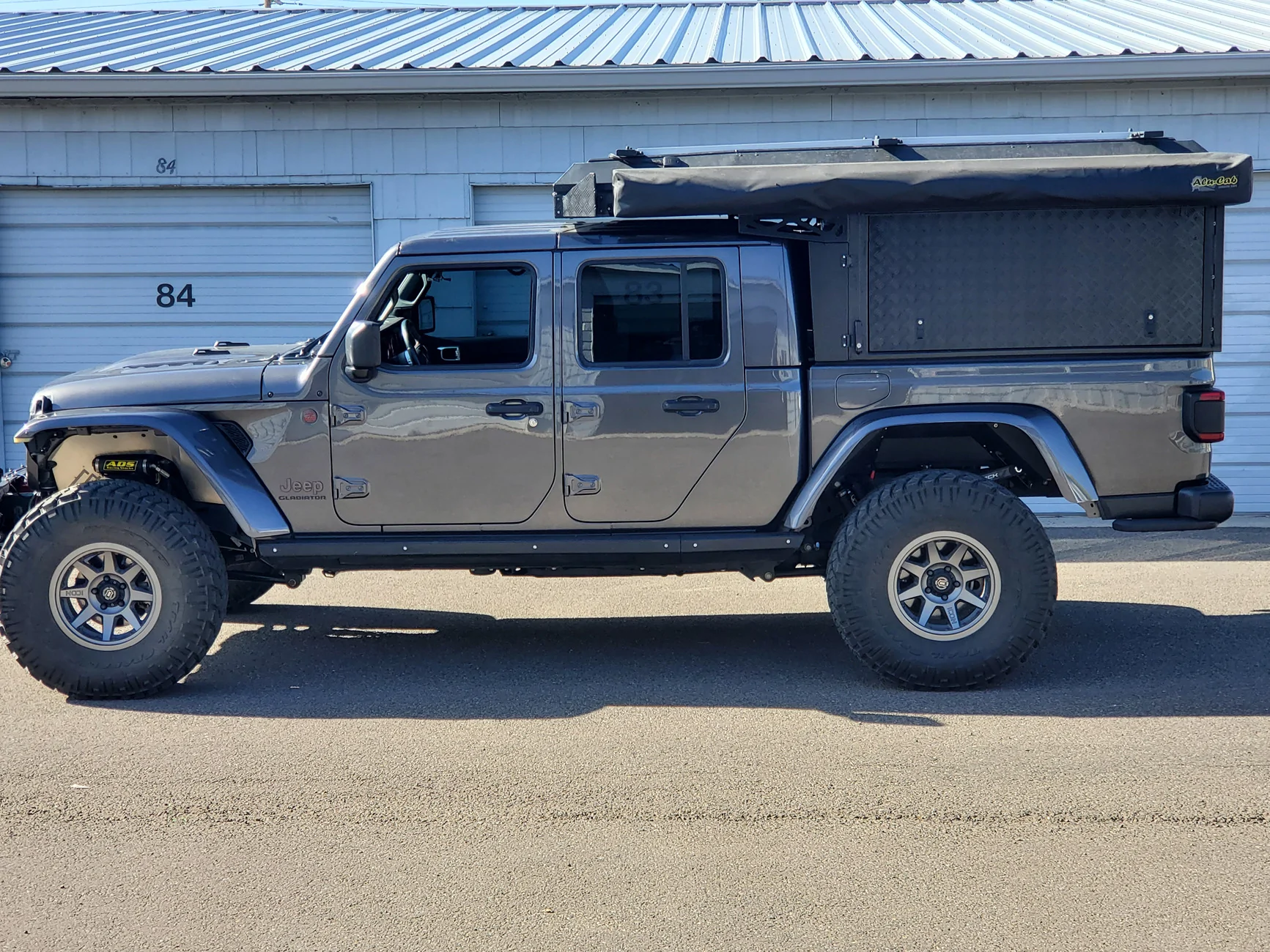

Mines a Rubicon Diesel. 5" Synergy gas springs in the front 3.5" HD Claytons in the rear. Did a custom mounted anti rock in the rear. On 38's. This is carrying approx 1000 lbs in the rear on a CAT scale. Front was 30 lbs lighter than stock. Sets with a 1* slope to the front with a full tank. . Rides fantastic with ADS 3 tube bypasses setup by Liberty Mountain Fab.
