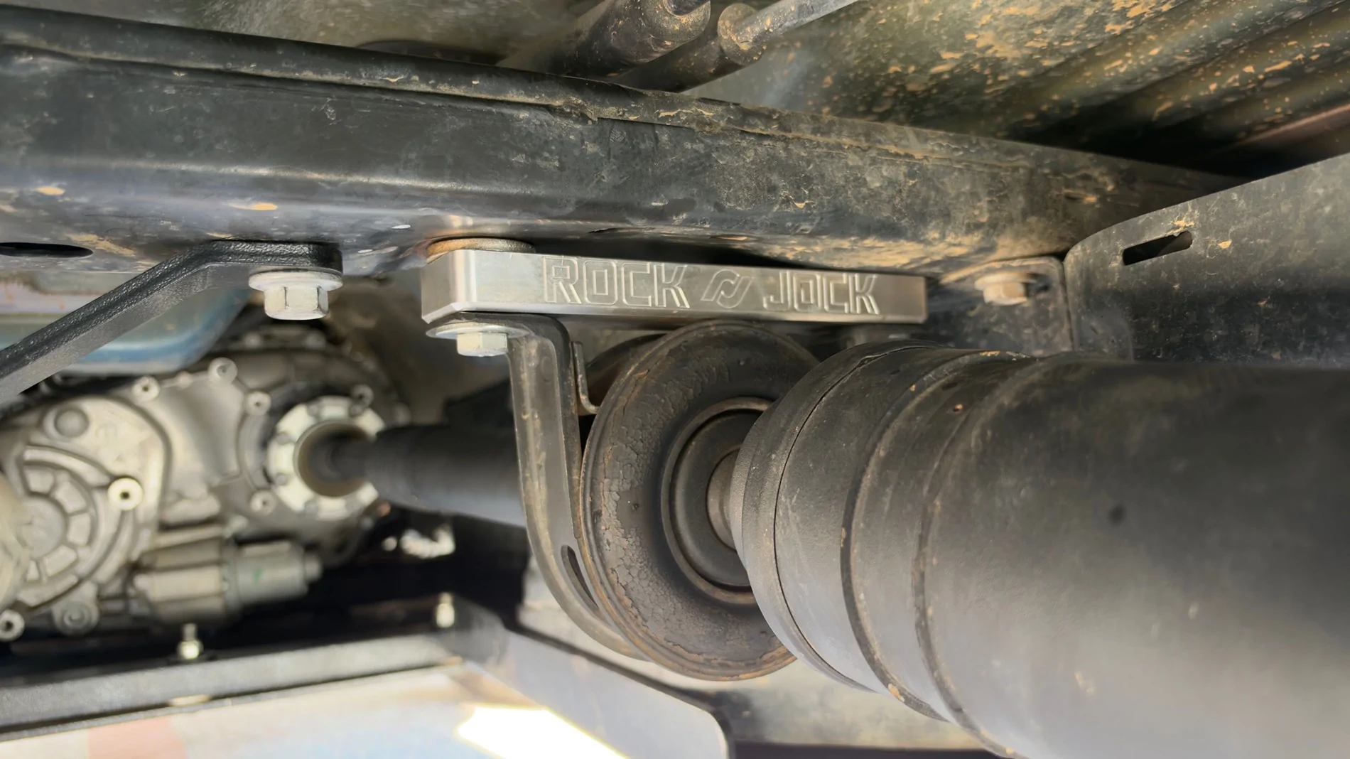

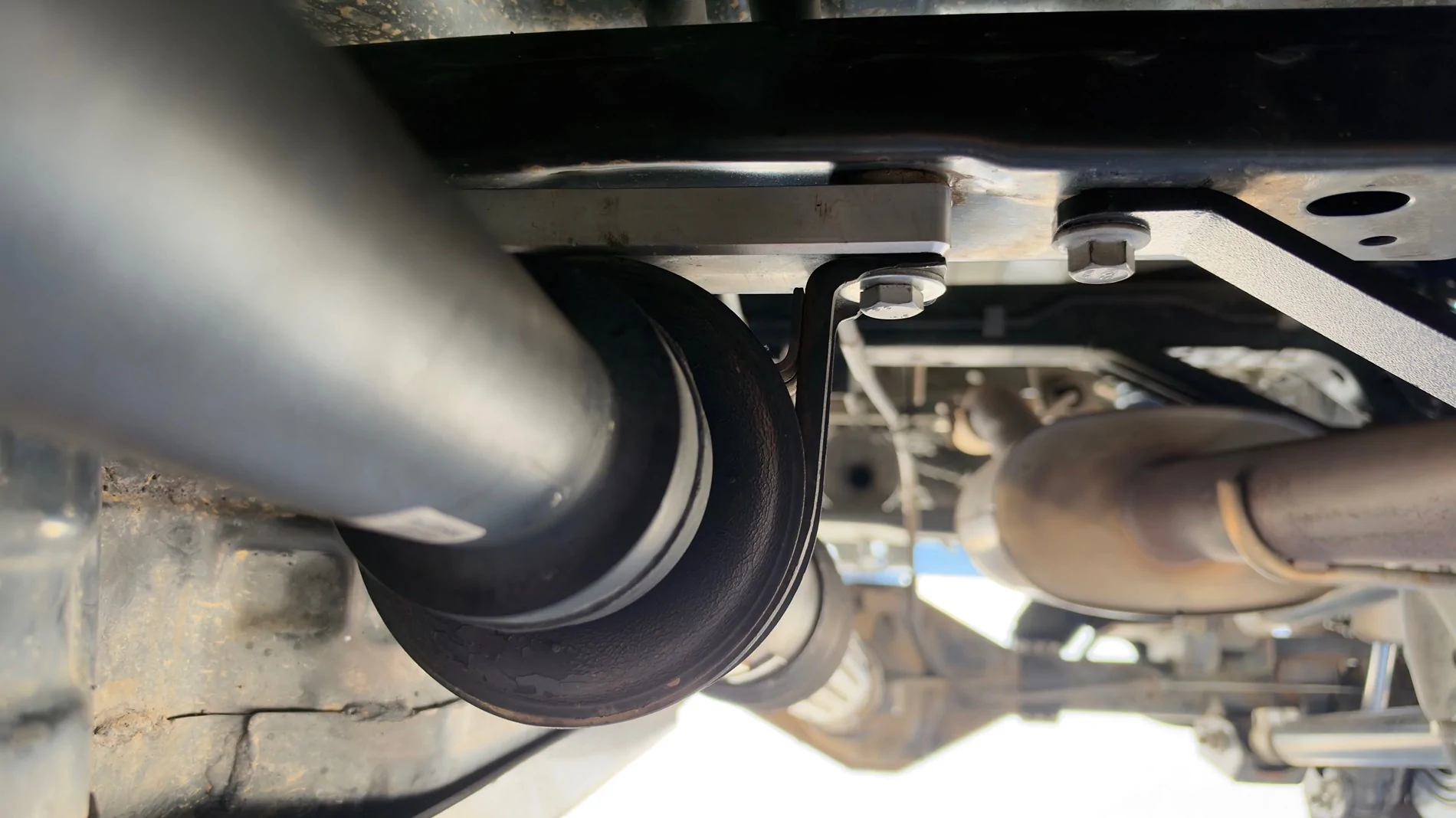

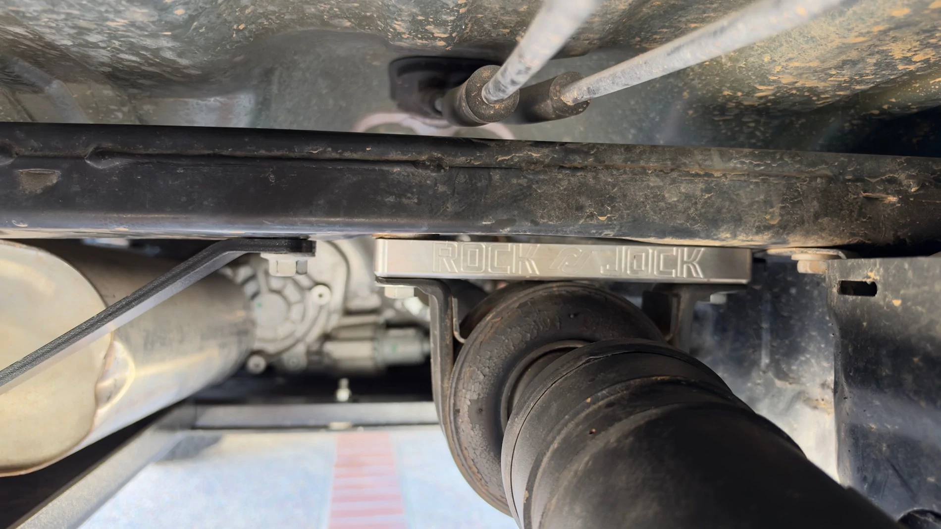

Anyways, here’s some pics on how I corrected for my bent crossmember.
Jeep Gladiator FAD Missing IMG_0148
Jeep Gladiator FAD Missing IMG_0149
Jeep Gladiator FAD Missing IMG_0150

Had the same thought/question. I was convinced some of these HD trucks had single pieces that were definitely longer/thicker than ours.
That definitely should do the trick.
Nicely done
