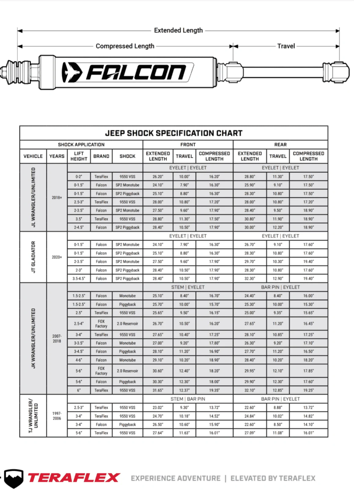

Email them. They quickly sent them to me a couple of months ago. Here is what I received back on their 2-3” lift shocks:
Front Extended 27.47”, Collapsed 17.9”
Rear Extended 28.47”, Collapsed 18.7”
PM me if you want a direct email for someone there. I still have the email from them...

You read my mind :)
Posting the shock specs for all members sent directly to me from teraflex
Jeep Gladiator Falcon shocks D1290450-1A72-4A53-A6A4-6B5A3A8B986A
