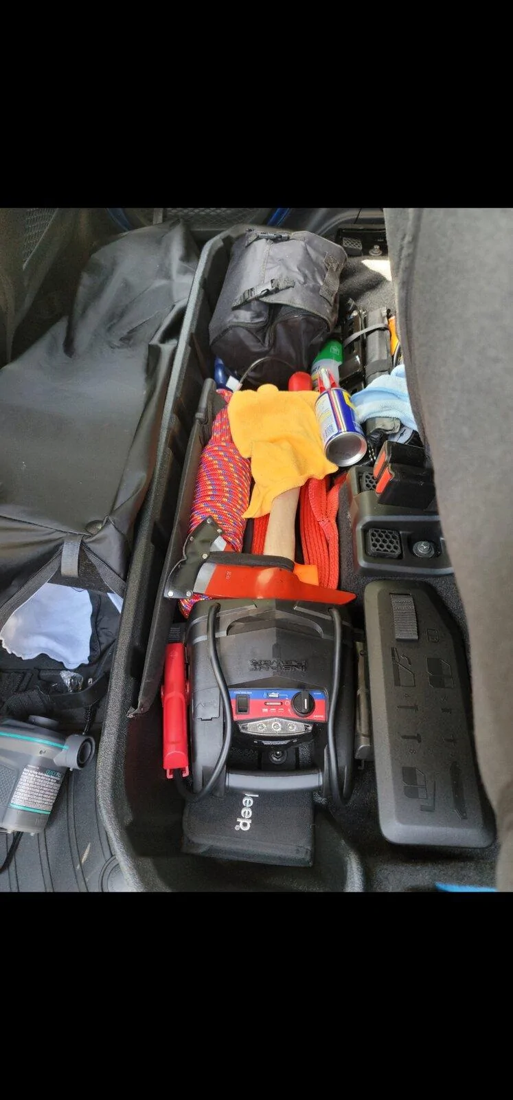

I have a regular basic fire extinguisher in mine and as for what else I carry this is what's under my seat. The only thing missing is emergency blanket, first aid kit, and the extinguisher itself. Compressor is towards the top.

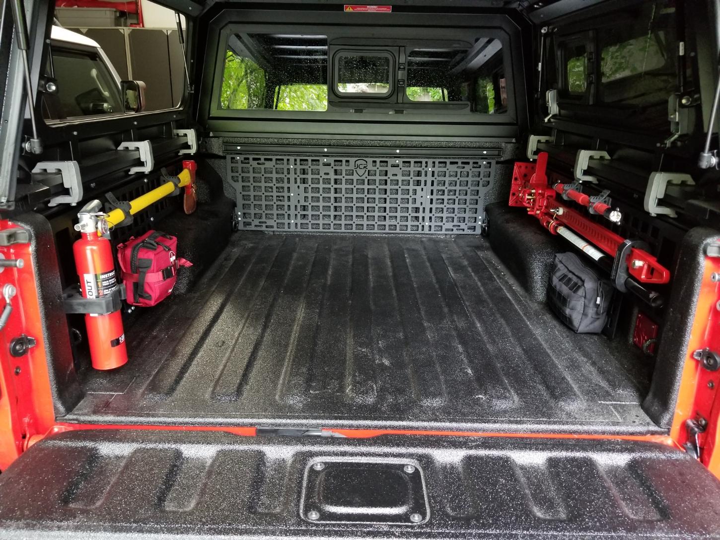

H3R Fire Extinguisher and Survivewear first aid kit in the bed.
The first aid kit is has a velcro back that attaches to the molle panel but tears away so that it can be easily removed. It was geting banged around a little bit in the bed so since this picture was taken I've moved it to the molle panel on the back of the driver's seat.

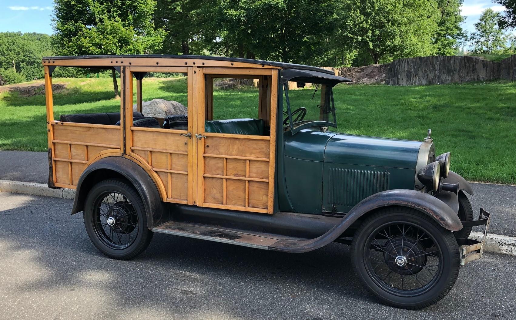

On October 8 , 2020, my all original '29 Woody caught fire. The fire was electrical in nature caused by shorting wires due to failing insulation. It started behind the dash panel which is mounted to the cowl. I should note that the opposite side of the cowl houses the 92 year old 10 gallon fuel tank.
I pulled my Element fire extinguisher (E50) out of my Gladiator and snuffed it out. (I actually used total two as I wanted to be sure it was out.)
It just so happened that a town fire truck (followed by the local fire chief) was driving past (I have no idea why, it was on a side street. I guess they were cutting through.) when it started billowing smoke. They were literally 50 feet from the Woody when it was burning. I had the Element out and activated before they got out of their trucks. They were clueless as to what the Element was, but appeared impressed on how it worked.
The Woody survived with only minor damage (I completed a full replacement wiring harness last winter) and no fire extinguisher residue damage. Hopefully, it will survive for another 92 years.
I know some question the Elements, but it worked fine for me in this situation. Being mounted on the driver's seat rail made for easy access. And, I didn't even have to use the Safecraft Halon from the a different vehicle I had outside.
Will it work in every situation? I do not know. It has its pluses and minuses. I do not know how it would work on a fully engulfed car fire but I don't know how any hand held extinguisher would do for that. I mostly purchased them to save a vehicle on a small fire if I can contain it. It my cars burn out of control, I'll just put in an insurance claim.
I do like that you can activate it and place it adjacent to the fire while you a.) get another fire extinguisher b.) call for help c.) assist an injured person away from the fire. There is no need to hold it while it discharges. (It may have worked great on that air cleaner fire where you just place it in the air cleaner intake and walk away?) It also has a long discharge time and is non-toxic. I also like that there is no mess to clean up and that it does not hurt electronics (note that the very tip does "spit" as its ignites).
Photo of surviving '29 as a bonus:
