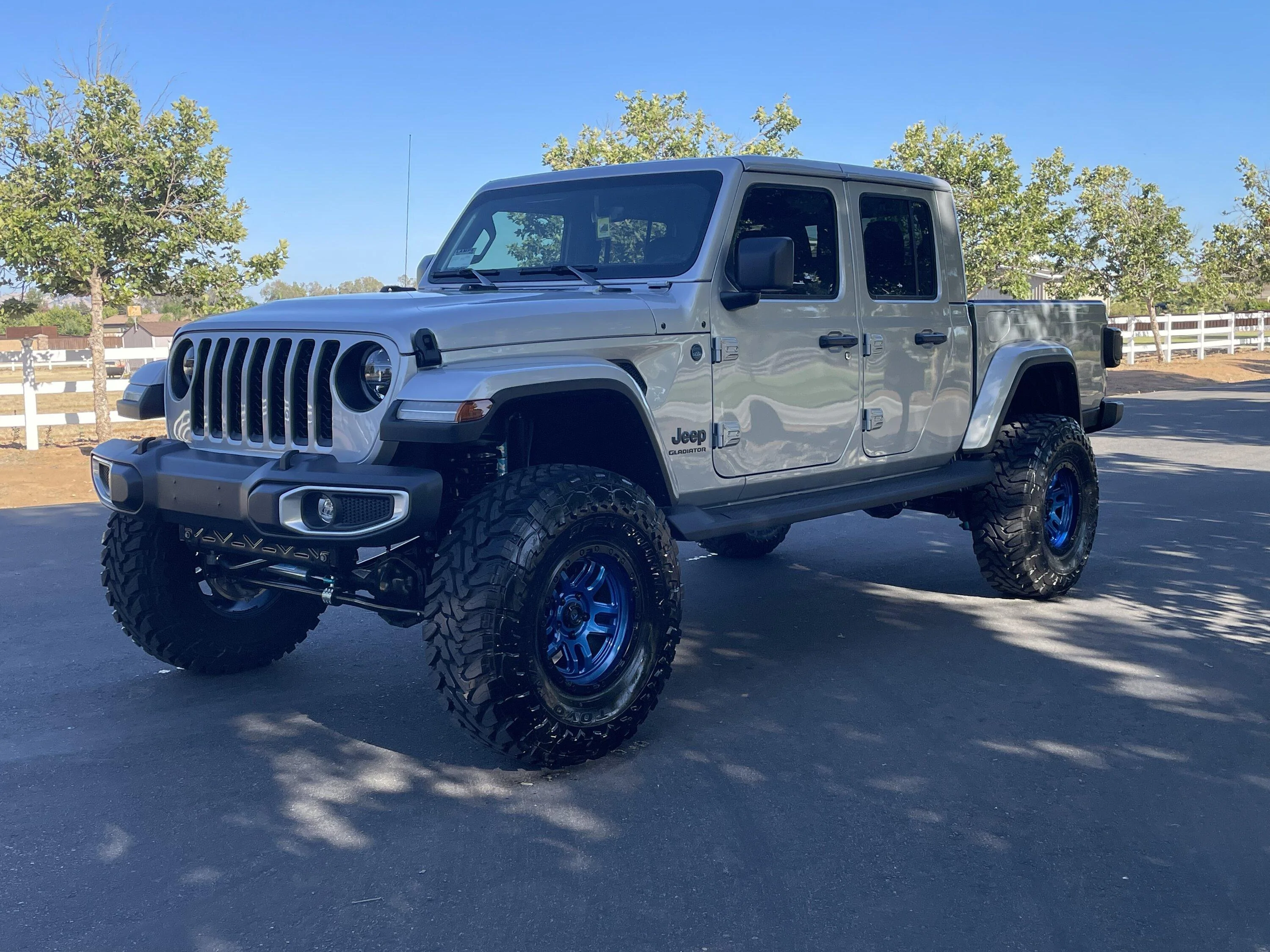

I am a new Jeep owner but not new to Jeeps; I learned to drive on my Dad's WW2 jeep and have driven the M-151 MUTT in Vietnam and Germany.
After reading several articles and watching YouTube videos, it has come to my attention that most of the fires seem to start on the vehicle's passenger side in or around the battery and power distribution box. It also looks like that Jeep JL and JT are the most often involved.
I came up with the idea that may help prevent the complete meltdown of our favorite toys.
The red arrows point to Flamebuster Portable Automatic Fire Ball Extinguisher, and the white points to the FireSlayer Automotive Tube Extinguisher Automatic Fire Suppression.
The brackets are made from 1x1/8 inch aluminum from Lowes bent and drilled to hold the included brackets for the Fire Ball.
As some people have stated, the 2022 Jeep JL and JT's did not come with an Engine-Cover. I found a used one in the local scrap yard and purchased it for a song "and fifty bucks," as I don't sing so good.
The whole mess cost me around two hundred eighty-five dollars, give or take a couple of bucks. I thought that was little enough to protect my new “I paid too damn much JT toy”. All materials are available online at Amazon or Walmart and various RV and truck supply stores.
P.S. Did you know that the U.S. Army's Jeep Mutt will do "H" mph while traveling downhill on Germany's Autobahns with a good tailwind? They will, and it’s scary as hell.
They should make that a standard feature. They will probably void your warranty now! Lol!
