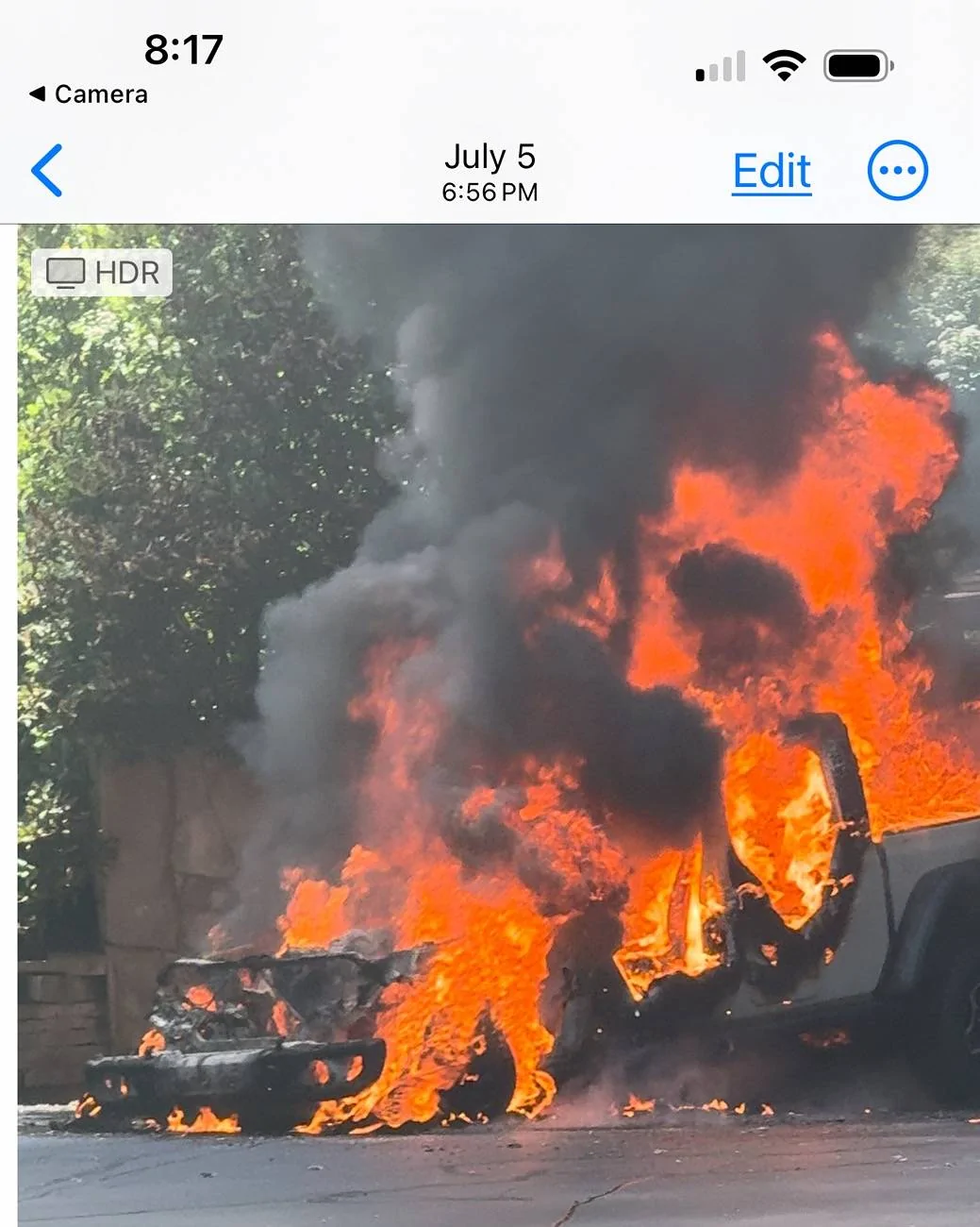

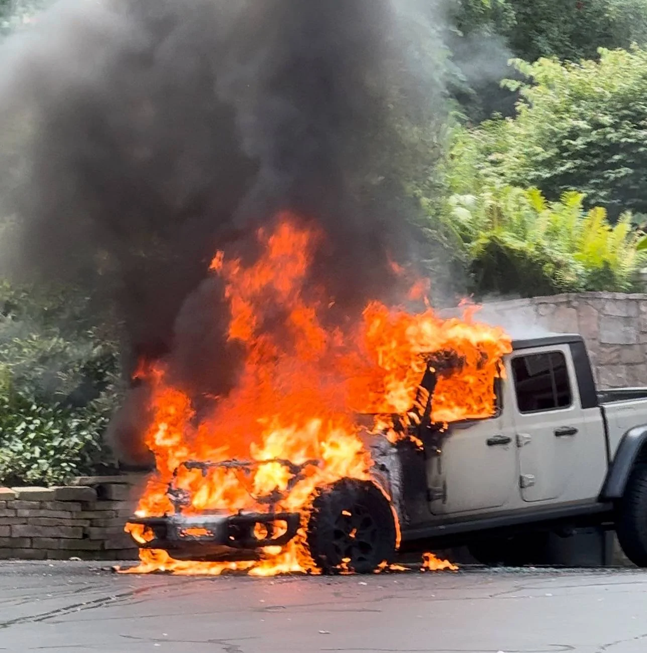

The same happened to us on July 5th 2024. We had a ā€˜ā€™22 gladiator rubicon with 18,000 miles parked in our driveway for less than 24 hours (engine off). Jeep claimed no responsibility and wouldn’t speak with us. They knew! They had 9 other spontaneous fires that they wouldn’t disclose to us and our insurance company. Now, finally, we are all getting answers as to why this is happening. Jeep needs to be held accountable!
Jeep Gladiator My 2022 Gladiator burned down... how? IMG_3192
Jeep Gladiator My 2022 Gladiator burned down... how? IMG_3191

I understand what you’re saying in regards to them admitting there’s an issue, however, they denied this to our insurance company as well which in the big picture if things, may creates a bigger problem. My Jeep hadn’t been touched as far as any modifications and/or upgrades. We bought it brand new and took amazing care of it. This now makes 10 vehicles that have been reported. That’s a lot as far as I’m concerned! I know there are always exceptions, but for the most part, it’s pretty uncommon for a vehicle to spontaneously combust while just sitting there.

I’m sorry to hear that happened! Fires are pretty scary and devastating no matter what the cause, however, in this case, my Jeep was just sitting there for a little less than a day. Nothing we did or didn’t do started that fire! And please don’t say it could have been a rodent! I’m really not sure why some people are skeptical or even in denial, if anything they should be really concerned! There’s a recall for the manual transmission jeeps where the clutch plate overheats and can cause a fire. I’m really not sure why this should be treated any differently! One unexplained fire is one too many!
