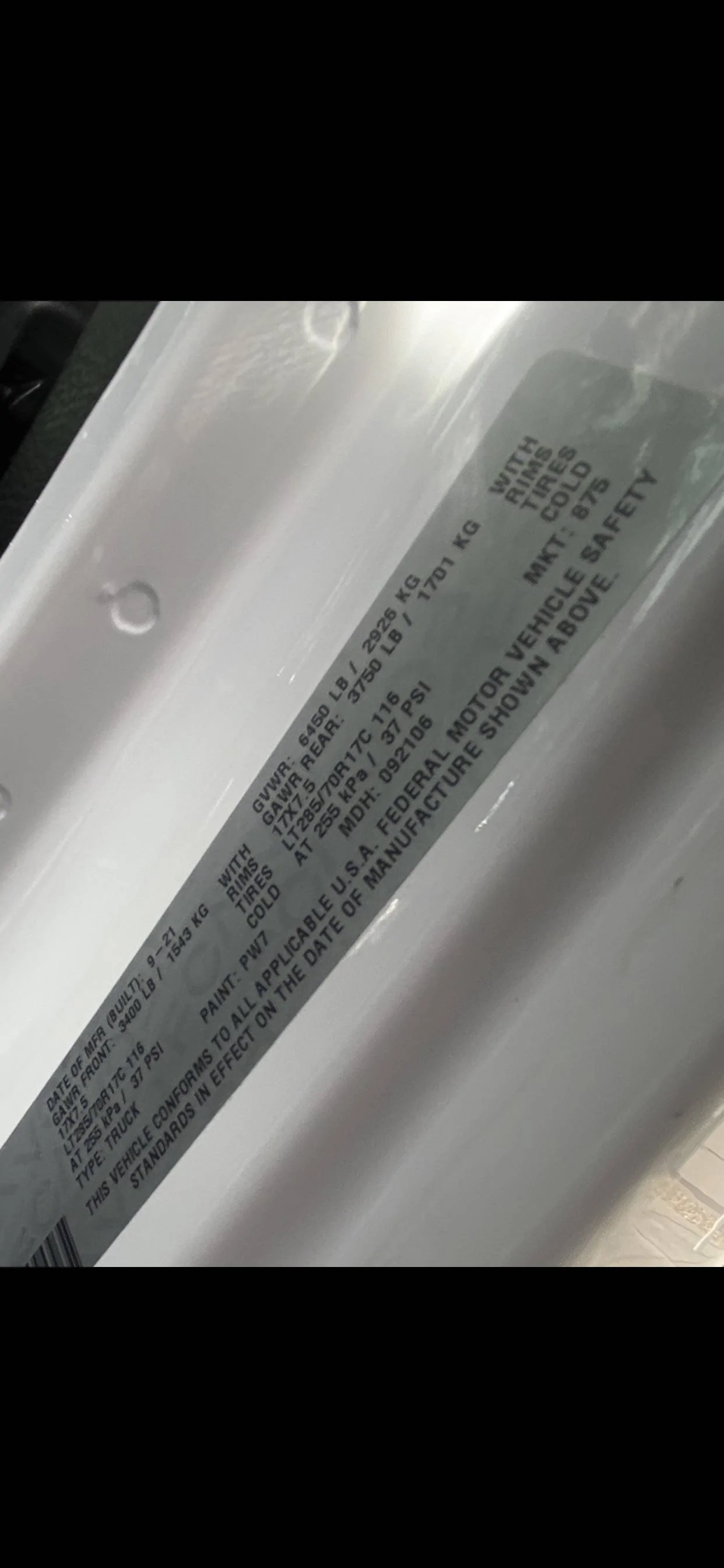

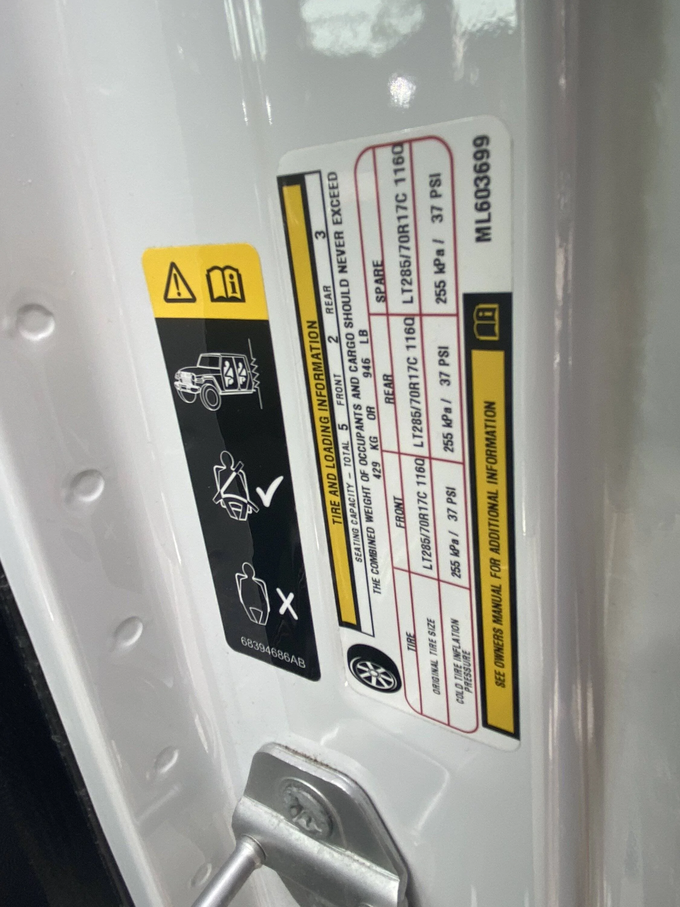

My GVRW is 6,459#
Max payload is <946#>
Curb weight off the transport = 5,513#
