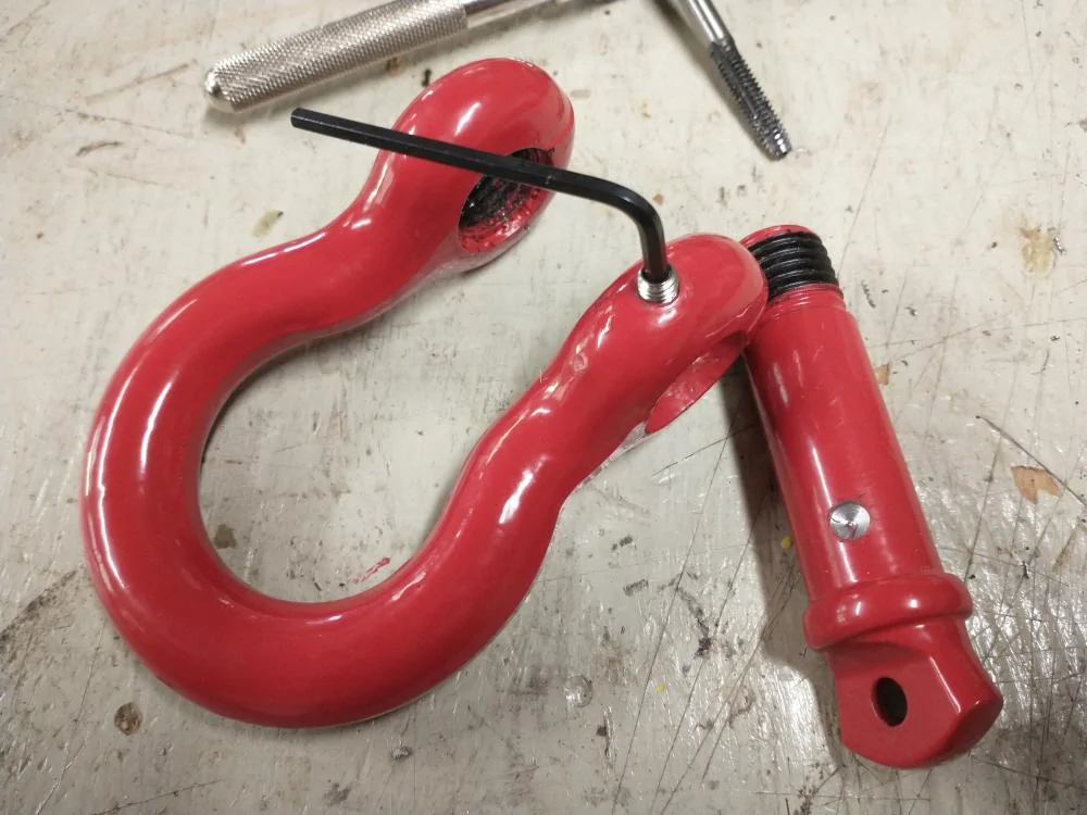

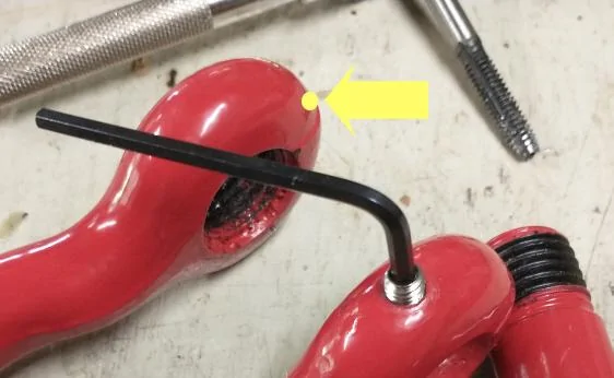

Not sure if this has been suggested as I did not read all 8 pages but I installed 1/4x20 by 1/2 inch stainless set screws in mine to keep them from either walking off or vibrating off. Once installed I put 'China' stickers over the set screws to keep them clean and hide them further (they are on the back side of the shackle to begin with)
Awesome idea, but just curious if it weakens the integrity of the shackle?
Possible. Probably less as they are drilled in the Y-axis. As these are 4.5-ton shackles, they have a 9000 lb WLL (Working Load Limit), but have a 'safety factor' of 4.5, so 40,500 lbs to failure. With that margin I feel comfortable. I'd be more concerned with my aftermarket bumper being mounted with their bolts in tension than these shackles in shear. Disclaimer - I am certainly NOT a mechanical engineer.
Update - I ran this by a mechanical engineer friend and he pointed out that the end of the shackle would have the least effect on the WLL.
Jeep Gladiator First theft .. Crosby shackles shacklelock2
And of course the smaller the set screw you use, the less effect on WLL. I chose 1/4 inch over 1/8 or 1/16 set screws which would have served the same function from the practical point of I was much less likely to bust a 1/4 tap over either one of those. You can quote me, "Busted taps su*k".
Awesome. So you center punched, drilled, then tapped?
See any reason why you couldn’t go a little deeper and run some threads into the shaft?
Not really needed to thread into the pin, unless you want to possibly boogger up threads on set screw. A good dimple for the tip of hardened set screw n good, same as a keyway with keystock does.
Correct. And @Blade1668 is spot on, no need to thread into the pin, as that will cause issues.
Blade1668 " Not really needed to thread into the pin, unless you want to possibly boogger up threads on set screw. A good dimple for the tip of hardened set screw n good, same as a keyway with keystock does"

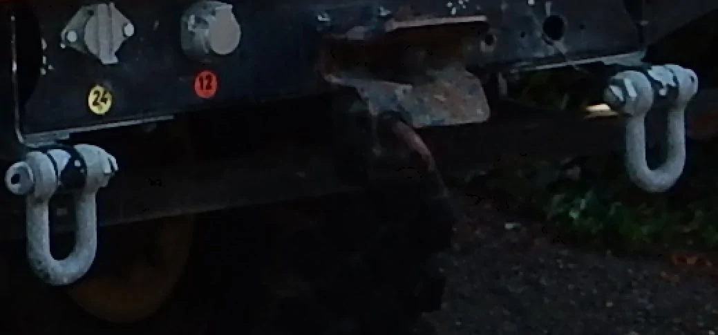

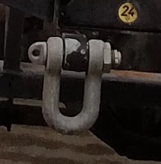

Another option is like my Mercedes 1017AF truck's shackles, is the pins are long enough to put a cotter pin through. Of course, these came from the factory that way and were meant to be on full-time, so the shackle pin was made for that purpose. Most aftermarket pins are not long enough.
