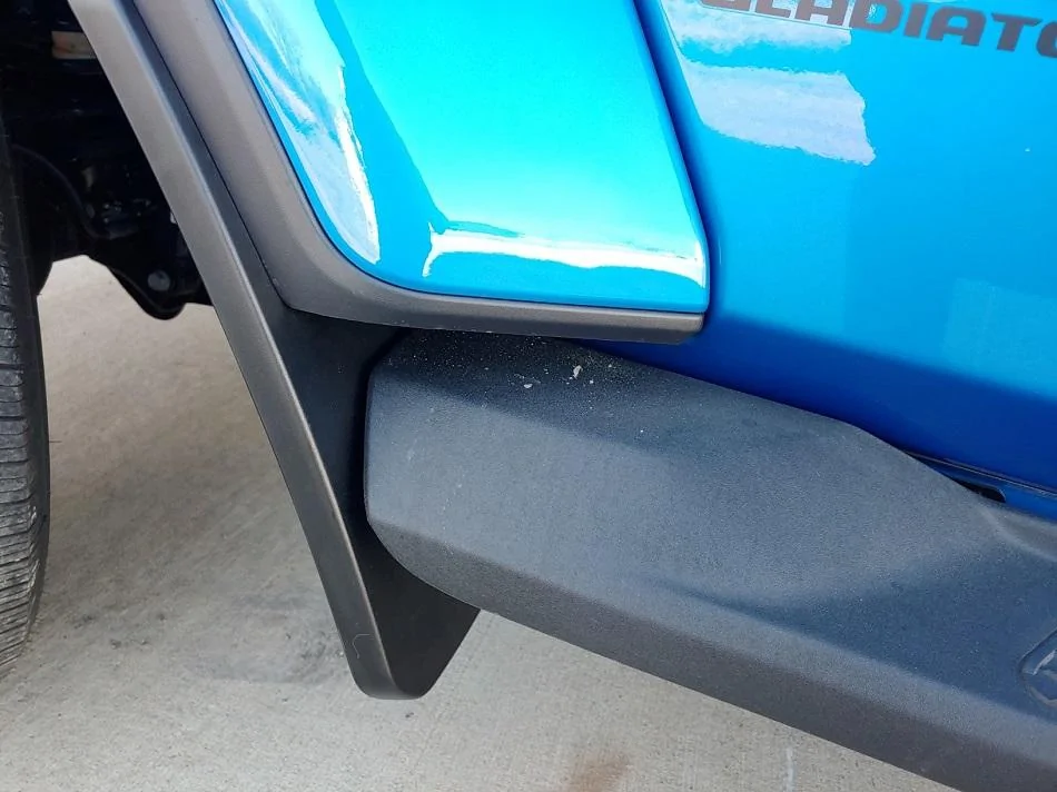

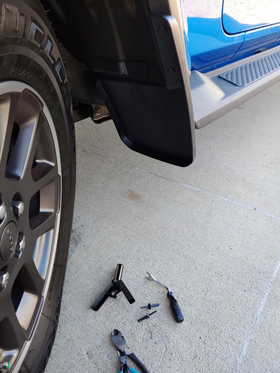

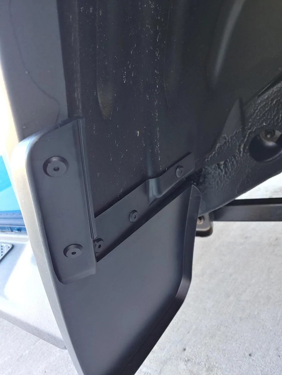

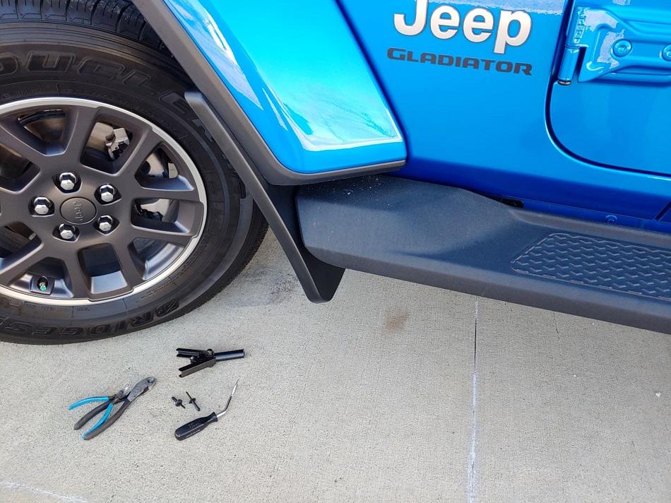

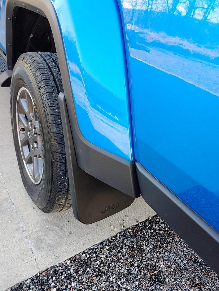

You drill one hole for each in the plastic wheel well liner, otherwise the POM rivets that hold these take the place of the rivets that hold the trim on the fenders. They come with the POM rivets - as long as you have the tool, and a drill, you'll be fine.
These are the MOPAR ones that you get if you go to any Jeep dealer and ask for JT splash guards. The front, at least for Overland, are standard Wrangler, the rears are specific to the JT
To do the rears you have to remove the wheels to get in and drill the one hole, for the fronts you simply turn the wheels to move them out of your way.

Gonna have to look into this. Think all this salty slush will effect the truck or am I just paranoid?

Not paranoid. I've owned a number of trucks, SUVs and cars, I collect and restore cars........ salt, slush, the sand the spread with the salt around here - I've seen things............if you can prevent stuff from being tossed at the rocker panels, the bottom edges of the rocker panels, and various other areas where it gets up into and you can't easily wash out or where it can plug the drain holes and passages, where it gets between spot welded panels and so on.
Even new vehicles have those spots - in some cases, worse, because of the large amount of vinyl and plastic type trim where stuff gets caught between it and steel or behind the trim parts.
You also help avoid rock chips. You don't need a gravel road for those. I drove a show car from my home to St. Louis a few years ago and got dinged because of rock chips. What rock chips? Yeah, the interstate has rocks and crud, too - there they were, behind the rear wheel where a splash guard would have protected it. Then you have exposed metal and it takes only minutes for rust to start.
